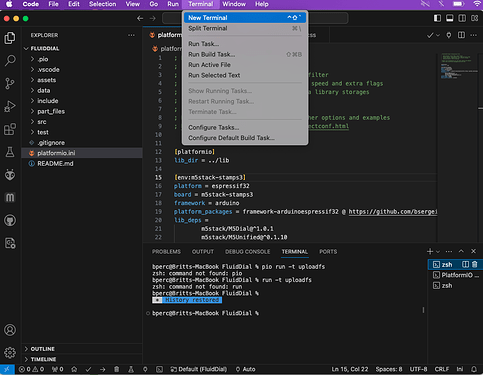

Hello,
I have exactly the same error :frowning:
Can you please explain your solution a bit.
What is the PIO terminal?
Greetings and thanks
Matthias

Hello! Technically, there’s a difference between not having gotten the file system included (so that you don’t have icons), and an “error” which would indicate something not compiling right or not building right.
If you’re saying that you have the same issue he did, which is that he had no icons, it simply means that you need to get the file structure put onto your M5 dial.
PIO is short for PlatformIO, an extension that helps people use Visual Studio Code to build and deploy things. In particular PlatformIO is used when we use VSCode to build and deploy the firmware for the M5 dial for this pendant.
Within the PlatformIO options for this build there’s not only an option to build and upload the firmware, but in the list of options further down, there are options for building the file system and uploading the file system. I use these. I’ve mentioned this carefully in probably more than one place in my documentation/comments in this thread.
There are at least three ways I know of to do the file system upload. One is the shortcuts I just talked about, another one is a shortcut icon/button somewhere else in the interface that I’m not sure about. And finally, it can be done in the project terminal by typing a command. I think that the command line referenced in the post you replied to is the terminal command in focus.

From the M5Dial wiki:
Do one of the following to install the littefs and files, and repeat any time the files change:
  • Option 1: Send pio run -t uploadfs at the PIO terminal
  • Option 2: In VS Code, click on the PlatformIO icon on the left side menu (as you would to “build” and “upload” to the M5Dial), and under the “Platform” section, tap on “Build File System Image” and “Upload File System Image.”
To add a new Terminal and ‘pio run -t uploadfs’ :
Or you can build and upload the file system:

In option 1 he said that he couldn’t find “PIO”.
With option 2 everything worked and the symbols are all displayed correctly (now I have also understood the instructions in the wiki correctly).
