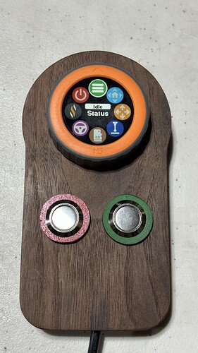

I finally have all my electronic parts. I have the pendant connected to the Jackpot. The M5 dial works but the buttons don’t. My buttons have 4 pins. I connected the wires to the + and - pins. I saw your buttons have 4 pins also. How did you wire your pins?
IMG_8828
So on buttons without LEDs, there are only two pins. For LEDs to be added, two more pins are needed. Two of the pins are for communicating the button’s state (closed or not), and the other two are for powering the LED.
I took my incoming 12V power, and split it three ways. One of those splits went to a button, another to a button, and another to the pendant itself.
Your button shows “-” and “+” on a couple of the pins. That could be the two for the 12V for the LED. If not there’s only one other option!
Plus they can (usually) be wired so the LED is either on all the time or only when pressed. The datasheet for your button should have a wiring diagram but without that just trial and error with a 12v supply and a multimeter.
When pressed there should be one pin which has continuity to ground but no voltage - that’s the one you want going to the dial.

Thanks for the help. I tried connecting 12V to the + pin and the white wire to the other pin. The green and red LED got real bright and went out. I think AliExpress sent me the 5V instead of the 12V buttons. I tried going back to my order to see what voltage it said, but they no longer carry those buttons. I’m going to order the ones Bart linked from Amazon. At least they will be here tomorrow instead of a month later.
Hmm. The photo you sent says 12v on the plastic. But that may not match what’s in it
I see LA128 12A and WYOY. I have no idea what WYOY means.
Ugh. I thought it was 12v. Sorry.
