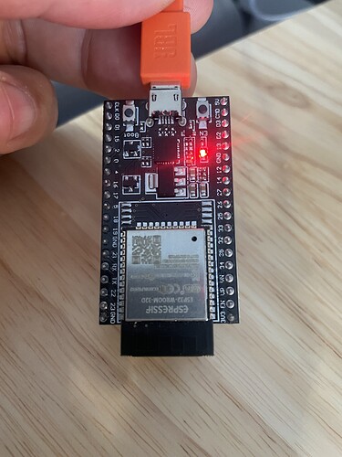

Can you post a picture of your Jackpot and ESP32?
Scanned for wifi with iOS and Mac. Not found on either.
I ran: install-WiFi.sh from the terminal. I don’t know if it wipes before or just overwrites. I used release v3.7.11-posix
Here is the esp hanging out trying to send cnc goodness into the world.
