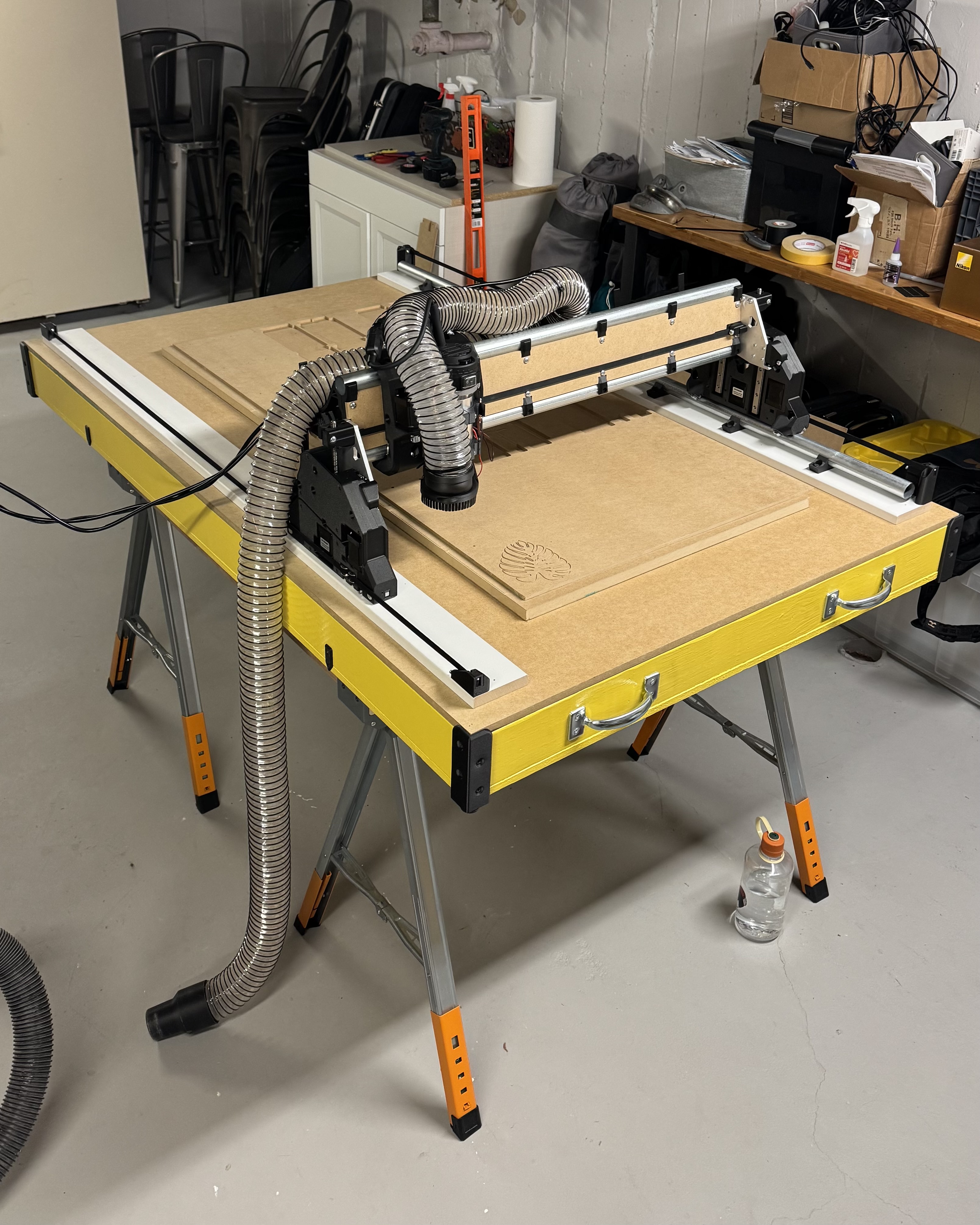

First Time 2’ x 4’ LR4 build w/ PETG-CF

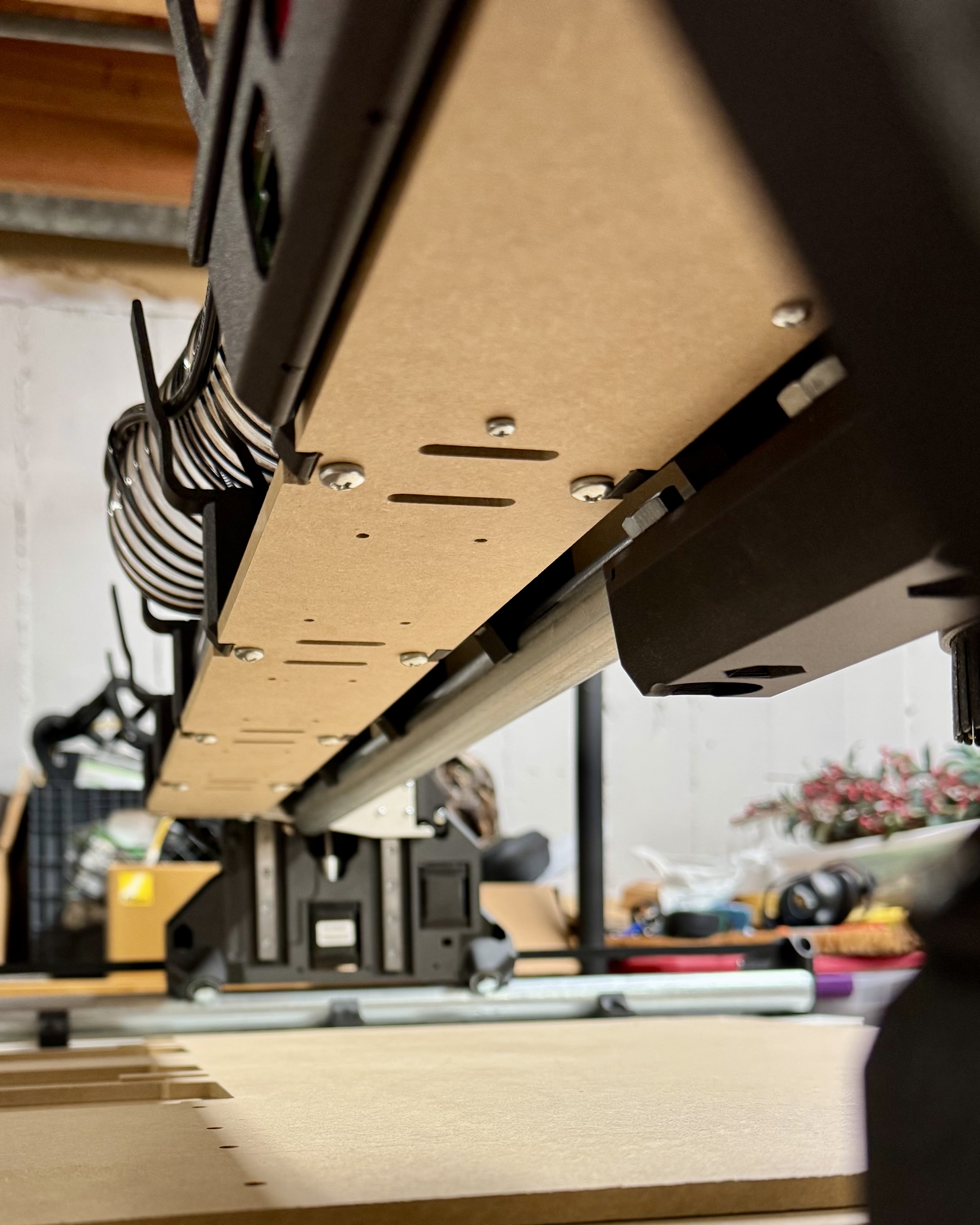

Finally got the strut plates cut and fitted. Added some extra holes for running wires and lights in the future:

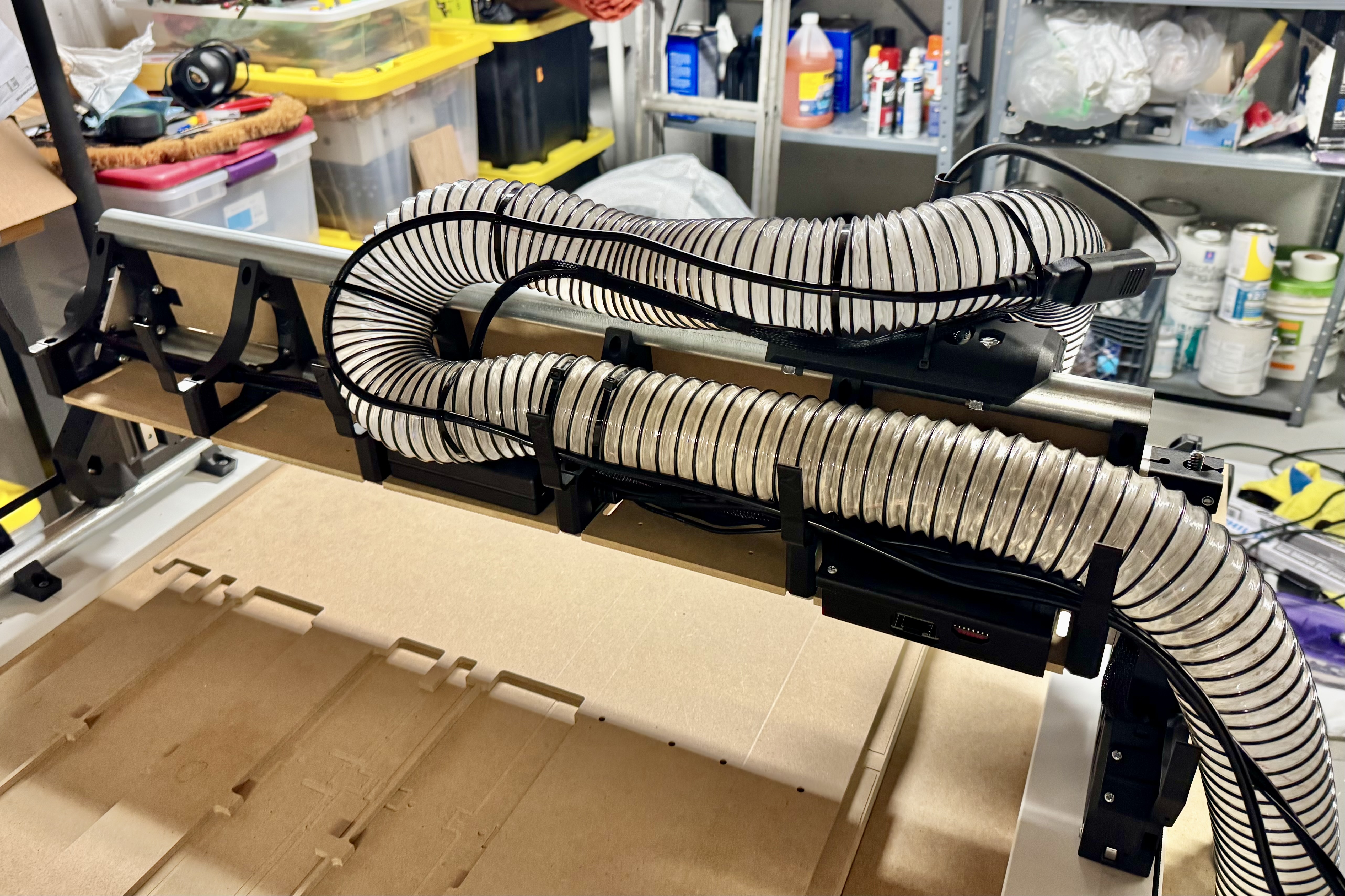

Finished routing the dust collection hose and wires:

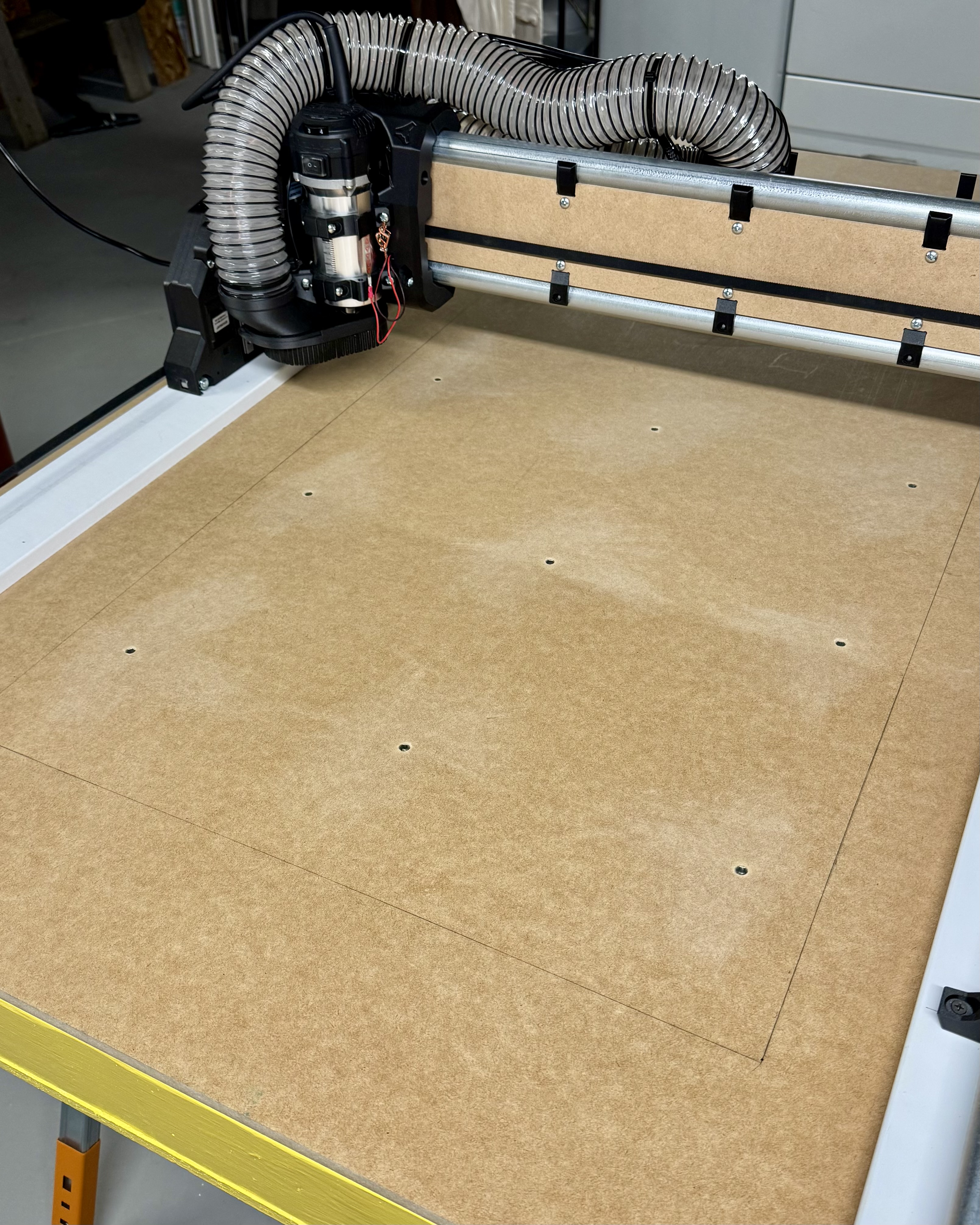

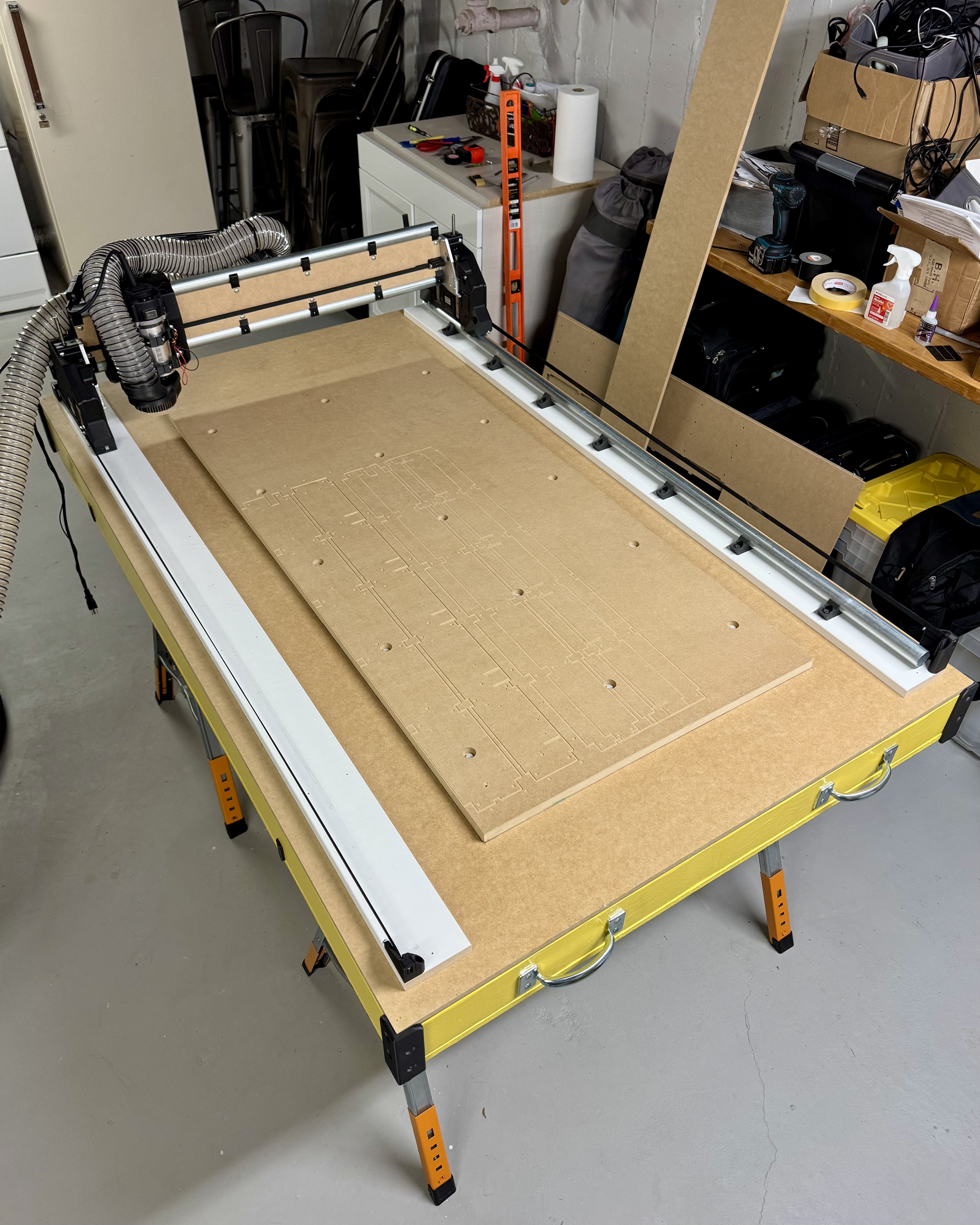

I also used the router to counter bore holes in the spoil board and chucked up a 1/8” drill bit to drill pilot holes for the spoilboard hold down bolts. Added M6 threaded inserts to the tabletop and then used nylon bolts to hold down the spoilboard and make it replaceable when needed:
This is an awesome looking portable build! Bravo!
Congrats on the crown!
