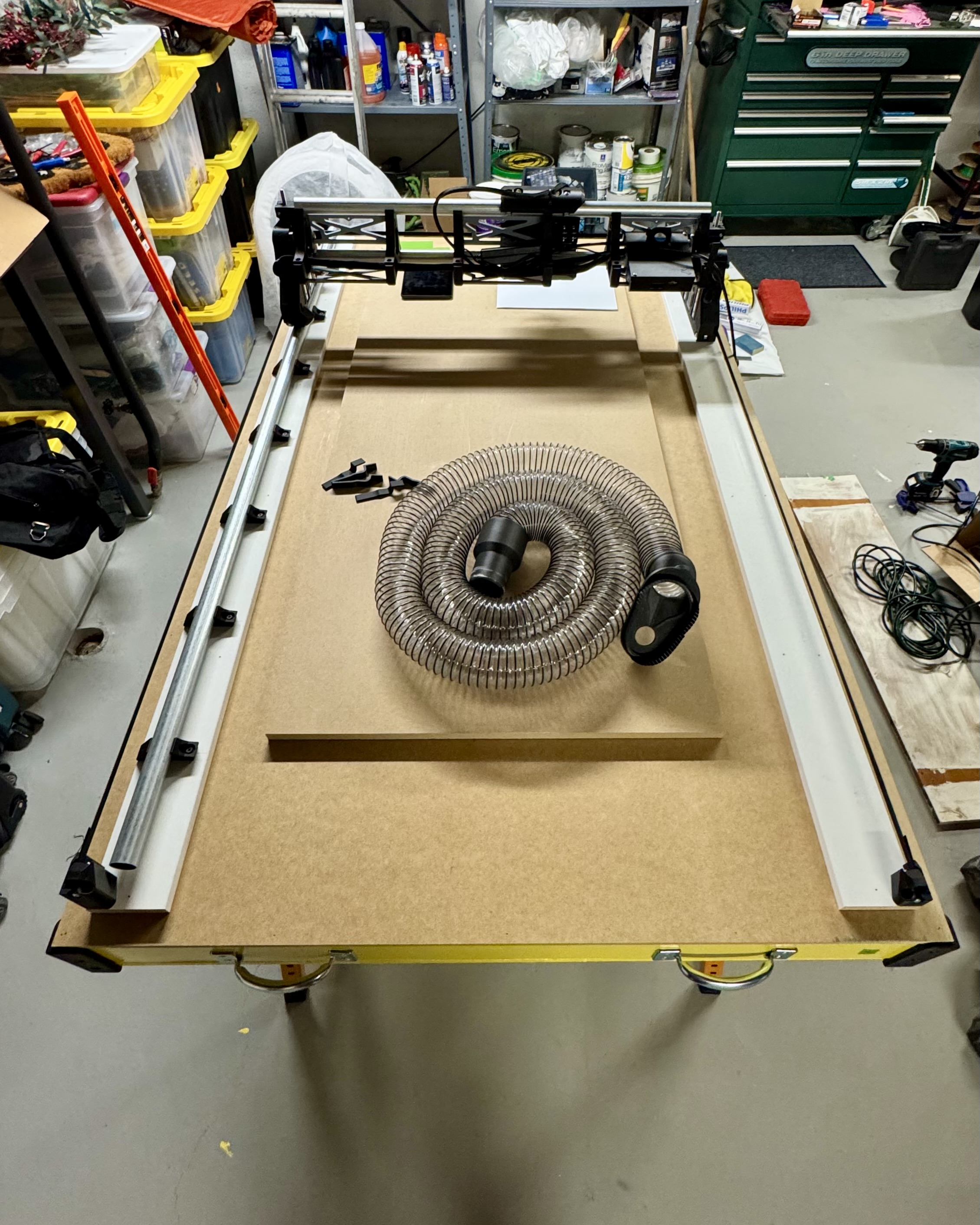

Couple more questions, what size hose is used for the dust collector and how does it attach? Looks like maybe the right size hose is a friction fit?

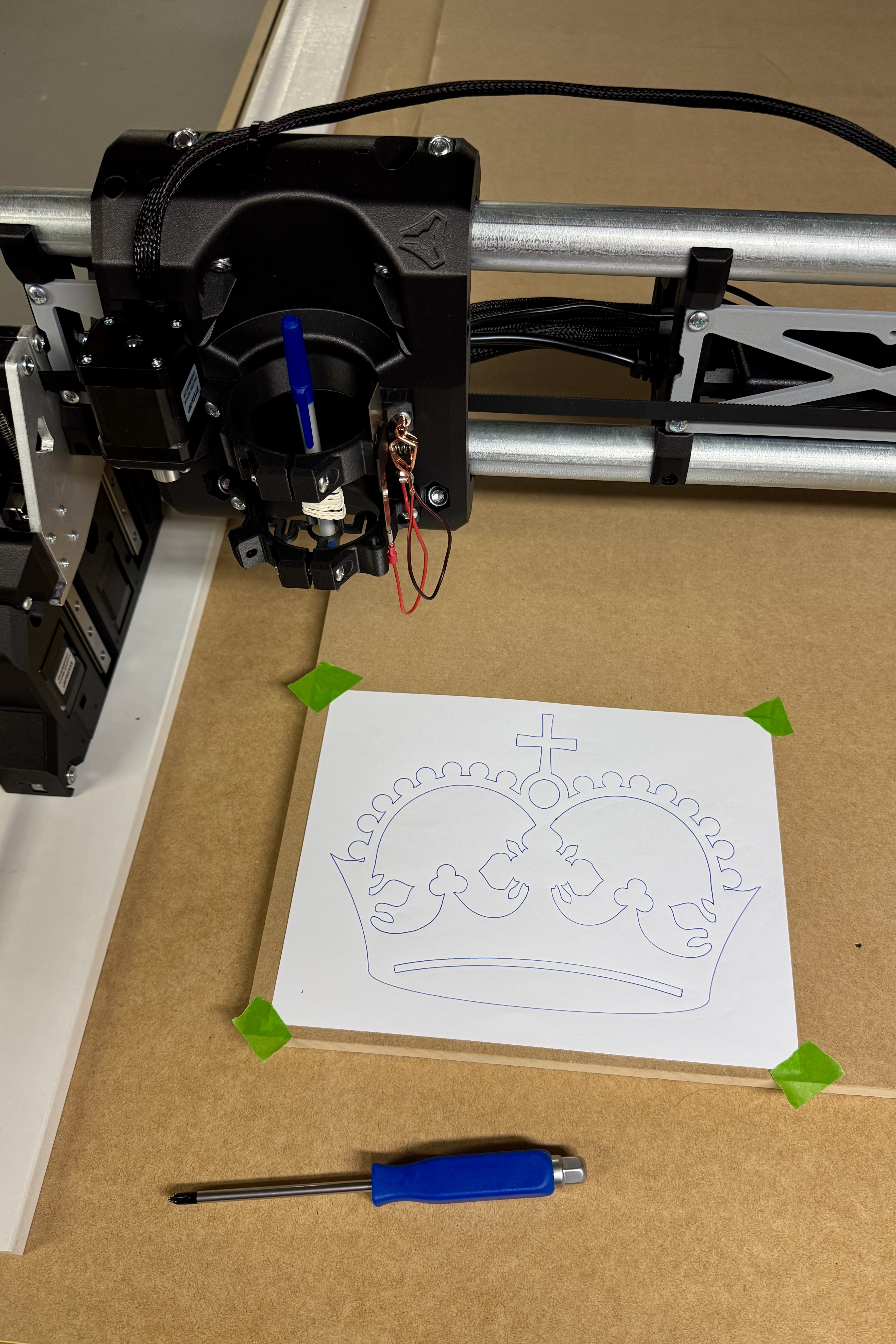

And secondly how does probing work? When I hit probe, will the gantry immediately start lowering until the touch plate is triggered? Does it reset where Z=0 or is it stored as an offset? How would I set this manually by jogging if using something non-conductive like a pen?

We have success! Ready to start cutting the strut plates.
I have a vacuum house on order, what’s the easiest way to ground it? Connect the wire to the router housing maybe?

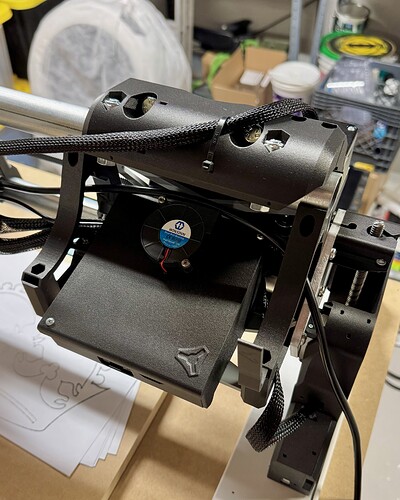

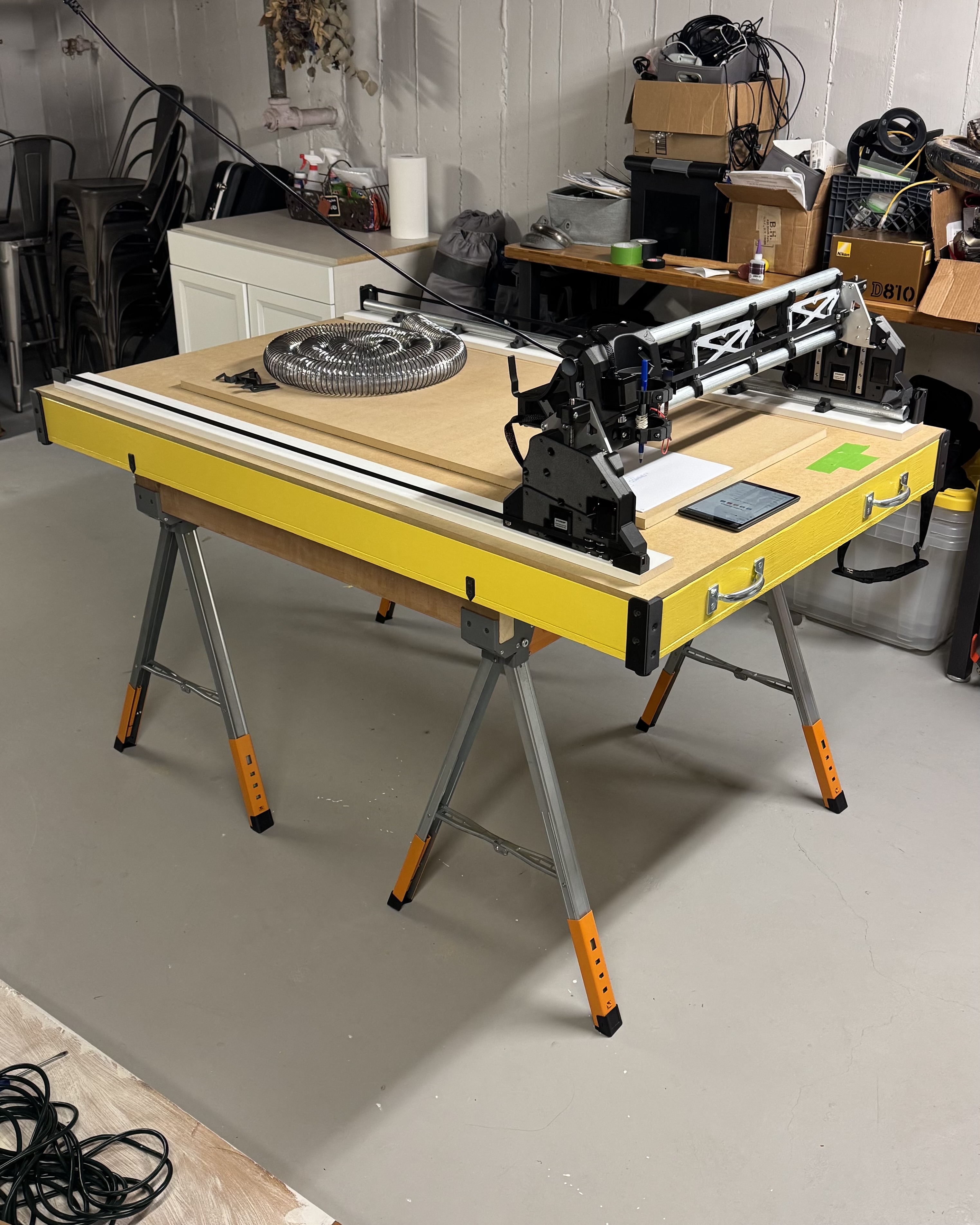

Small update to the build, I swapped the very sketchy mini table that everything rests on for some Bora Workhorse XT’s and it’s much more stable now. I also added little physical markers at the Bessel points of the table to assist with placing the sawhorses. I also wired in the 24v fan for the electronics enclosure. I drilled a small hole for the wire and created a slot from the fan opening to keep the wiring clean and added a connector for it inside the enclosure so I can easily take the lid off without undoing the 24v terminals.
Added my spoil board which is just double sided taped at the moment but will eventually be attached via threaded inserts and nylon bolts. Going to cut my strut plates first before attempting to mill out the counter bores for the spoilboard.
I’m basically all ready to cut, still trying to figure out to ground my dust collection tube to avoid static build up and would love some suggestions on what people are doing. Hopefully more to come soon!

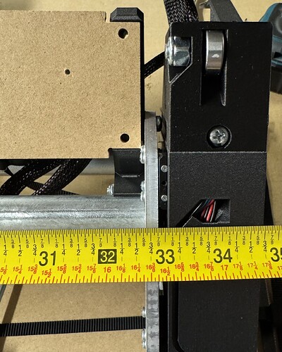

Got everything squared up and cut my strut plates out to find out I had cut my x rails 1-2mm too long which wasn’t allowing everything to line up square. Time to put the temps back on, square everything up, and add an additional 2mm to the strut calculator to try again
I also really need to get a metric measuring tape :sweat_smile:
