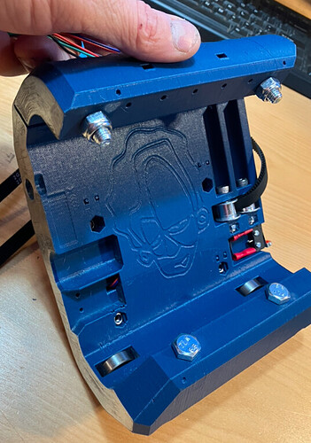

My current LR4 build is where I am using PETG-CF. Here are some pics…
If I ever build another Primo I would use the same PETG-CF that I’m using on this project.
I like the PETG-CF blue, what brand is it? Have you noticed anything in particular with the difference in stiffness, since you’ve used both?

The blue PETG-CF seems stiffer than PLA. I didn’t do any stress/load testing on it, but pulling and pressing on it by hand it seems sturdier and more rigid than PLA.
