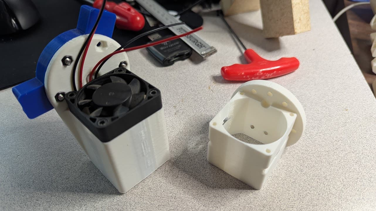

And since USPS decided my zen parts should enjoy a day in LA instead of going out for delivery as planned I decided to fire up Fusion and do a little CAD so I can get my laser mounted up on the new machine.
First try - (on the right) was semi-viable…laser mounted…but I had the holes for the fan off so it wouldn’t mount, and for some reason I thought the magnetic mount piece had nut traps and the screws went in from the laser side. But it also mounted the laser higher than I wanted and was a bit crude. So v2…
Which seems usable. Not perfect…the walls are a bit thinner than I’d like in the middle and I need to add some mounting provision for the control board still. But…there’s no reason I couldn’t wire this up and run it on the machine as is first to see what needs to change.
