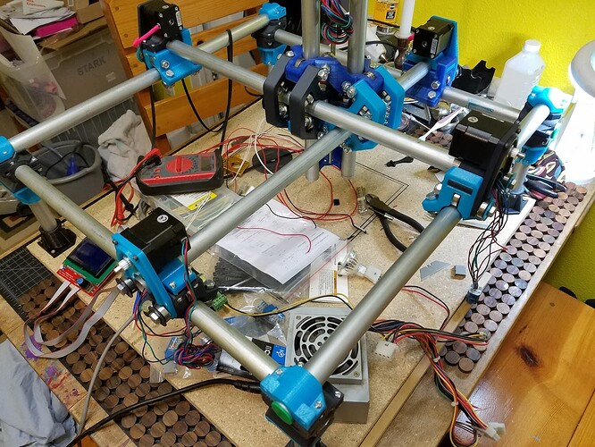

But…I did get usable parts. April 1st 2016 I started rebuilding the 2x2 with PETG parts - sharp eyes may pick out a few more black bits that broke in unexpected ways:
By Apr 30th it was looking like a machine and moved under it’s own power for the first time:
May 1st I had my first successful test - this was before the crown was decided on as a first test and my daughter was obsessed with penguins so:

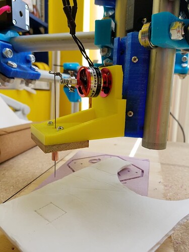

Then I fell down the needle cutter rabbit hole. My first attempt worked but definitely had issues:
But it was enough to convince me the original plan was a good one so I started making room for the 4x4 table:

My main focus continued to be the needle cutter though - and I even won 2nd place in an Instructables contest where I entered my then current design: https://www.instructables.com/CNC-Needle-Cutter/
And continued to refine the needle cutter to the version I stuck with:

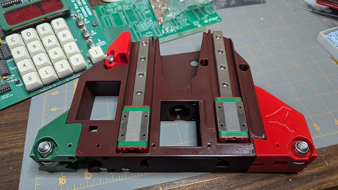

Guess it’s as good a time as any to check my ego a little by sharing todays failure trying to do a 10 year print on my 9 year old machine :rofl:
Thankfully I love sharing failures just as much as successes - that’s how we learn!
So…starting to feel like today is a day that the universe is telling me to step back and work on something else.
Found the old files for the mount and reprinted the parts that broke. They only need to last for this one last 25 minute job…but…there’s no kill like overkill so printed them with 6 perimeters and 60% infill in PETG.
The originals were in PLA and it was a PLA that wasn’t quite as bad as the black my initial MPCNC parts were printed in…but wasn’t too far away. It was from a manufacturer who’s no longer around because they got such a bad reputation. It was their impact modified PLA that I got in their filament of the month program. And Other than the table feet were the only parts on the machine still in PLA.
After the new parts finished printing I went back over to the old shop and brought the tools I’d need to swap them out. Started to do so and…
Well crud. I kind of knew I should have printed that part as well just in case.
I hadn’t even tightened it up yet…didn’t even realize the nut had made contact. But I guess 9 years of vibrations, heat cycles, and the occasional machine crash finally took their toll :frowning:
So…back at the new house and waiting on a substantially longer print - which may or may not even succeed since I’m a little wary of how much is left on that spool. My other spool of PETG doesn’t have much more left on it though so doesn’t make sense to swap. I could print it in PLA…but it won’t print any quicker and while it may be a little stiffer it would still be mounted to a PETG mount on the machine itself so it’s not like it would make that big of a difference. And with the potential heat of the tool I’d rather go with PETG anyway.
But…with the same 6 perimeters and 60% infill I’m looking at 6 hours on my Mk3S and it’s already 3:30 so the chances of me giving this another go today are slim to none.
Hopefully tomorrow I’ll have better luck. Think I’ll go play in fusion and keep experimenting with ideas for the combined workbench/CNC table I was hoping to start this afternoon but don’t feel quite as rushed about now :rofl:
Ugh…3 tries to get here…but I’ve got strut plates…well…one of them at least:
The bottom one I need to finish cutting manually.

Oh yeah…so focused on the workbench I almost forgot a few other bits and pieces came in the other day. Specifically my power supply, more endstops, and some linear rails.
Quick test fit on two of the linear rails and suddenly my color “choices” don’t look as out of place :rofl:
At least I kept things symmetrical. Both front wheels are green, and both back wheels are red. Endstops and belt mounts are also red. I was feeling pretty bad about how the red and green didn’t really go with the browns of the X gantry and YZ plates…but with the red/green on the slides matching It feels a bit more appropriate now.
