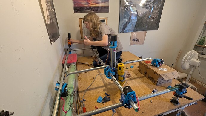

On the way home we stopped by the old house to take my old MPCNC apart. My daughter went to town with an electric screwdriver undoing every screw she could find…she proved able to reach some of the ones I wasn’t able to:
As I tore it apart I remembered a few hidden sins from when I built it:
No - the blue tape is not holding the wires together. It was just what was at hand at 11PM when I was trying to clean up the routing of some of the wiring…under it was proper heat shrink.
I also forgot that 2 of my steppers have really short wires on them. One only has 9" of wire and the other only has 15. So I’ll have to see if there’s anywhere those can work without having to lengthen the wires. Still getting my head around how the LR4 goes together…but overall it seems like it wont’ need as long of wires as my old machine had.

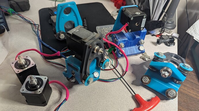

Extracting steppers from the old machine I learned a few things about my previous build:
  1. I do have the “missing” wire from the steppers with short wires. I spliced it onto the others to make them extra long :joy:
So I’ll be doing a bit of wire stretching/shrinking again it looks like.
  1. When I was at the old house I forgot to grab the box my waxed wire went into…I’m planning on doing some cable lacing instead of wrap to keep things organized this time. I did that on some of my synthesizer projects and really liked it for keeping wires organized. On the old machine I had used paracord to shield the stepper wires but I don’t think that will be necessary on the LR4:
  1. When I installed the steppers on the old machine I ran out of the correct size screws and used some shorter ones in a few places that were just barely long enough to engage…I had meant to go back and replace them but forgot all about them:
  1. This assembly on the old machine was…really jacked up:
The adjuster bolts were so tight they had cracked the body (but it was still holding together) and cupped the washers that held the GT2 belt in place. It also meant those two bearings the belt was supposed to ride on were jammed and the belt had just been sliding across them. That probably explains why one axis always looked a little “jerky” - I had jut assumed it was due to an overly tall Z that was acting as a lever…and while I’m sure that played a part…this was really not great.
On the upside…those vertical plates from the ancient design never warped which was something I had always worried about.

OMG, that stepper plate is the second version. I think that might have been the very first update I ever made to add that extra ridge for strength. The original mpcnc was designed for that to be a metal plate, and injection mold most of the rest of the parts.
You are using the washers so that was before the printed washer plate, you also do not have the “built in wiring terminals”. What a trip you have a machine from a very very short window of time. I was updating parts nearly daily at that point. WOW that is crazy to think about.
You can still use the small stuff in a pinch, no worries.
Yeah - I seem to remember that the first set I printed didn’t have the ridge and you released the updated design with the ridge right after my first set of parts started breaking while sitting on my desk and I decided to switch to PETG if I had to reprint everything anyway. (I still curse that terrible roll of eSun PLA Amazon sent me! How the heck to parts break across layer lines when just sitting on a desk unassembled under no stress!)
I think the printed washers I used were also an update - I want to say originally you were saying to use fender washers of some size but then offered the printed washers as an experiment and I decided to try them. I think the washer plate came out after I printed the washers but before I assembled the machine…but I was too lazy/impatient to print them :smiley:
It’s more “had” than “have” now as it’s just a box of pretty worn out prints at this point :rofl:
And yeah - you were iterating quick at that point. I seem to remember a lot of little changes and updates without official releases since they were coming so quickly.
I want to say my Z assembly is also unique to a short window of time. I know you mentioned earlier it looked like the “Better middle Z” but I seem to remember another update to the Z assembly that came out just after I printed mine (but before the 525 release?) I never updated because I had had such a hard time getting the Z I used to print successfully. (mostly due to issues with the support slic3r was generating at the time which always seemed to fail on my printer for any parts that needed support.)
I’m pretty sure it was pre-525 and I wanted to update to 525…but then you started designing Burly and I wanted to wait for that. And then I started thinking if I was going to print new parts I should also upgrade from 3/4" EMT to 1" SS…then the LR started looking like a better option for my size of machine…
And since my machine “just worked” for my primary need of cutting foam…I just stuck with it instead. Which - is kind of a testament to how good your initial early design was despite it’s limitations. Even built out of the “wrong” plastic and considerably larger and taller than recommended it still served me very well for almost a decade! The biggest flaws with it are probably entirely due to print issues caused by my first not entirely reliable printed. I know the Z is a bit wonky because of that…and that one truck never rode quite right (which is why it was overtightened which I now see caused some belt issues.)

Productive evening in the garage with my daughter tonight.
Didn’t stop to take many photos - we wanted to get this bench together. And we did…though I was so excited to get a photo I accidentally left her hanging:
She was still happy to pose with it though:
It’s not quite done yet…those 2x6 doublers for the corners aren’t attached - I thought I had suitable screws but turns out the ones I had were a bit too short. I also need to add a grid to keep it from sagging, and the top is just sitting there not attached yet. I’m also probably going to add a 1" strip of hardwood around the edges to protect the particle board.
I also want to support the back a bit better:
It had to overhang like this because the outside walls of my garage have a 4" “foot” at the base. I’ll probably add a cut down 2x6 under there for some extra support.
Really happy with it overall though. It’s within 1/16" of square measuring corner to corner on the top and bottom, and 1/8" on the front and back. And it’s already WAY sturdier than my old bench which wobbles if you look at it funny. Once I add a grid under the top and some ply or MDF on the sides and some shelves between the side legs it should be even sturdier. But I’d already be willing to give it a “Woodgears” test - if the top was attached and I had the physical skills to jump that high :rofl:

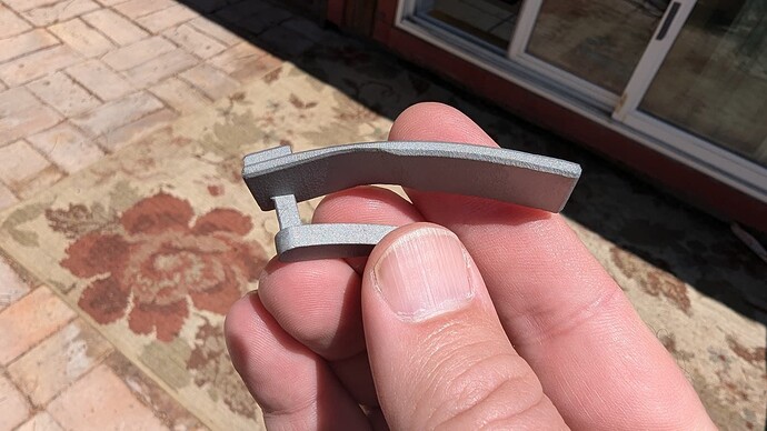

I was really impressed with both the quality and the price - the metal was more expensive than plastic…but far more affordable than I expected.
That triangular cam was $16 in metal, $3.83 in sintered nylon (the black one), and $0.66 in resin (the white one) And these little lift cams were $8 each - I didn’t think they’d come out well due to their geometry but they came out perfect:
I’ve been using the metal uplift cams and the resin main cam…so far the resin cam has shown less wear than my PLA version had so I haven’t had to swap over to the metal one yet.
Ok…off track…well…kind of. I mean…there could be parts on a MPCNC that may benefit from these advanced printing techniques…but…paying for a metal core or side plate would be ridiculous!
