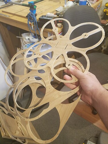

Between crashes and issues with my oversized MPCNC I went through a lot of frames with minimal actual flying:
I actually just threw out a big stack of circles from the top cuts…my girlfriend who’s been pushing me hard to throw more stuff out actually liked them enough she wanted to keep them…but relented and accepted she probably wouldn’t do anything with them either. And if she did want some I could just make her new ones.
I did a bunch of tests to try and find another material that would work. I know it’s workable with CF plate - but the cost for that is crazy high and I couldn’t bring myself to waste that much expensive CF. I tried sheets of PVC but they were too flimsy - so I tried one sheet of polycarbonate and one of PVC:
But that made it worse because now it was both fragile AND flimsy - the PC wasn’t stiff enough so the frame had major vibration issues and when it crashed it still broke. The PVC help up fine…but it was just too soft and flexible.
I played with chemically welding some pieces to it to stiffen it but that didn’t work well either.
So I started experimenting with different laminates. I knew I could use fiberglass on the light ply but even the bare ply was heavier than I wanted. I started doing experiments with light glass over foam board:
But…the light glass was more expensive than I wanted and it started getting heavy again.
I had started to do more testing to find a DIY composite material that was cheap and light - peeling the paper off foambaord and using paper sold for protecting floors during construction seemed to have potential. And I was about to start cutting up old jeans to laminate into panels to try ( I thought a jeans copter would be pretty cool even if it wasn’t practical) but that all got set aside when my wife suddenly passed away. I actually just threw out a lot of the test pieces I had made as I cleaned out the old shop.

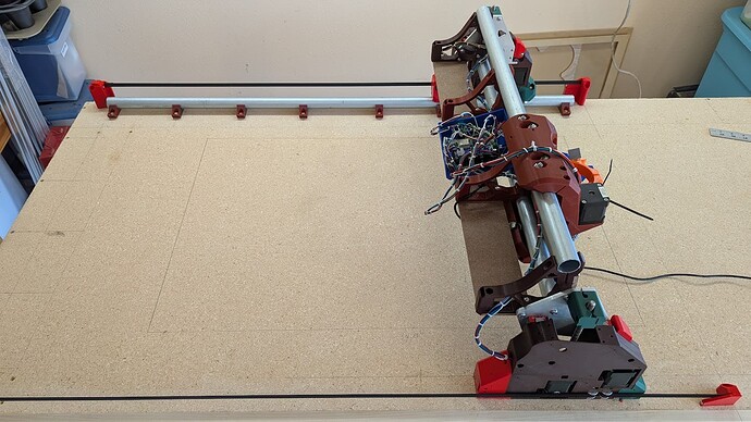

Speaking of which…got the other side finished and assembled it all. That belt into the YZ min was way worse than I expected :scream: But…I got it in there.
Mounted the lowrider box and wired it up:
Still have to clean up the wiring…but will do some tests first:
The X belt needs to be adjusted a bit too - I made it a little too long and the tensioner can’t quite take it up…still it’s enough to see it move:
Of course first I powered it over USB and tested all the endstops to confirm they were functional. Once that passed I gave it real power and was happy to see X and Z both moved. X was initially backwards and my first attempt to home it took off in the wrong direction - thankfully I thought to hit the endstop manually before it crashed.
So, powered down, flipped the connection on X and powered back up for that little video.
Hopefully tomorrow I’ll have time to duck out to the garage and mount it up and see if Y works as well as X/Z do…then I can dig in on cleaning up the wires in the control box.

Well, I did duck out to the garage last night. Good news is the AC out there works pretty well, took it from 97 down to 80 in about 30 minutes - could have gone cooler but 80 was comfortable enough to work in and I’d rather not dump money into running the AC more than I have to especially since it’s still March!
And I was able to test my Y axis…one motor was reversed - so initially it was fighting against itself - but that was easy to correct. I also took advantage of the extra space on the bench to confirm a few squareness checks on my build and it all looks great. And it looks like I got my initial Z endspot positions pretty close as an initial Z home resulted in barely 1mm difference measuring the bottom plate to table. So all was looking pretty good!
But…I still don’t have it actually mounted to the table. You may remember I mentioned awhile back that I decided to go a little wider than my initial plan. And I haven’t cut my Y rail yet…I had considered leaving the Y rail as long as possible but didn’t realize that it would interfere with the belt mounts as I hadn’t looked that closely at how the belt and rail mount.
So I had to cut the Y rail down a bit more afterall…which worked…except I took the wrong number from the calculator :roll_eyes: thankfully I took the table size instead of the rail size so I cut it too long…but it still confused me when I went to put it on the table and it was too long. So I get to cut that again.

Well, it’s alive!
I didn’t even bother to square it yet…just did some rough checks and confirmed it was moving sanely in all directions…then strapped on the closest writing implement I had and gave it a go.
Honestly…went better than I expected. Between not being squared and a zip tied pencil which was moving all around and wore down as it went I consider this a huge success. Far better than the first test I did on my old MPCNC at least.
Biggest problem was I couldn’t upload gcode from my ipad:
I don’t expect that to be part of my regular workflow though so it doesn’t worry me…I was able to use my android phone to upload the crown code without having to go back inside to my computer.

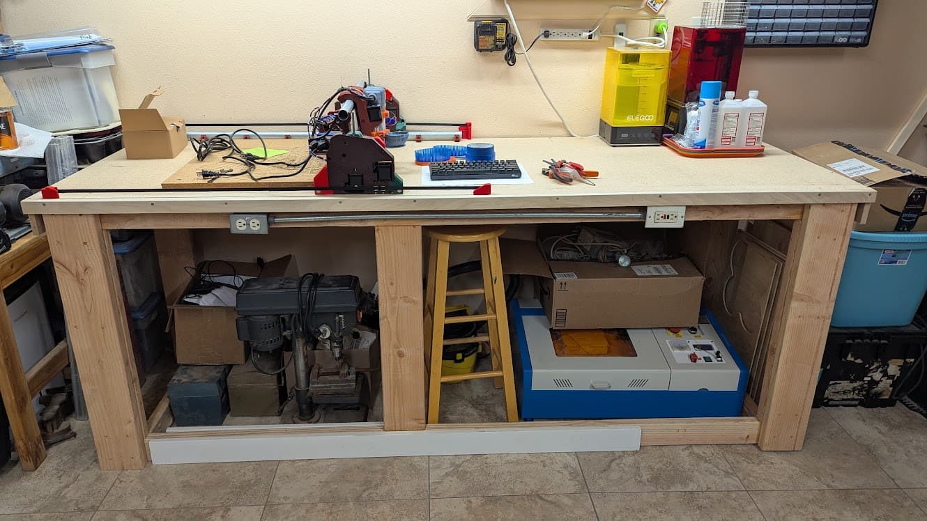

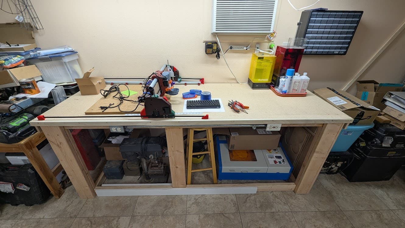

The bench is looking better too:
I added a 1" strip of poplar across the front to protect the particle board. Then mounted some outlets for power…and added some supports where the LR mounts:
I still plan on adding more MDF strips under the main area under the LR to help stabilize it and keep it flat. But I ran out of screws and time.

That looks like a great table. Are you going to put it on casters? It looks like 6 would work well. Harbor freight has some cheap ones.
I considered it strongly…I realized I’d have to account for them when I built it if I didn’t want it to wind up taller than I hoped. And decided that realistically I’m almost never going to move it once it’s done so probably best not to bother. (Plus I’m cheap and casters cost money)
I did have a set of “casters” on hand…but they’re really designed to mount to a sheet of plywood to make a base for something. They’re nicer than normal casters as they have a lever design and drop down onto solid stops when “parked” so great for equipment. I added them to the bench last weekend and they did help it move around really easily. But…the design of them wasn’t ideal. They stick out about 6" in front with a big locking lever that lifts/drops the table. And that was a problem. Because I park right next to the bench and my daughter and girlfriend both have to walk in front of the bench to get in and out of my car. And both of them are notorious for tripping over just about any thing.
So…even though they were bright orange and hard to miss I knew if I left them on there one or both of them would trip - probably repeatedly - and that would not end well for me.
And there are still some things I’m not overjoyed with about this bench. So I may build another in a year or two. I’d build the top more like Ryan’s table plans making a proper torsion box and grid which I’d then mount onto the legs…instead of my current approach of putting the top on the legs and then reinforcing it. I can tell already this top isn’t as flat as I’d hoped and is getting worse as it sits.
And once I add a shelf underneath I’m sure I’ll have some thoughts on how to optimize the space under it better in the future.

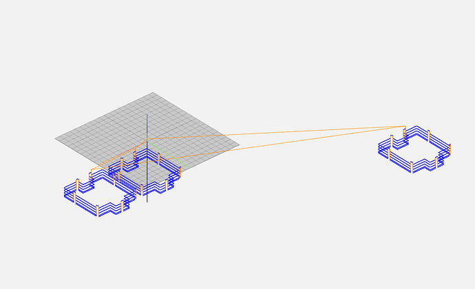

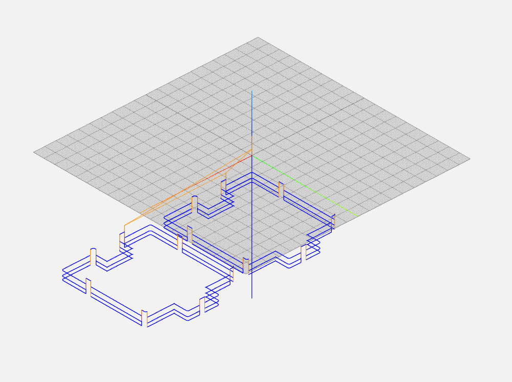

Note - I’m still using Estlcam 11 - if I absolutely have to I can upgrade to 12 but it would be best if I could wait a few weeks before spending the bucks on that since I had to pay two mortgages this week. So some of the setup screen shots aren’t 100% relevant…but I’m working through it.
1st issue - (And this is probably entirely to Ryan still working on the docs.) If you follow the setup instructions on this page: EstlCAM Setup - V1 Engineering Documentation
It has you add startup gcode for probing. But then goes into using a pen and saying to set Z manually. But then when you run it it tries to probe.
I first worked around this by wrapping some aluminum foil around my pen and clipping the ground of my probe to that. It seemed to work. But my drawing occurred a mm or two above the paper. So I decided to just eliminate the probing and removed those lines then redid it just setting the pen to just touch the paper.
But again I got an “air cut”. To do the crown drawing I did above I just pushed the pen down manually after trying a few different homing/zeroing things and deciding I must be missing something. As it sure looks like zero is set at the surface of the paper with the pen just touching so a 1mm “cut” should have the pen in full contact not retracting above the paper. Maybe I’m just not understanding the FluidNC screen correctly when I zero out…

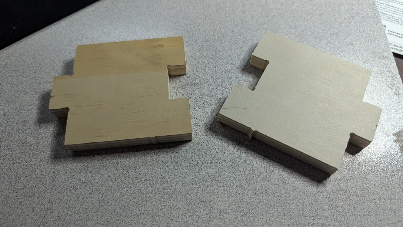

That said…I did go ahead and try making something for my girlfriend to help compensate for the time I’m spending…it may have been premature to go throwing it at wood…and I definitely wouldn’t suggest trying this to a 1st timer. But I felt I knew the risks and was ready to do this (despite just having nicked a screw head trying to mark my extents in my old spoil board.)
So as I just hinted I screwed down my old spoil board (which was originally the base for my first build 9 years ago) screwed down a scrap of 1/4" ply I had on hand…then spent an hour trying to remember the best way to convert a STL to a DXF in Fusion only to wind up using tinkercad which “just worked”. And…
I should have measured that piece of scrap instead of just eyeballing it. Oh well, just looks like murder kitty has a bit of a clipped grind on his knife :smiley:
But it worked…it worked wonderously. Way better and easier than I ever experienced with my old machine.

My helper finally decided to join in again and we finished reinforcing the back of the table tonight.
Of course my drill batteries both went dead with 3 screws left to do so I had some time to do some cleanup. Started sorting out the wires. Looks like I’m going to have to extend the tiny touch plate and X endstop wires (I made the endstop wires the same length as the touch plate wires assuming the touch plate wires were a suitable length for a full sheet machine.) So can’t quite put a lid on it yet…but at least I have a lot fewer wires over the board.
And I managed to break one of my own endstop wires…I knew 30awg was risky…but I wanted to make it easy for myself to fish though the passages. Honestly I think this was just a bad crimp and it was an easy fix.
Also found I can’t quite push the bench all the way up to the wall or my Y endstop on the Xmax side hits the wall. Guess I should have mounted the machine 1/2" in from the edge. oops.
But it’s all together now and the bench is looking pretty good:
I moved the CO2 laser to under the bench because it’s not really usable right now. I swapped it to a smoothie board and started installing new optics but didn’t have enough room around it to access the mirror mounts and actually get it dialed in so it’s just been collecting dust for a few years. There’s actually a bunch of extrusion next to my bench that I was going to use to build a new motion system for it that I haven’t gotten to yet either. Add in the fact that I don’t have a chiller and buckets of ice don’t last long in the desert - and ventilation was a pain at my old house…and it just became a paperweight. Though - now that it’s in a garage with an outside wall right behind it I may install a vent and finally get it going again…would be nice to have…but project for another day.
I also realized that I actually have room to work on full 1/4 sheets of ply/mdf. My cutting area doesn’t cover a full 2’x4’ but there’s plenty of room for 2’x4’ sheets to fit on the table. So that’s a nice little bonus! And means a 2’x4’ sheet will make a decent spoilboard.

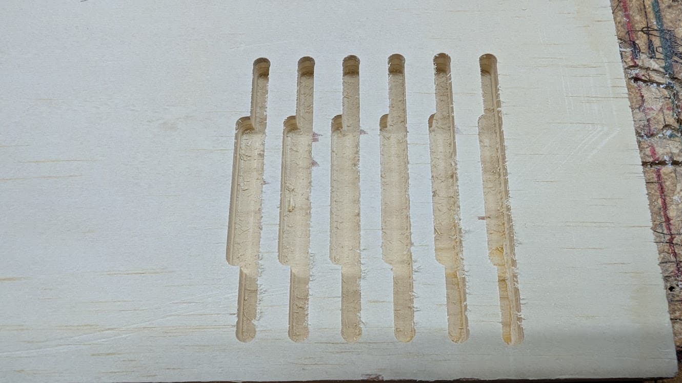

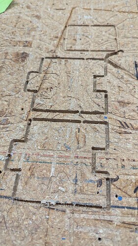

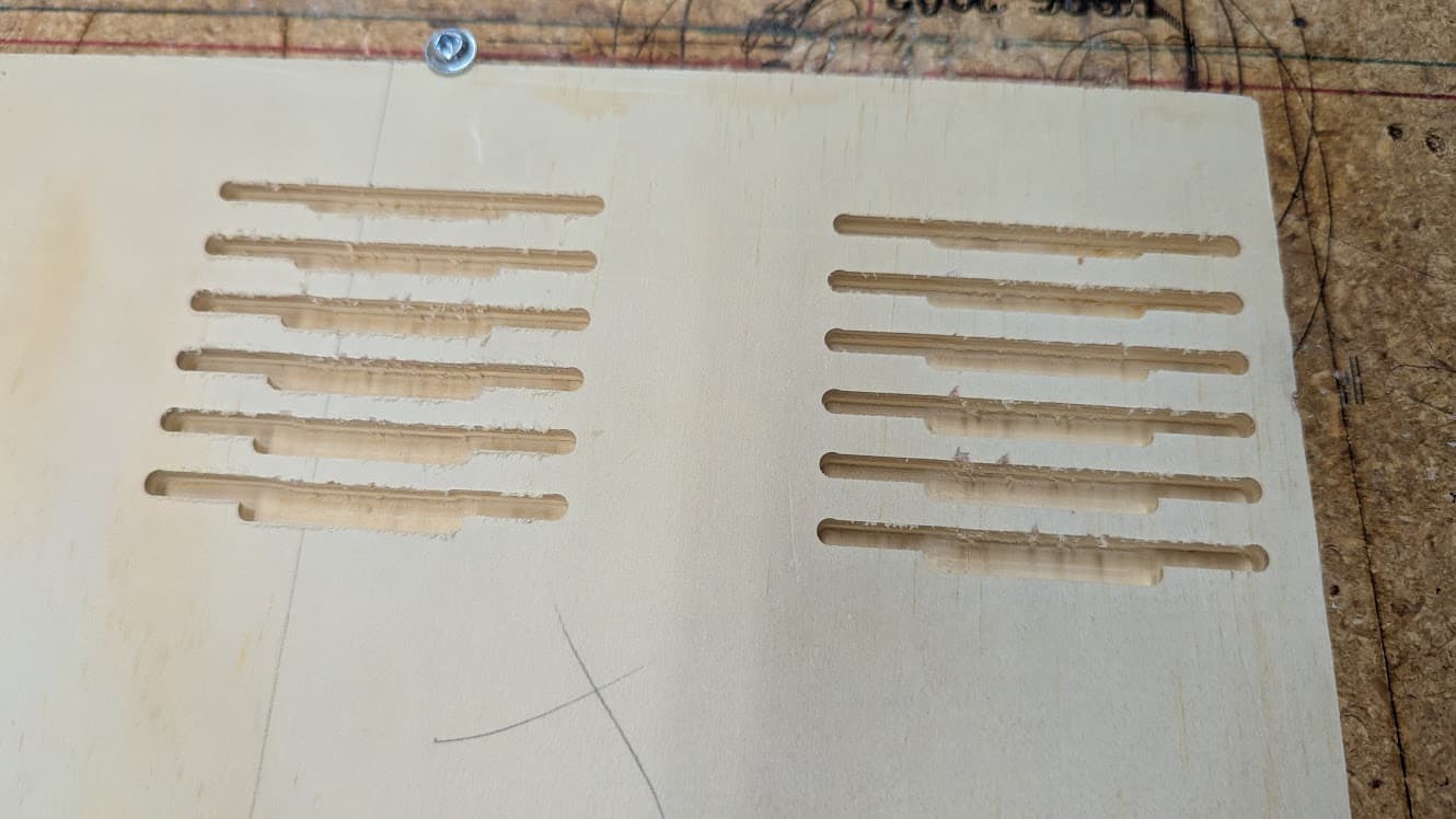

I got home from work and immediately ran a hog out test with @jamiek’s gcode generator. Suggested defaults looked pretty good. The cut was definitely getting a little rougher as it progressed - but again this endmill is pretty old and beat.
Still it all looked acceptable to me so I ran another test starting at 1000 mm/min and going up to 3000mm/min
This time I could definitely see some deflection in the cuts at the highest rates:
I didn’t realize at first that the test also increases the stepover - missed that somehow when setting it up…so I may do more tests to see how stepover affects things. But it looked to me like the 2200 mm/min test was the first that started to show deflection - so I fired up estlcam with some test parts I whipped up in Fusion and gave them a cut at 30mm/sec with a 4.5DOC.
That’s WAY faster than my old machine was capable of…my old machine struggled and was unreliable at 10mm/sec 1.5mmDOC with this same bit.
Test parts came out ok…not spectacular - but they’d be good enough I wouldn’t have felt like I had to do them over if they had been real parts:
I suspect a bigger issue is just how beat this endmill is. I mean…I can see the runout on it from it being being crashed into work several times and having nicked a few fixturing screws.
I also managed to somehow really mess up a quick metric conversion in my head and somehow came up with 20mm for cutting depth on 1/2" stock…oops…sorry spoilboard:
I kind of like how it’s a brand new machine…but this spoil board has 9 years of memories I’m not really to give up yet. Soon I’ll pickup a new sheet for a fresh spoil board I can properly surface…but for now I’m just having some fun.

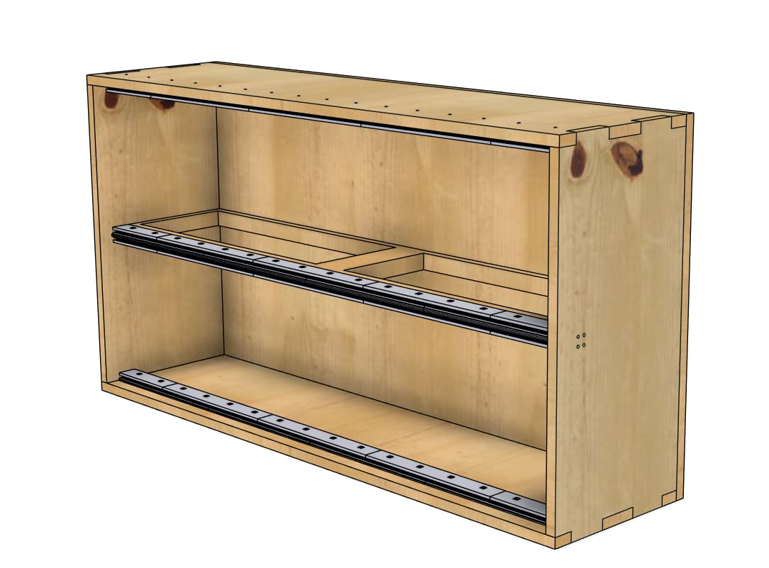

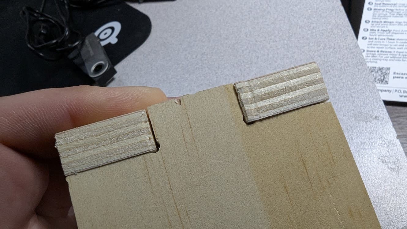

These test cuts are to see if I need to account for any clearance when I either cut some particle board to make a grid under my table…or make a new case for my modular synth:
The last case I made I used 3D printed mounting rails…but had a hard time accurately drilling the mounting holes manually…and it melted in the heat because of lack of support behind the center rails. Plus my table saw is pretty much beyond hope and getting the box square was a major struggle. This is why I decided to make my Y a few inches longer.
The combo of tabbed top/sides to ease assembly, CNC drilled mounting holes, and a support frame in the middle will hopefully make for a much more accurate and solid case…which will help keep the rails from sagging if it gets left in a hot car again.

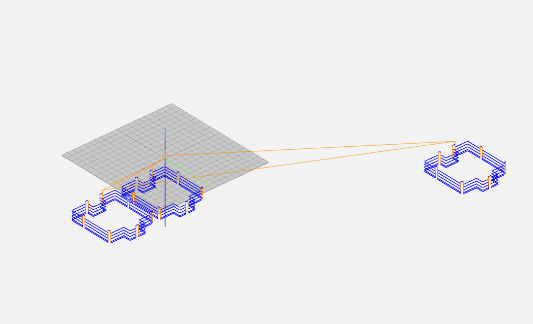

I’m really liking FluidNC…but what I’m not liking is how if my ipad goes to sleep when it wakes up it looses connection. And then if I reload the page fluidNC won’t bring the UI back up until the job is stopped. Not a fan of that…made it hard to tell what happened at the end of cutting those test parts when I thought the program was over but it suddenly started cutting another set a little further down the Y axis.
The estlcam preview didn’t show that…and loading the code in NC Viewer definitely shows something that was unexpected and not what estlcam’s preview showed…but also wasn’t what actually happened:
No clue where that third pattern came from or why it’s off in the middle of nowhere like that…but that’s also not where it cut…very odd.
Fixed the depth and resaved in estlcam and it looks a lot more sane now:
But the point remains…losing access to the UI during an operation is kind of a bummer…and I don’t really want to change the timeout on my ipad or have to constantly fiddle with it.

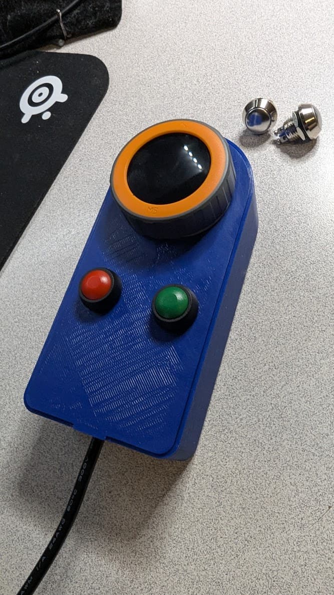

So…thankfully an M5 dial arrived last night:
Not sure yet if i want to fire up the MMU and use the nice metal buttons…or just stick with the red/green ones I had on hand for now.
Actually also ordered an encoder dial and a CYB but they’ll take longer to get here…the M5 is pretty neat but the big encoder and CYB seems like it may be a bit nicer of an interface.
Guess I should make that wire actually connect to something now…
Looks great! I think you will really like the M5 pendant. I’ve run jobs that were on the SD card and it is really nice for jogging. The web UI works well however the pendant is handy and it hasn’t went to sleep on me.
