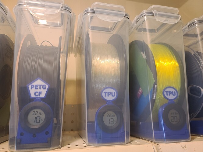

I have 4 of them that are still holding, 6 months later, and the silica beads still look pretty close to the same color. All still reading 10%, with my indoor humidity remaining constantly between 50-60% around it

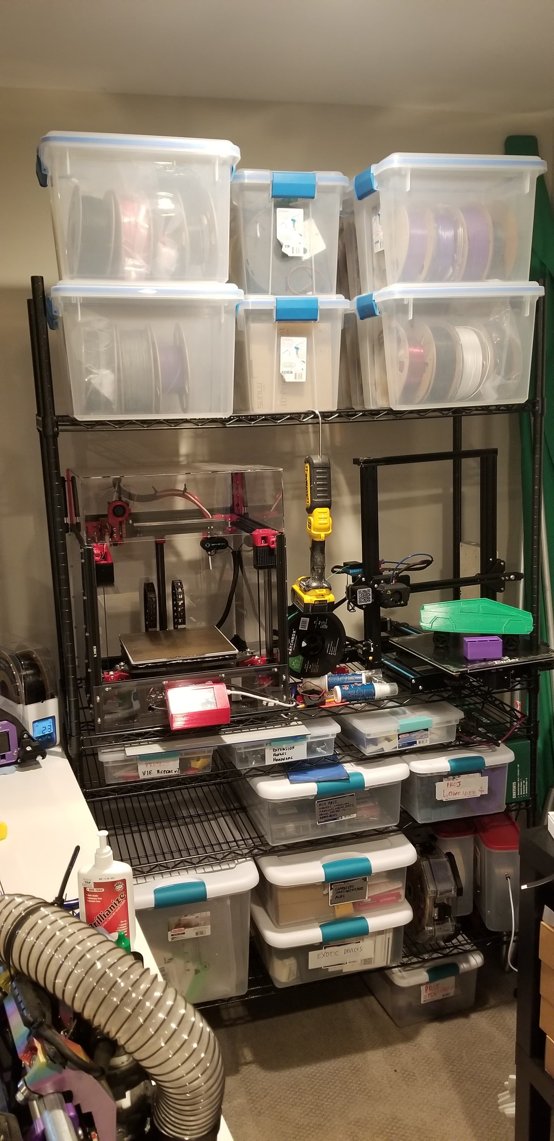

Bought several cereal containers, modded to enable filament to be pulled directly. They work great, but I didn’t like the cost though, and awkward to stack. Eventually ended up buying ~10 “Sterilite 20 Qt. Clear Gasket Storage Box, Blue Latches with Clear Lid”, $7+tax each. I couldn’t figure out a way to make vapor proof containers for less when you consider time+material.
https://www.walmart.com/ip/Sterilite-20-Quart-Clear-Gasket-Box-with-Blue-Latches-Gasket/39916455
Also bought glorified ziplock bags https://www.amazon.com/gp/product/B0CD2MWB1X. Never got into using them, even though they come with an interesting vacuum pump. The 20qt gasket containers have been good enough for my TPU/PETG/PLA.
Haven’t bothered tracking humidity, I will now thanks to this topic and folks here. Am using the less evil/toxic silica https://www.amazon.com/gp/product/B01N7OE6WK.
Am in the habit of putting spools in my heated single spool Sunlu filament dryer before, and after use and removal (before putting back in the water proof container). I don’t have a printer farm or production setup, am just goofing around with basic filament materials, so far…

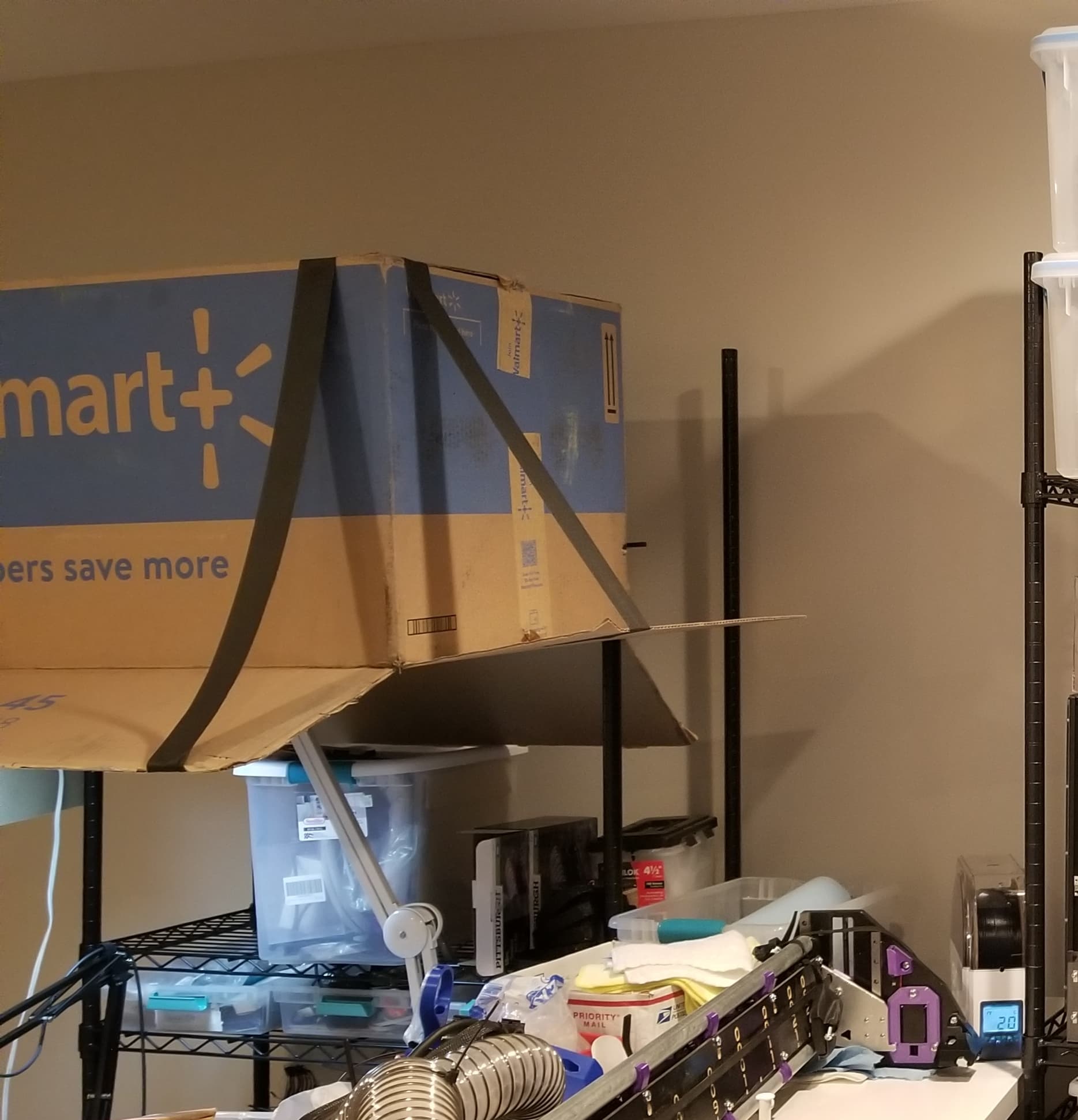

Order enough sterilite containers and you get a free large Walmart cardboard box for pets/kids to play with, or to use as a jank AF Maker desk lampshade…
That’s what those 3 in that picture are sitting on top of… 54qt. Sterilite. That’s my “Not in use” storage

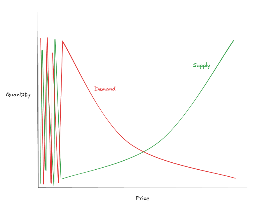

Here’s the classic supply and demand curve I copied straight out of an economics textbook:
