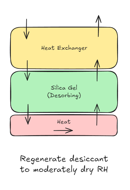

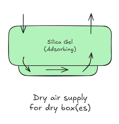

My thought is that this would be two stages, one stage is drying desiccant like a food dehydrator. The other stage is using the desiccant.
(Yellow heat exchanger block is optional and might improve energy efficiency by retaining some of the heat when dumping the humid air.)
Then using the desiccant would be blowing air through the desiccant into one or more dry boxes:
In this desiccant mode, return hoses from the dry boxes would be much better than drawing in ambient air because the desiccant will last much longer before getting loaded with moisture.
Currently it would be a manual switch/reconfiguration between regenerating the desiccant and using it.
Everything else is probably overkill and more of an experimental concept to see if I can make ultra-low RH with multiple stages or something.
The picture above where I have 20% RH and 54% RH would be the usage stage, and shows that when you blow air through desiccant, the air becomes dry.

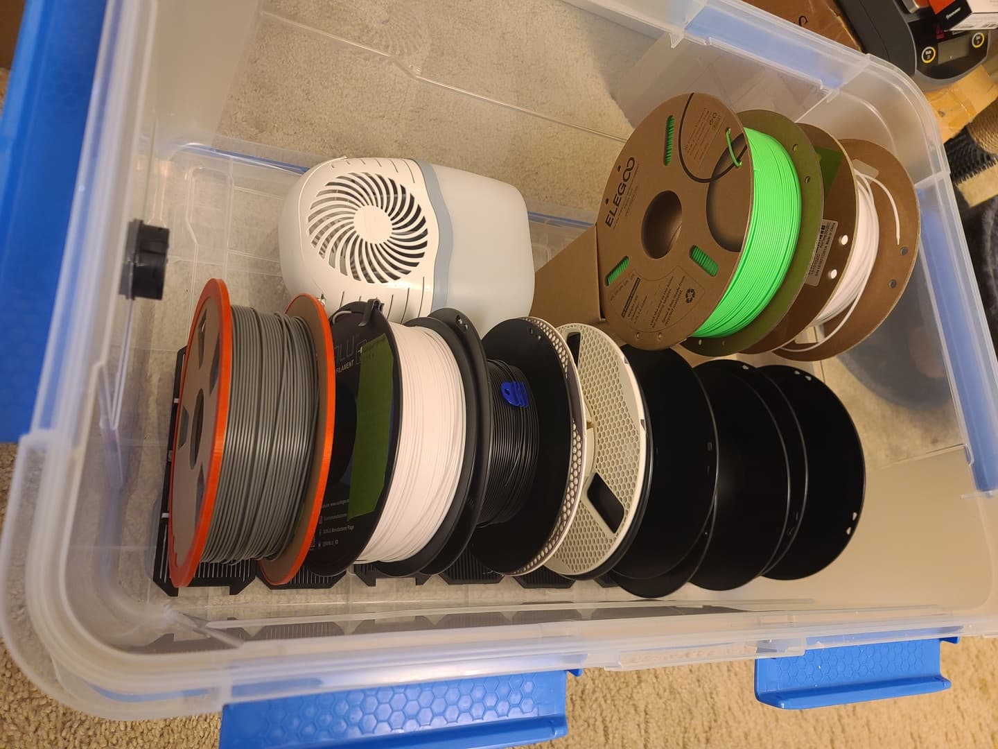

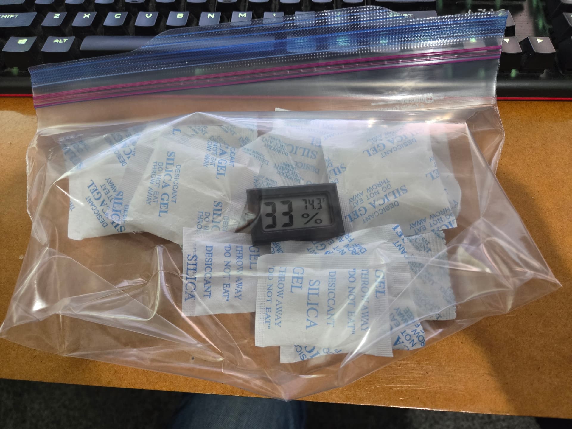

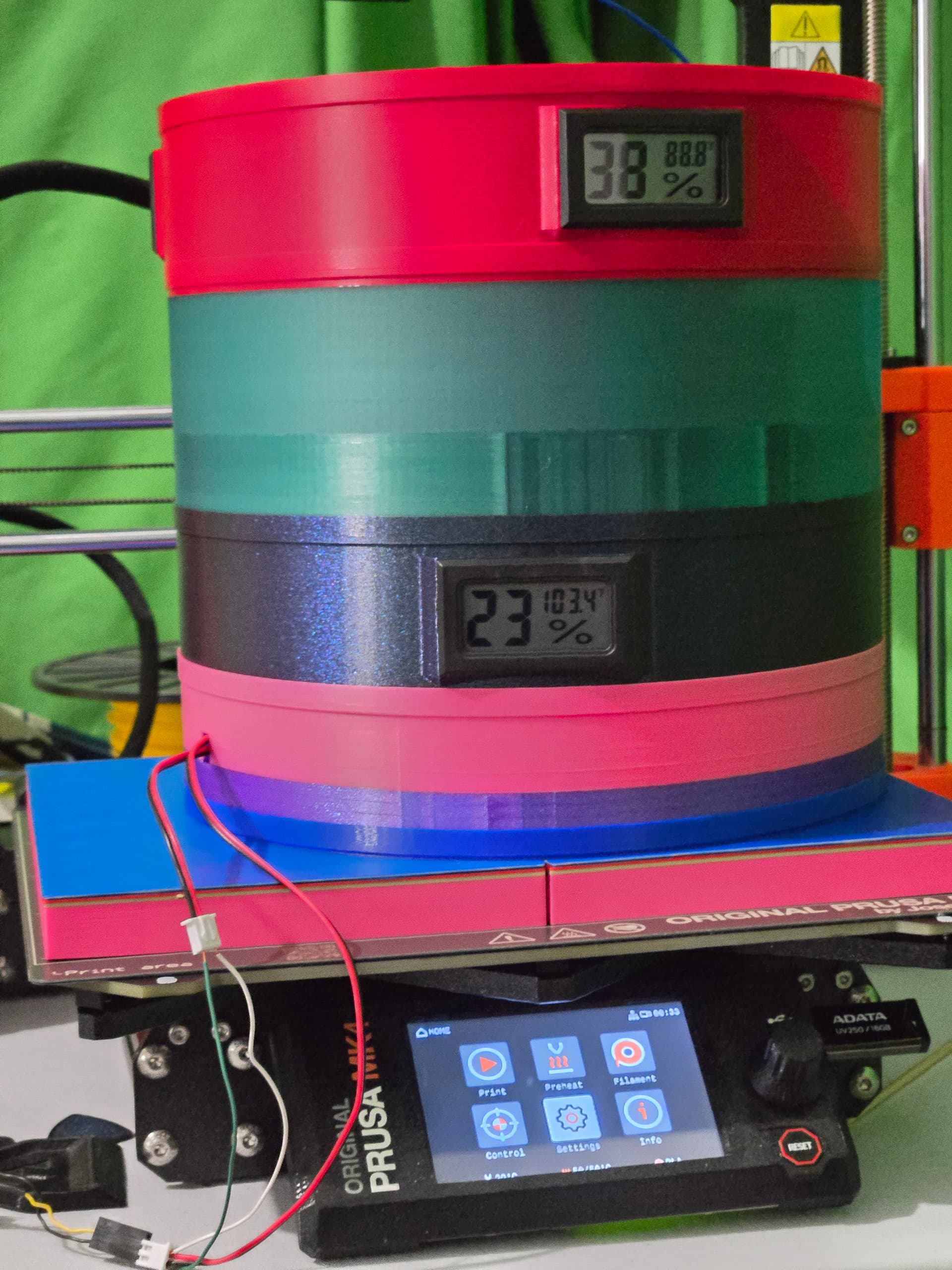

I tried using the heated bed of my printer to run the regeneration cycle. I have some old silica gel packets that are about 44% RH if I seal them in a bag with a sensor, and I thought I might try to dry them.
It appeared to be completely ineffective, and I think the reason was that the fan was too weak and the impedance of the bottom heater module was too high. The channels were long and thin, so there was not enough airflow and it didn’t do anything.
I redesigned the blower to use dual 5015 radial fans, and I made the bottom heater block with fatter, shorter channels.
I just turned it on again and I don’t know yet if it is working…

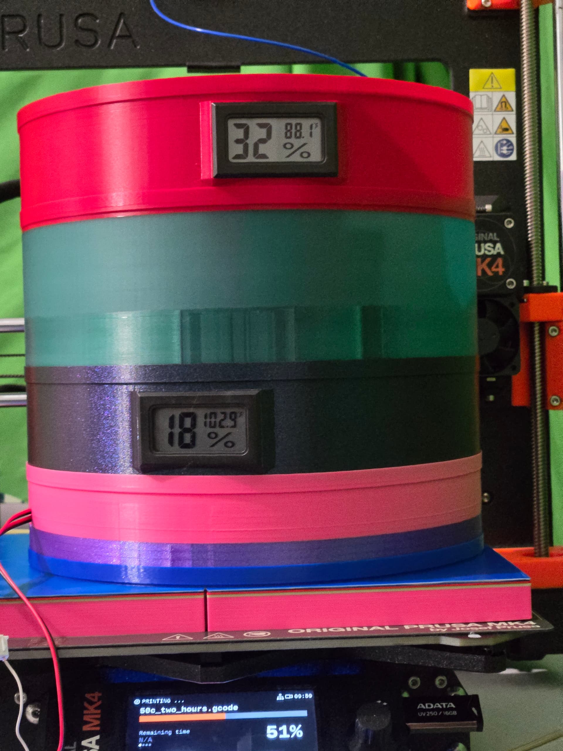

The green segment contains the old silica gel. The blower is the pink/purple segment with the wires coming out.
Well, I think I am being forced to conclude that this is a failure.
I think there are still some good concepts, but specifically, going for 100% printed (in PLA to start with) and using the printer heat bed as heat source is not good. Either the bed is anemic or the heat transfer to the air is extremely poor, and the hot air source is not nearly high enough. Then on top of that, a huge amount of heat is being lost before it can do anything useful.

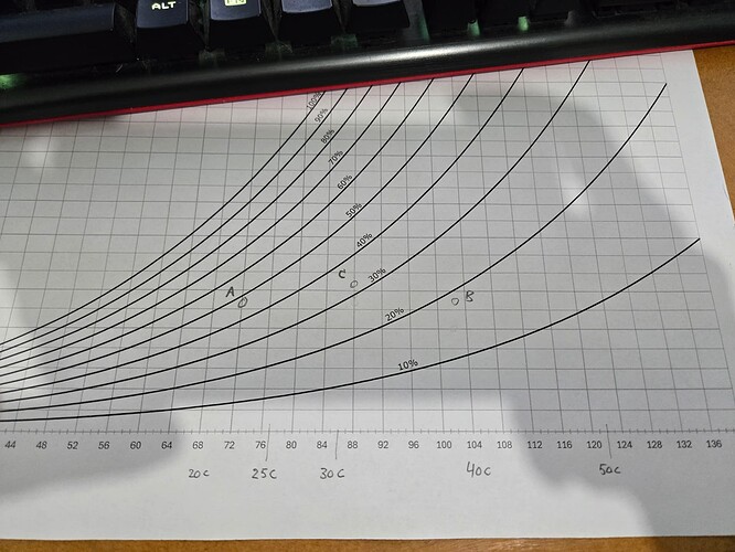

I let the system run for a couple hours today, and apart from a slightly lower ambient humidity, the result is essentially the same as the last picture.
The inlet is about 47% RH at 72F.
After passing the heat module it’s 18% RH at 103F.
Then after the silica gel it’s 32% RH at 88F.

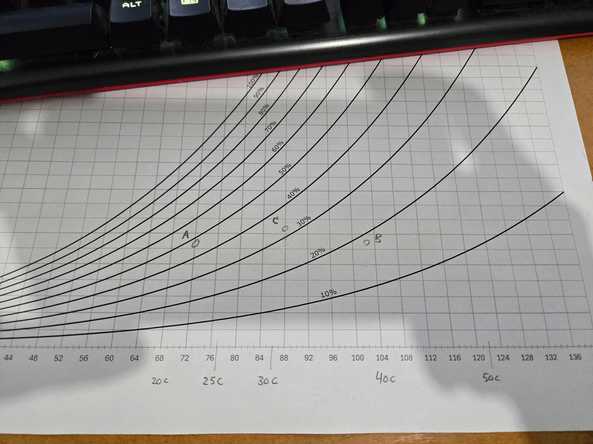

The inlet is at A. After heating it’s at B and since it is being purely heated it should (and does) move horizontally. The vertical axis is absolute water content, which doesn’t change from A to B even though relative humidity does change.
From B to C the temperature decreases and the absolute humidity does increase slightly, meaning it is drying the silica gel a bit, or maybe it’s doing nothing and it’s within the margin of error of the sensors.
But either way, I feel like it is not nearly hot enough to be effective. Even when I remove the silica gel and run an empty plastic chamber, the temperature is barely any higher, so it seems the heat loss is really bad.
It doesn’t do nothing, and this old silica gel is now at 33% RH instead of 40 something, but I’m still saying it’s a failure.
On my previous iteration I cranked the heat bed temp up to 65 and it started to melt the PLA, so I kept the bed at 50C this time.
I think a dedicated heater is the way to go, and it needs a controller, and it can’t be made from PLA, which should have been obvious from the start.

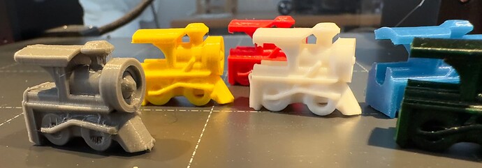

The PLA which was dried with inconsistent heat in the Eibos tends to go brittle on the outer winding where it was overheated.

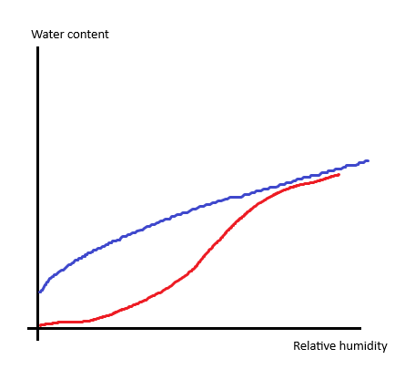

Wut? I had not heard this. This sorta blows the premise of my intended design, unless it is just some materials that require heat to be dried, and other materials are okay simply with low RH.
If there is a material with a high equilibrium water content at room temperature, even at low RH, then I think that means you might have a relationship like this:
Where blue curve is at room temperature, and even very low RH doesn’t get fully dry, and red is at elevated temperature, where drying is possible. These curves are made up of course.
In this scenario you are going to have a very hard time storing the filament, and even dry desiccant at say 10% RH could make it worse. You pretty much always need to cook it if it has been a while. Maybe this is where the inline heater/dryer is needed to dry a few hundred mm of filament just before it goes into the extruder.

I’ve said it before but my “good” (Prusament) PLA and PETG filament is nowhere near as susceptable to humidity as others. Here’s yesterday’s example - these are tiny train game markers. All except the grey is Prusament PLA - stored in my “dry” boxes at up to 55% humidity, age up to at least three years. The grey is an elcheapo local brand PLA, well tuned, received and dried a week ago but left out in 85% plus.
I’ve noted that warming before printing often makes a noticable difference to print quality, so the pre-dryer might make some sense even if it’s not drying.

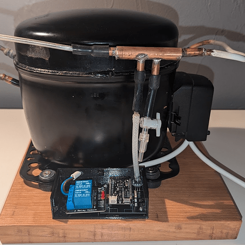

From memory our vacuum setup for resin degassing was pretty cheap so I imagine there are cheap 2nd hand options around. Looking at Amazon there are options with a vacuum pump in the ~$100 range.
I’ve seen things go past where people have used fridge compressors for vacuum bagging stuff.
We also briefly looked at venturi vacuum generators but the airflow requirements are pretty up there. I guess you could get around this with a small compressor by manually controlling the valves to drop the pressure slowly, allowing the compressor to recharge in between.

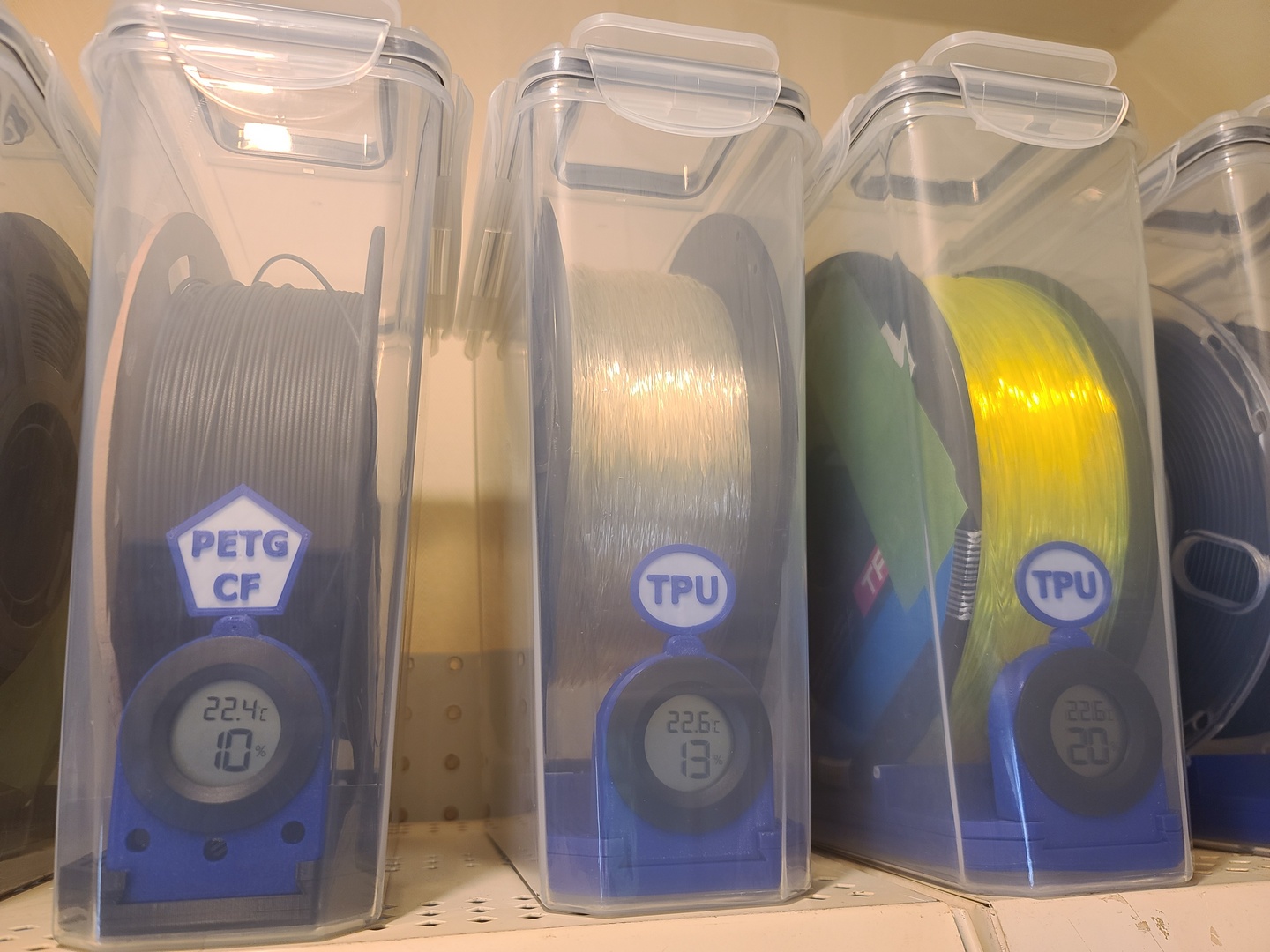

In the past 9 months or so, I’ve been experimenting with a bunch of cereal containers that each hold silica gel balls. They keep the humidity down for a few months then they need to be recharged which is a hassle. My guess is the air pressure variations push moisture past the seals and over-run the desiccant.
At the same time, I tried two 79 quart tubs. Inside these two tubs I have small bags of calcium chloride as the main desiccant but there is also some silica desiccant in there. These two tubs stay as dry as the meter can read even though they are opened more often.
The calcium chloride was $50 for 50 pounds and I don’t think I have used a single pound in the last 9 months. I store the excess in two 5 gallon buckets with watertight screw lids.
I’m currently mocking up a proper container that will allow the spools to hopefully feed a filament changer. It’s looking like I can fit 14 spools into the container if I mount one row on the bottom and the rear row about 3 inches higher.
