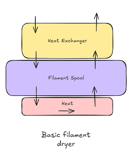

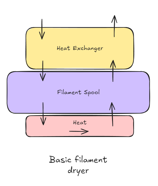

Here’s the basic “heated filament dryer” that would take the place of a food dehydrator, but with a heat exchanger so it’s not throwing out all the heat after it passes through the chamber once.
Basic filament dryer

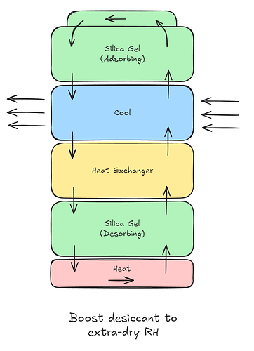

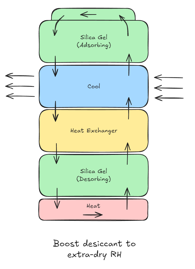

Another option is for creating extremely dry desiccant when the ambient is not very dry. By regenerating two canisters to “moderately dry RH” and then using one of them at room temperature as the “virtual ambient” and heating the other one, it should be able to regenerate down to much lower RH than a single stage is capable of.
Multi-stage
(The cooling module is needed or else the desiccant on top will slowly build up temperature and lose some of its effectiveness.)

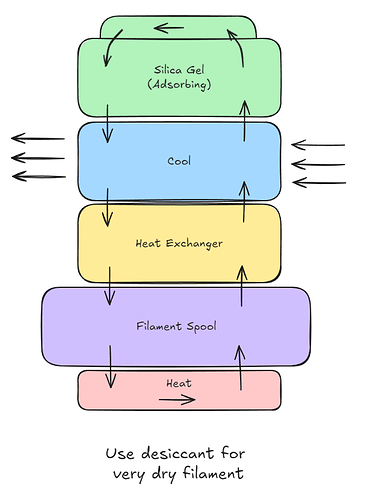

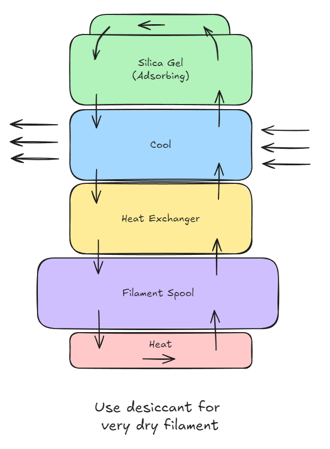

Finally, if the “food dehydrator” or “dry box” configurations are not dry enough, a heated filament dryer with cool desiccant adsorber should be able to achieve very dry filament. Even better if the desiccant has been dried to the level of the two-stage setup.
Multi-stage applied to filament

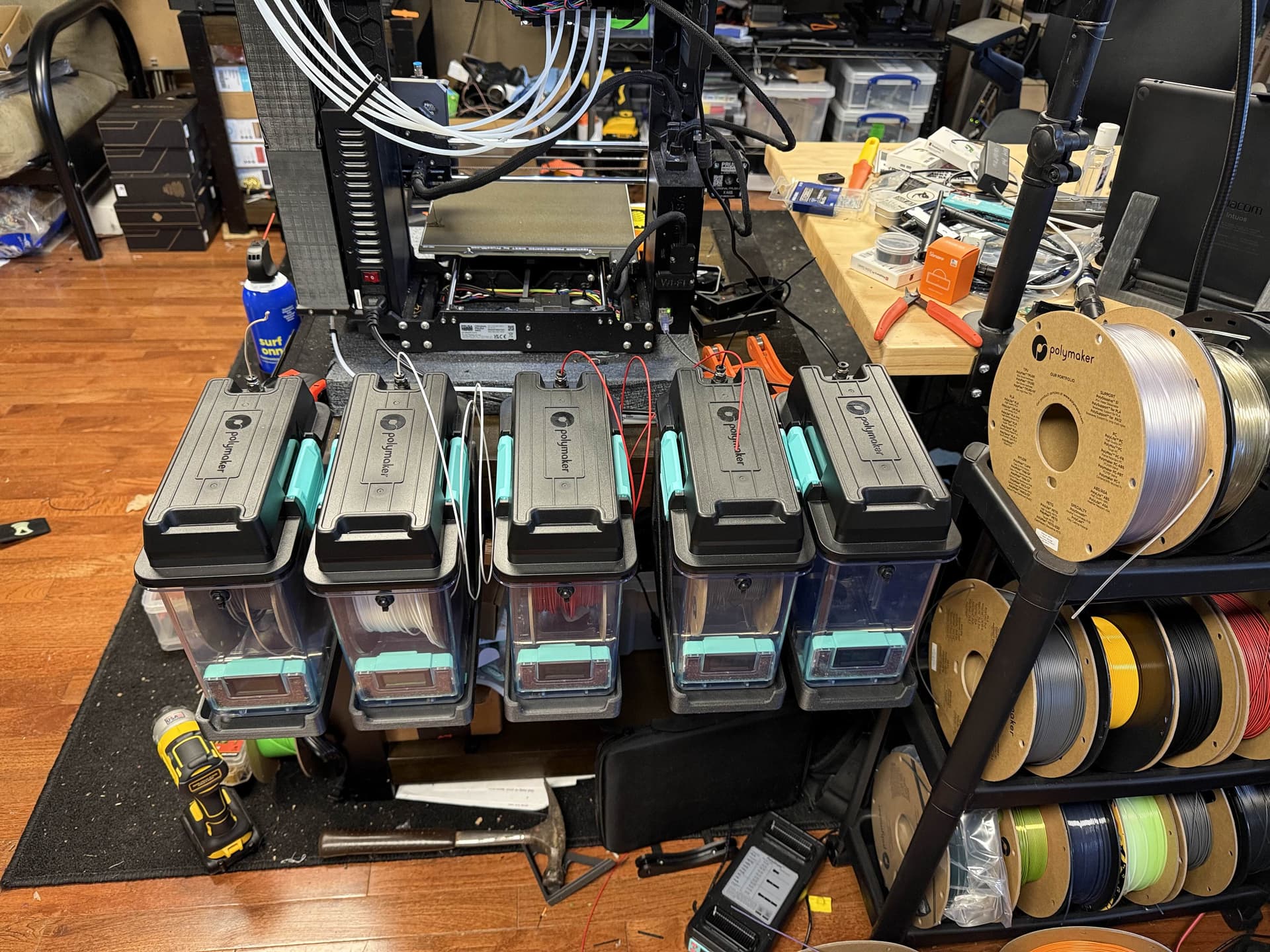

We have bad humidity here at times, and as such i never thought much of my dryers, just basic, no air flow ones (cheap). Til one day i went out there and found massive condensation on one of them. I posted a pic here but i was never able to find it. So my belief is they really don not need air movement, but probably would speed things up! I keep my rolls in large ziploc bags from amazon. They hold 3 rolls each and place packets in to grab any moisture. (which i probably should put in the dryer overnight to renew).

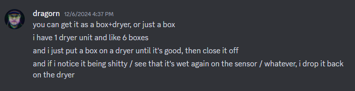

Just saw this and I like the concept of a filament storage box with a dryer dock.
When it was released I thought it was a good concept, then I realised I need Twenty of them!:face_with_raised_eyebrow:
Agreed. I like the concept but not the extended price.
I know a couple guys that have them. As far as they’ve mentioned, they work well. Just pop the box that needs a touchup on the dryer. They feed their bambu and prusa multimaterial printers from them.

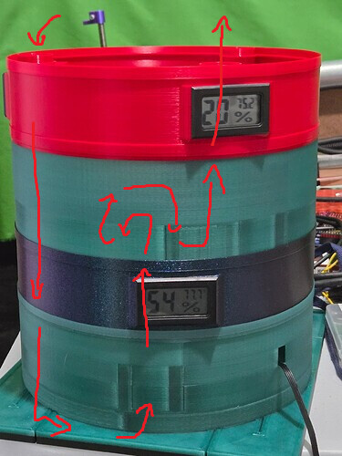

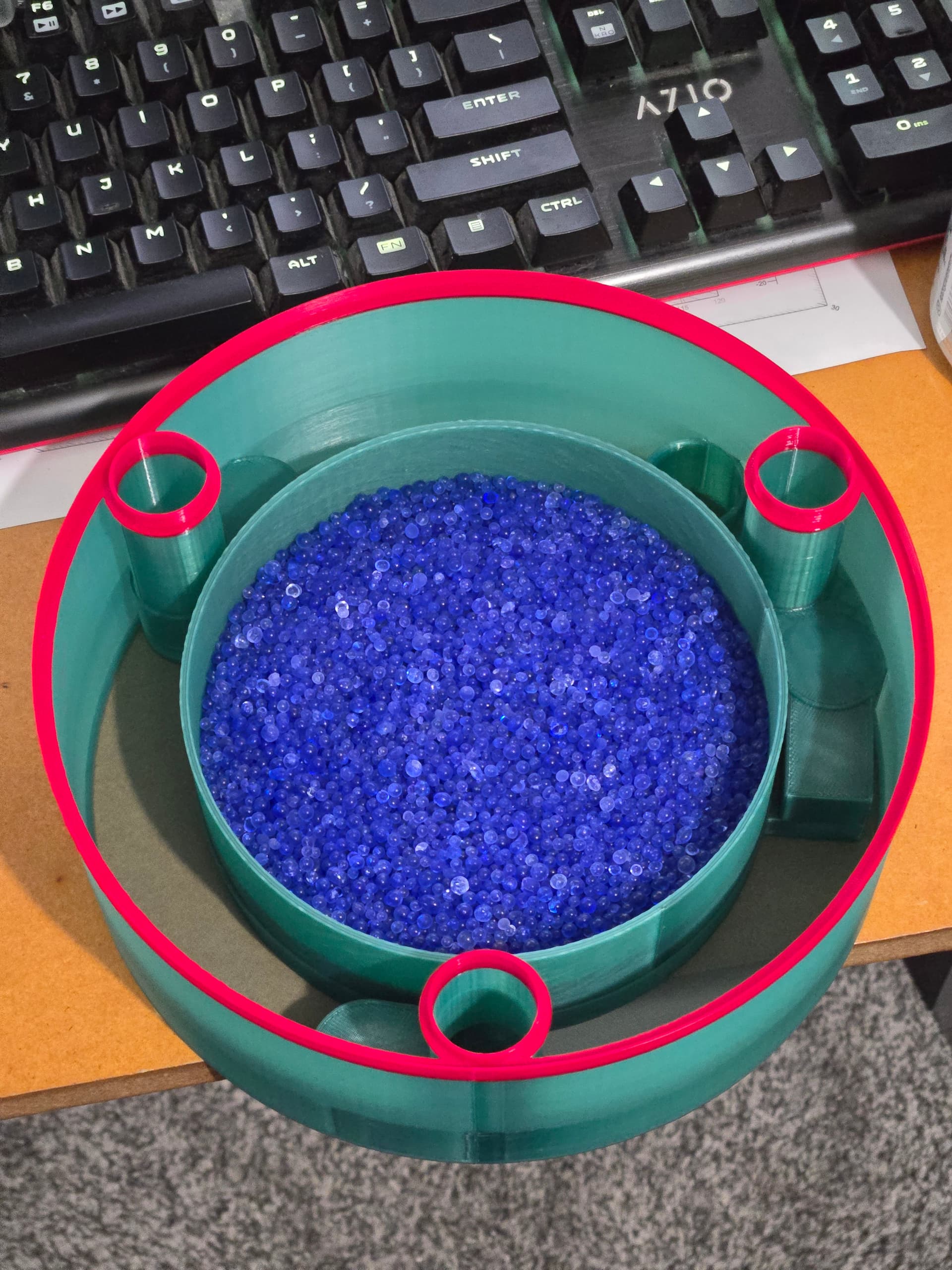

Okay, this is taking a bit more work than I anticipated, but I have some partial success.
Part-way through, I became paranoid about leaks. I have to have somewhat loose-fitting joints (relatively speaking) because it’s 3D printed, and there are a lot of joints. If the ambient is high humidity, then the leaks in/out from the system could perhaps produce a bigger moisture load than the filament.
The approach I took is to have an outer skin that is round and with an overlap, it shouldn’t be too terrible, and tape could be used to seal the outer skin completely. Internal leakage that recirculates a lot, like 10%, through unwanted paths will just mean slightly reduced effectiveness, whereas 10% exchange with humid ambient could be catastrophic.

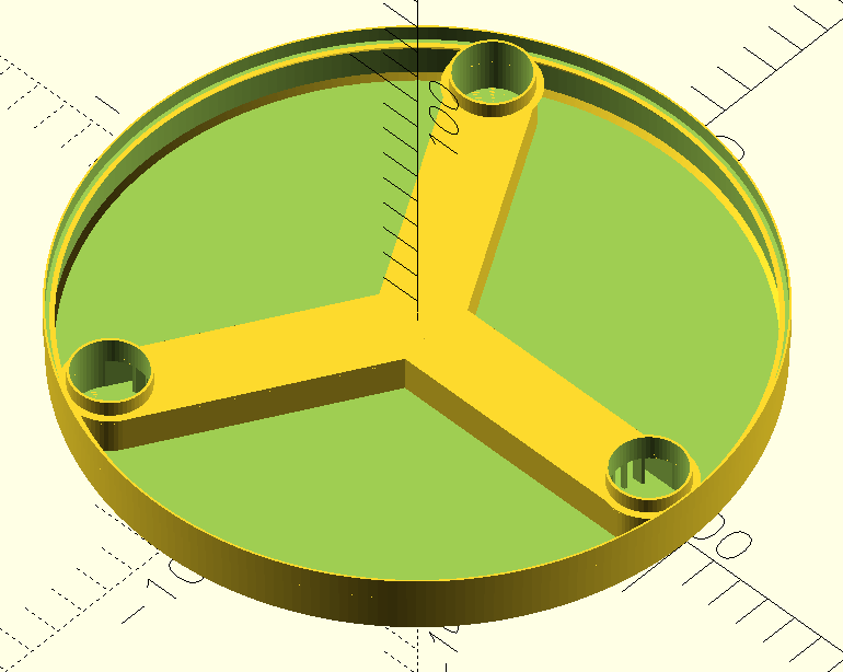

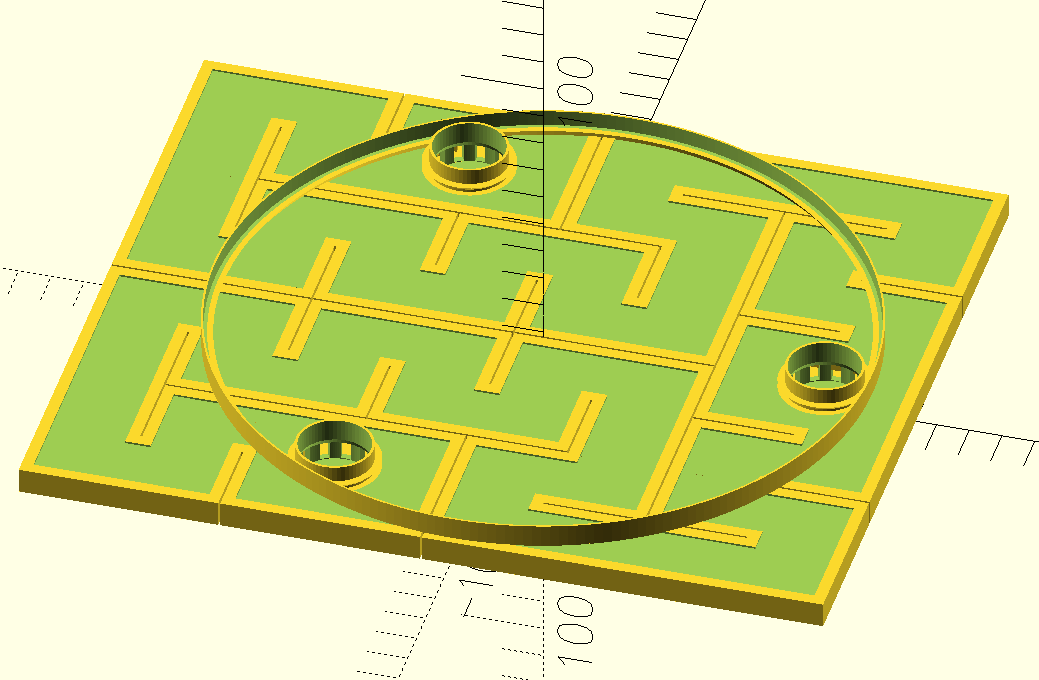

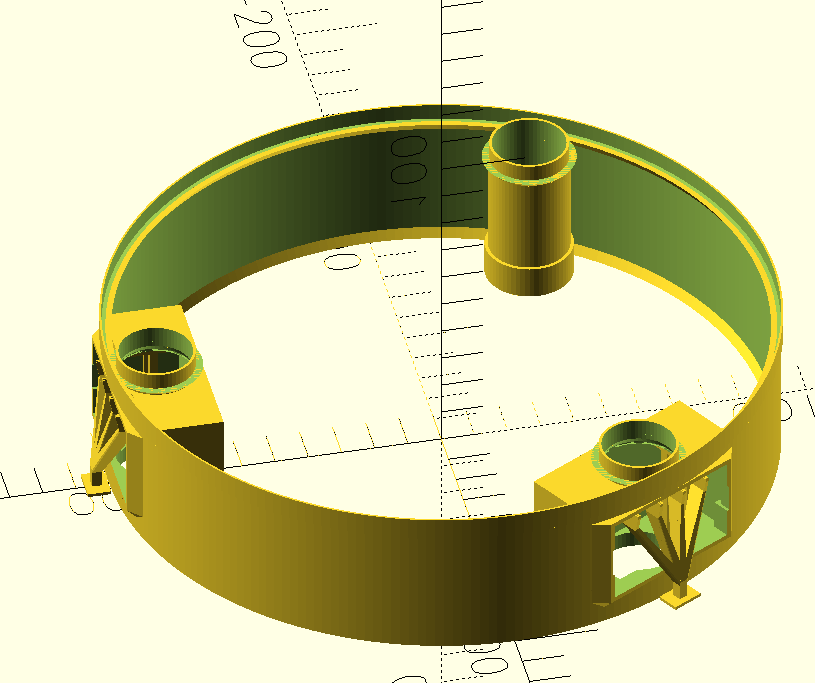

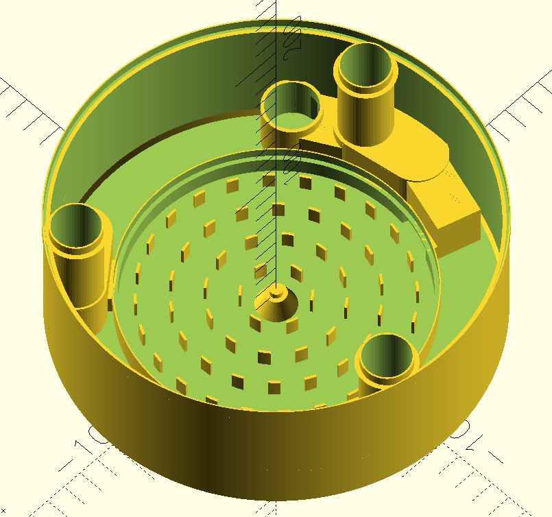

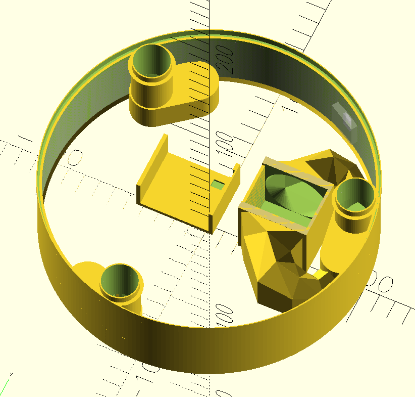

The three ducts are intended to have one flowing upward and two flowing downward.
Heater module
Blower module
Silica gel module
Base with elevated floor

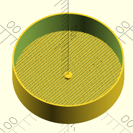

Canister with perforated floor

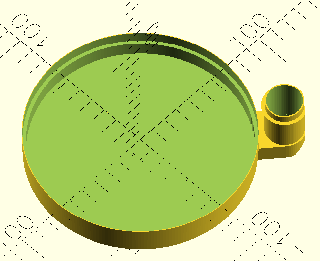

Lid with connecting duct
Sensor module
With supports included in the model

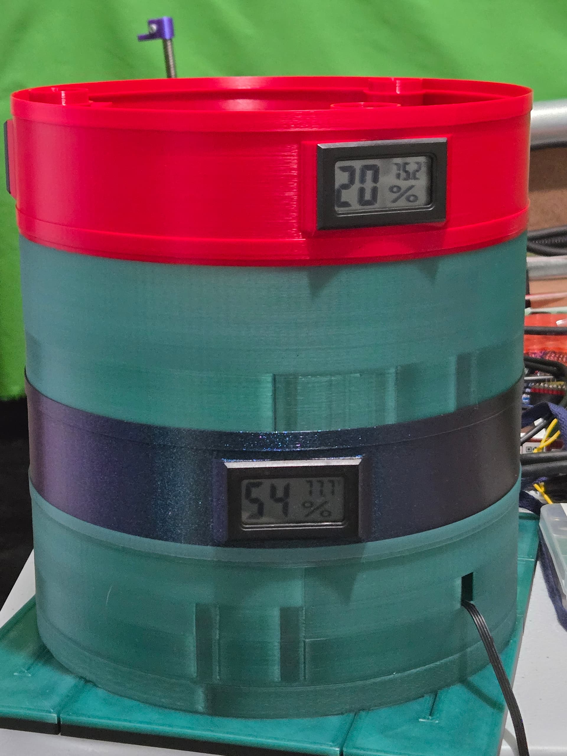

So the first picture was (from bottom to top):
Heat module on bottom (but not being heated)
Then blower module
Then sensor module
Then silica gel module
Then another sensor module
With the blower turned on, it pushes air through the bed of silica gel and the upper sensor reads lower humidity (and in this demo the dry air is just dumped into the room).

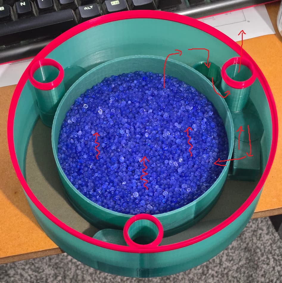

The airflow in the silica gel module flows up through the bottom, then through a duct into a sub-floor below the silica gel canister. Then it flows up (hopefully evenly through the entire area) through the silica gel, and then the lid redirects it downward into the internal output port where another duct directs it up again to the next module.

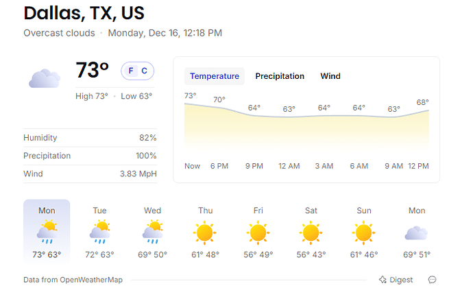

You must’ve just pulled something off of that upper module- no way it is 20% open air like that if the lower one is at 54% pulling ambient air.
(thinking about that- where did you get 54% ambient air in Colorado? It was below 20% over the weekend)
At any rate, that’s looking really great.
The chamber between the two sensors is silica gel, and air is being pushed through it. Here is the path:
The complex path in the middle is trying to illustrate the path through the silica gel, shown in more detail in the other post.
So the air after passing through the silica gel is dry, which is not too surprising. Evidently the air flow is slow enough to get a chance to dry pretty well in a single pass, but still fast enough to keep the sensor from seeing any of the ambient air right above it.
As for the ambient humidity, we’ve had a warm and wet spell the past couple days:
At the moment I am glad because it actually illustrates the desiccant doing something. A week ago it was colder and indoors was about 35% RH so it would have been less of a demonstration.
