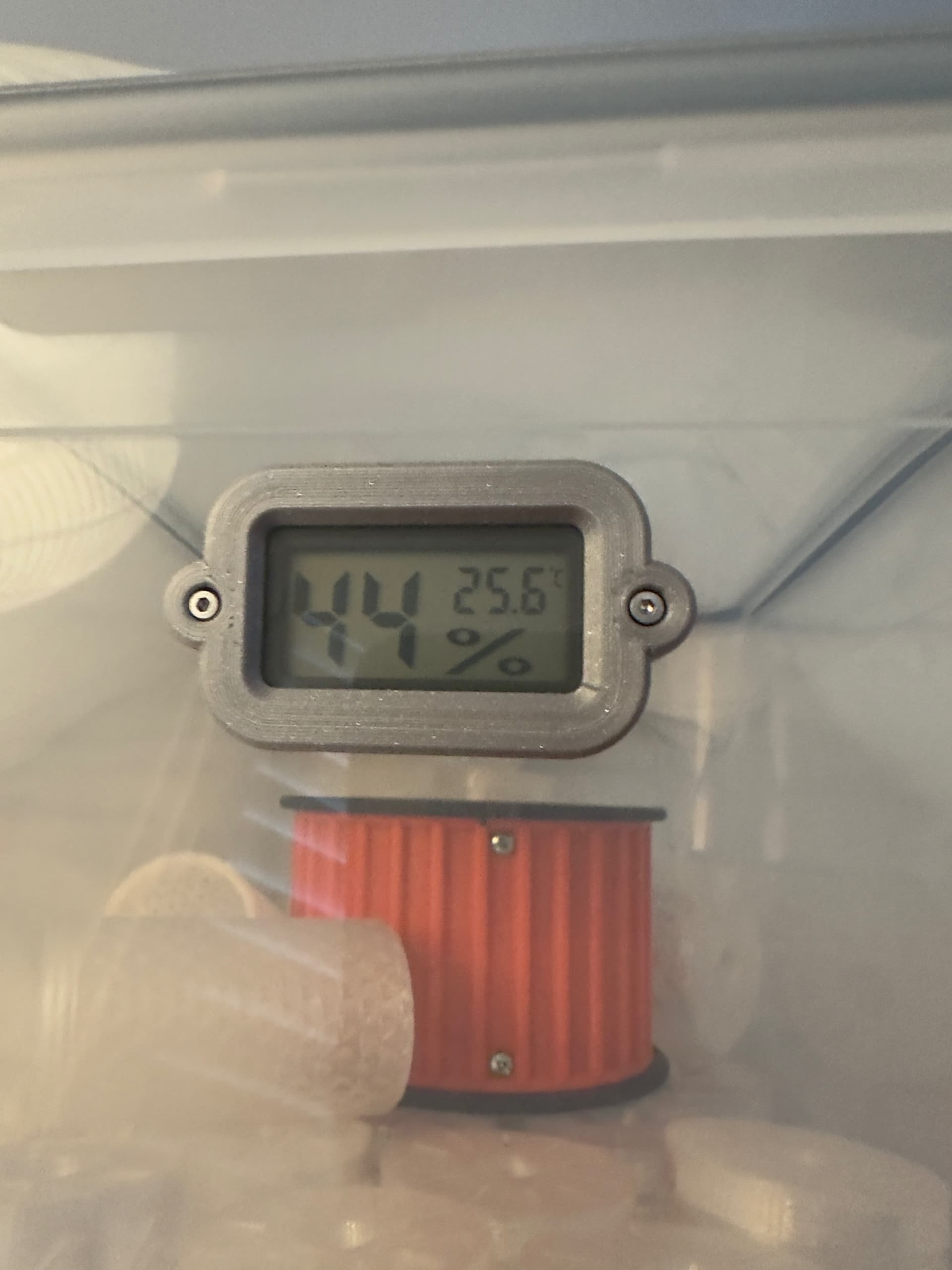

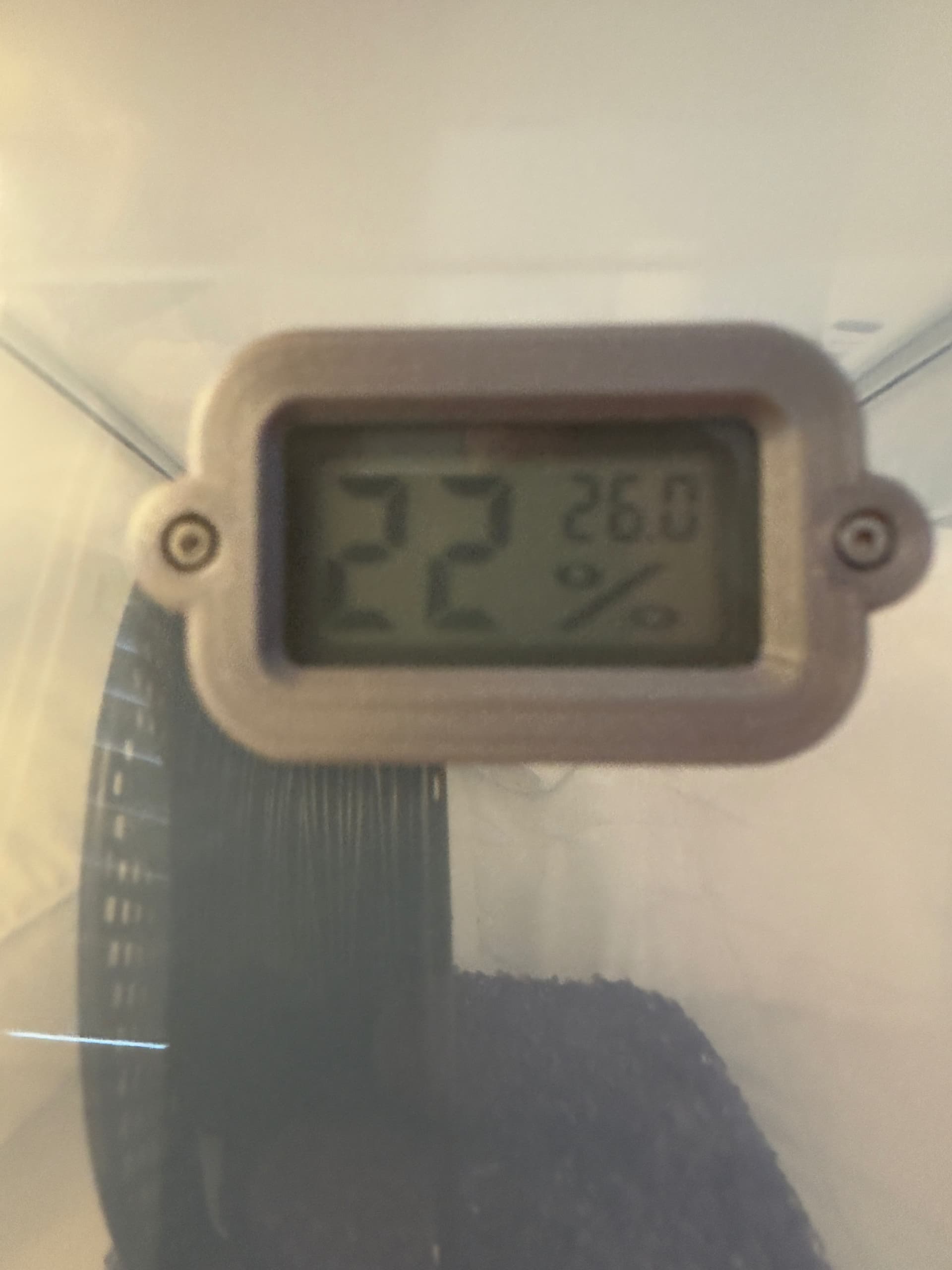

And here we go - one year later. On the left, the container which has 200 grams of dessicant got down to 11%RH a year ago and has not been opened in the meantime. The one on the right with 1KG has had a bit of use - probably opened a dozen times, it never read below 17%, I think because of the moisture in the filament in the box - so a 5% rise in a year isn’t too bad. Compare that with the boxes I have with 120gms of filament which are all around 65%, which I’m thinking the textbooks don’t consider to be “dry”.
All this shows is that the museum standards referred to above are not just guesses - if you want to keep things dry you need a big mass of dessicant.
I have been happily printing Prusa PLA without any drying issues, but other brands do suffer and PETG really needs love. I am guessing a neat compromise between having to recharge every few months and keeping stuff dryish will be to use around 500 gms per box. Would be nice to find a tin can with a screw lid so I can just bung them in the oven without any messy business though.
