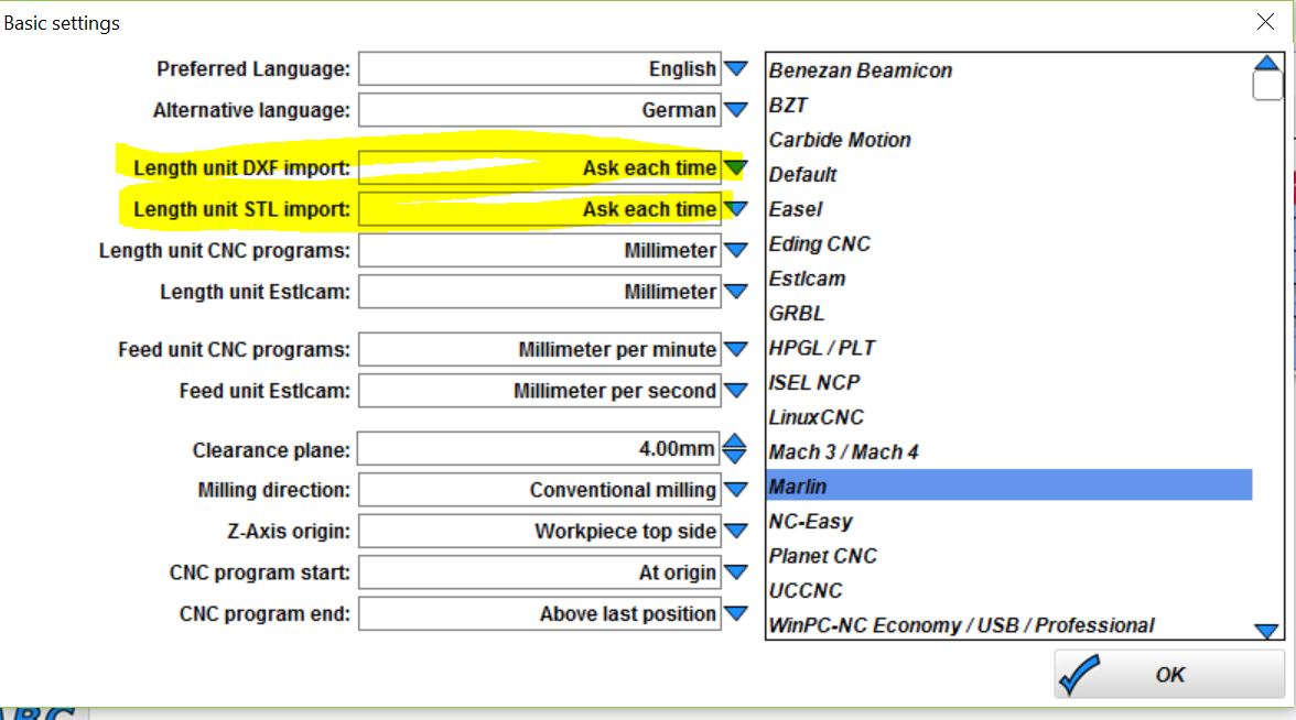

Let me jump in JimmyStanley,
I have a similar issue. By using the grid in Estlcam I can see that DXF and SVG files that I pull in are roughly 3.5 times the size that I created them in Inkscape. I have all of the document defaults set to mm for measurement in Inkscape.
I have used Inkscape to draw other projects for the laser in the past and scale has never been an issue.
Now I turn the grid, in Estlcam, on and resize everything that I bring in from Inkscape.
With all of the unit measures in document properties set to mm and mm settings in Estlcam where should I be looking for a solution?

I would start here.
