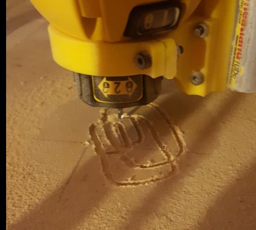

so i am a little confused. Vicious one, in your reply post
#17892 you show the settings you use in ESTLCAM and how you set up your Z stepper in 1/4. did you leave the other steppers in the stock configuration for 1/32 stepping like the 3d printing side, or did you change them as well. if so, what did you set them to? i tried setting mine to 1/8th on the xy steppers, and 1/4 on the z, but for some reason the movement between points on the XY axis is way off. (what im trying to say is that the cut on the XY axis is correct, but the travel distance is not. say for instance i wanted to cut two squares side by side, i cuts the first one the correct size, but then overlaps the 2nd square on top of the first at a slight off set) hope this makes sense, ill upload a pic as well.
Here is the pic, for some reason it didn’t include in my other post
