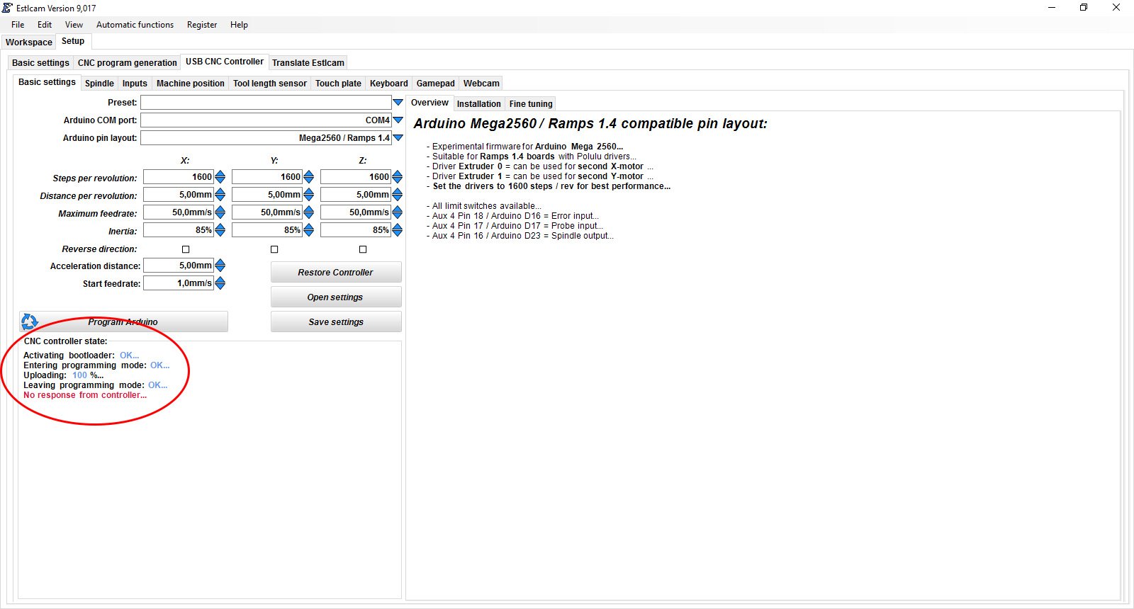

Hi
When I try to program arduino I get “No response from conreller” . Did anyone had this problem?
Hi Azmoo,
try to unplug and re plug the USB and try again… If this doesn’t help, what Arduino Board you are having? Genuine or some 3rd manufacturer board?

I have Chinese Arduino clone. I manage to get it working by pressing (press once) reset button (on the side of RAMPS) 2 sec after “Leaving programing mode:OK” appear. Also if you get error on activating bootloader you need to press reset button after you press “Program Arduino” button.
