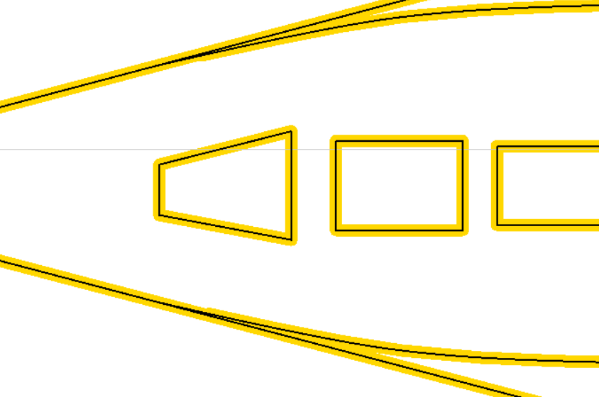

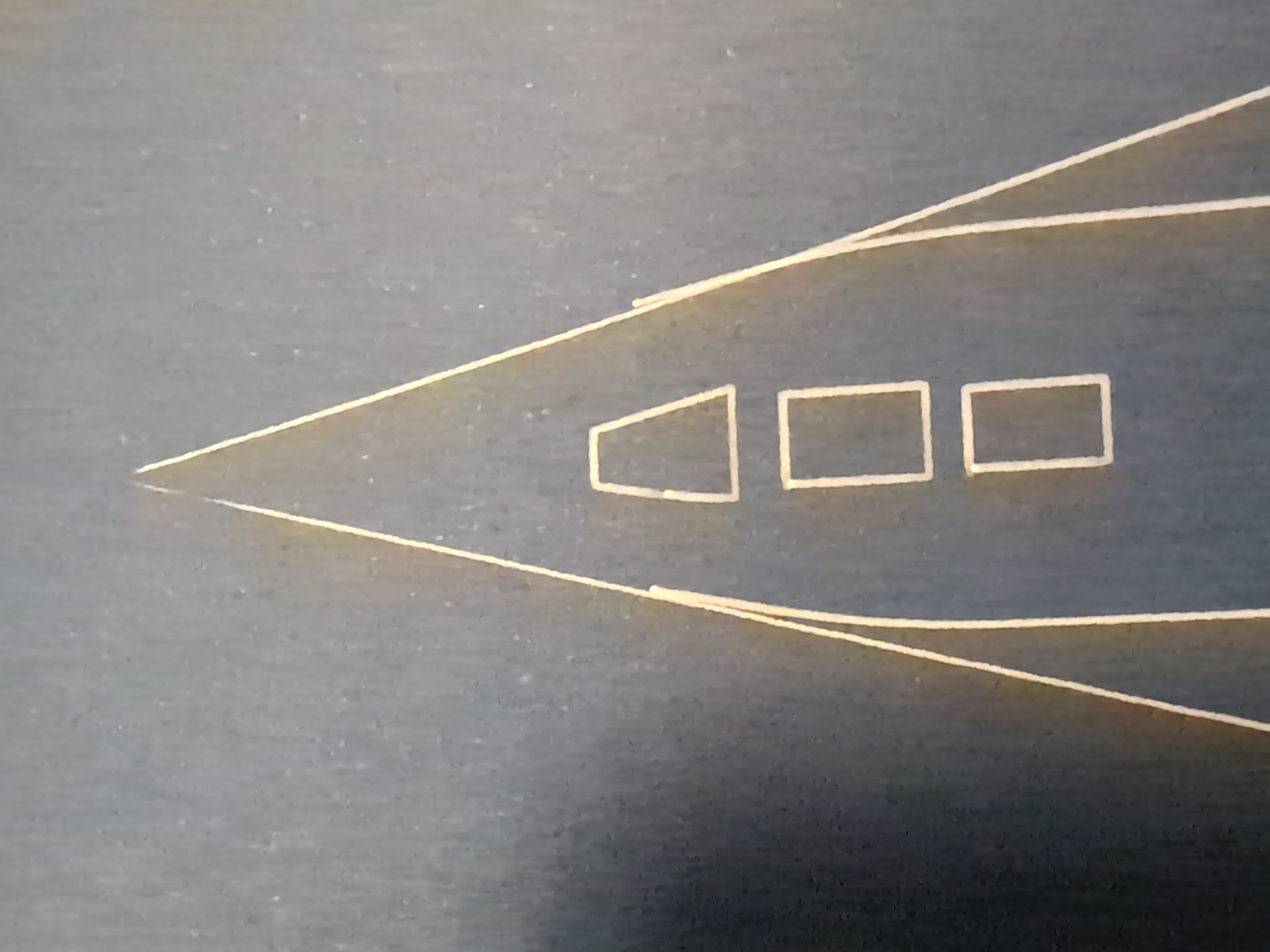

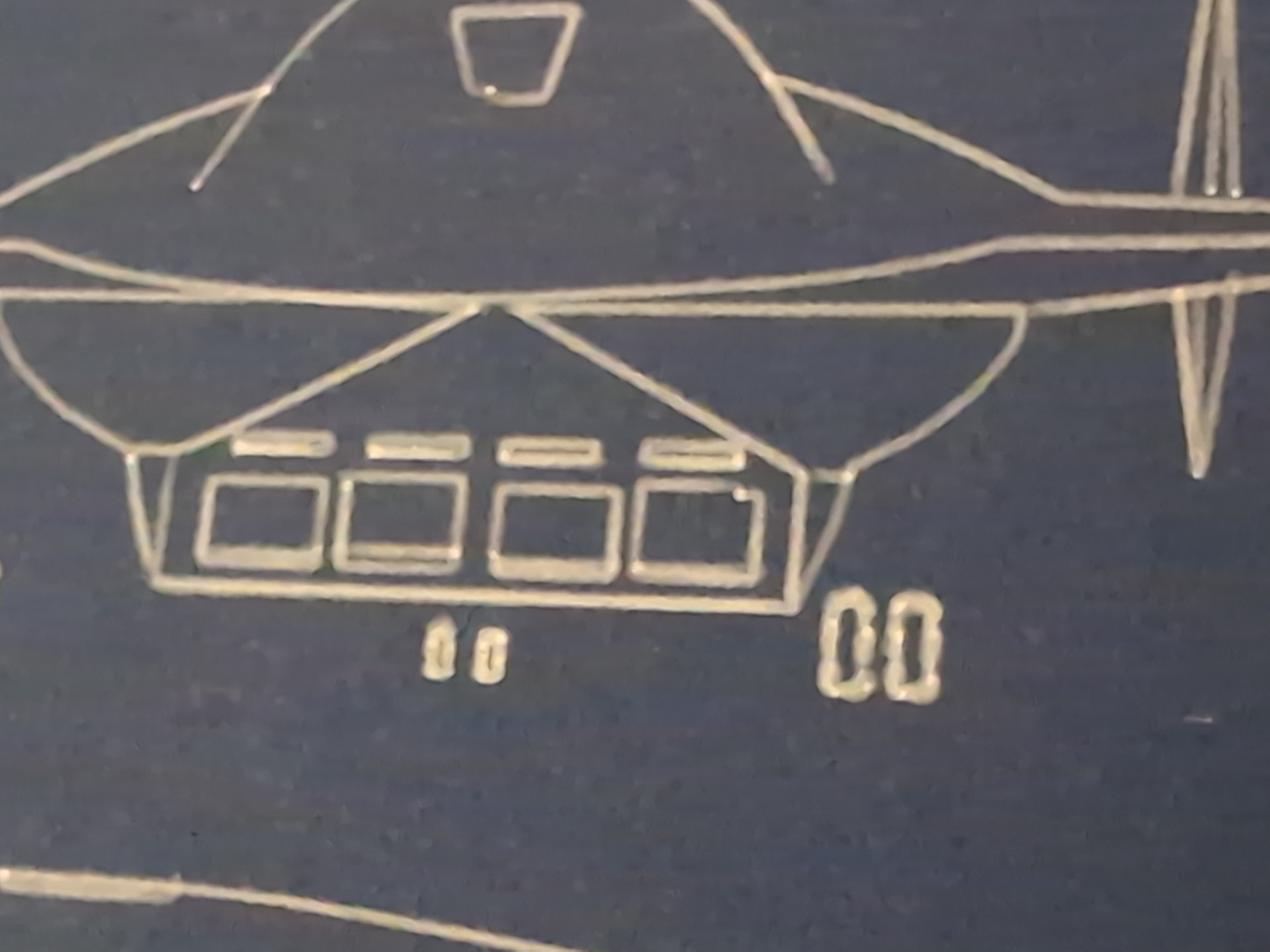

When I create engravings in EstlCAM, everything looks fine but parts of the image come out with errors. For example:
The curved bulges align well enough with the straight edges, but they’re offset by a mm or so. The bottom half of the trapezoid on the left has an offset for some reason, and the bottom left corners of the rectangles are offset as well.
The bottom of the trapezoid here is offset as well, the corner of the rectangle on the bottom right is offset but none of the others are offset, and only one of the rectangles has the 2nd line drawn on it.
The pen is on a spring mounted holder so it always has enough pressure to keep ink flowing. I’ve tried the plunge angle at 90 degrees, 1 degree, 15 degrees, and 89 degrees - it seems to replicate the same issues every time. I checked my belt tension and made SVGs of 20/50/100mm square patterns to test calibration - they all come out fine.

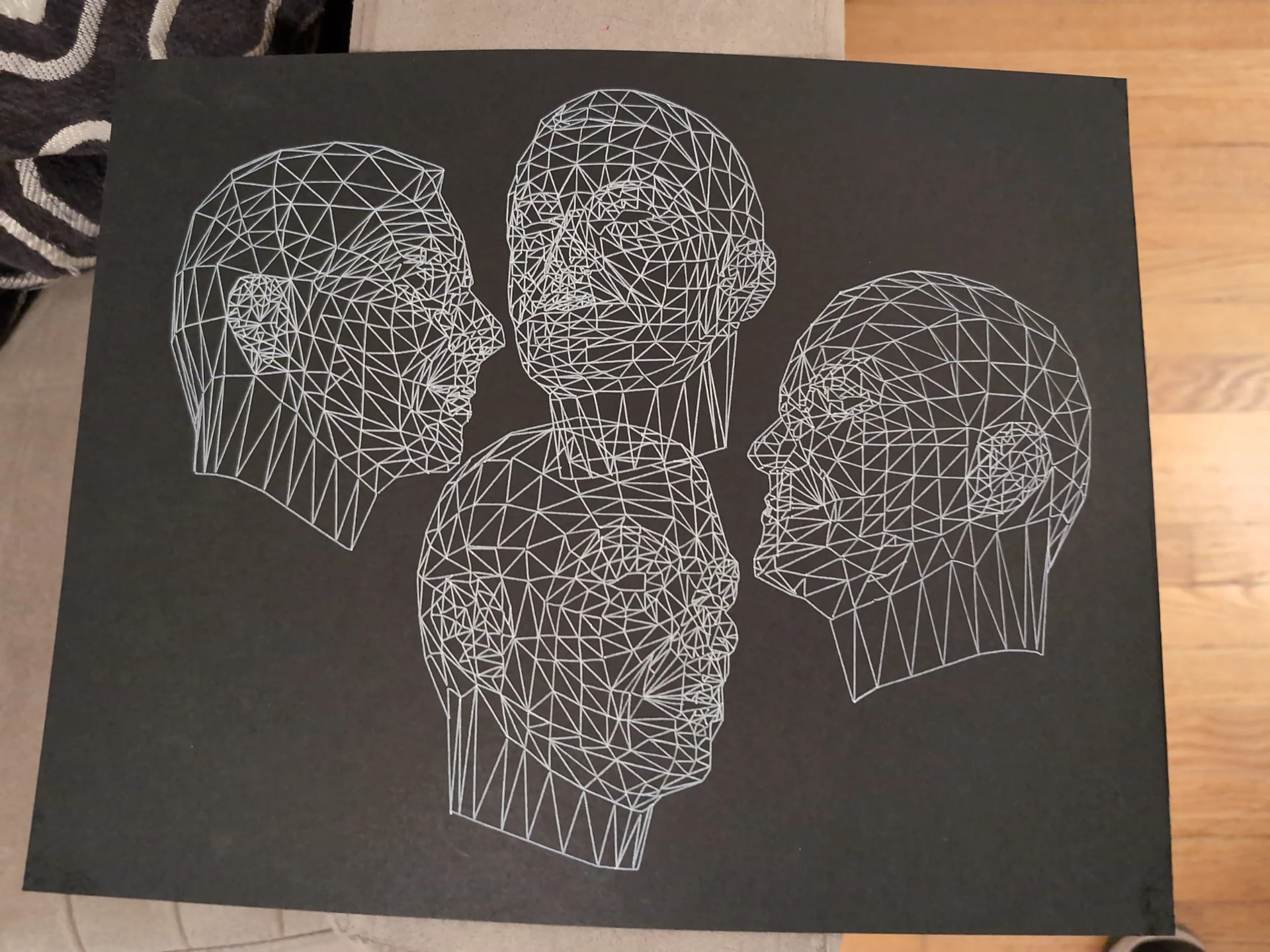

I had nothing but success with another SVG I made - the lines all draw as they should. It’s a completely different SVG so it’s not exactly apples to apples, but I honestly don’t know how to fix the blueprints.

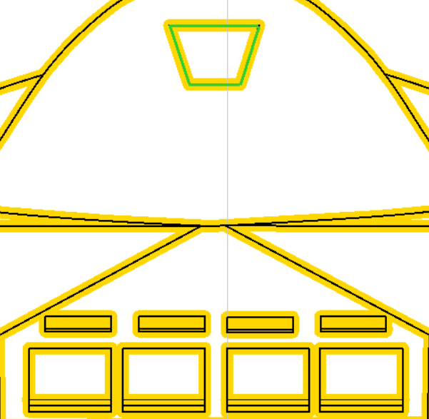

Use the Preview tool to view the G-code paths. If the pen drawn paths don’t match the G-code paths it’s a mechanical issue. Either the pen is moving/flexing and/or steps are being lost. With no knowledge of the machining order it’s hard to know, but the equally offset lines in the first image looks like step loss…
Estlcam likes starting in the corners where direction change/acceleration might be causing those corner jogs. You could try setting start points in the middle of straight sections using Manual shape detection.

The preview paths match where I want the pen to go, the slip happens when it actually runs the plotter job.

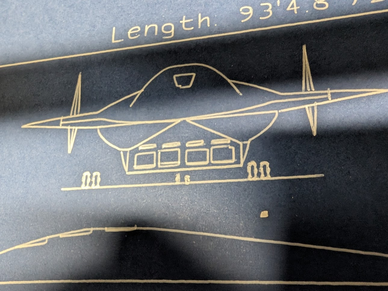

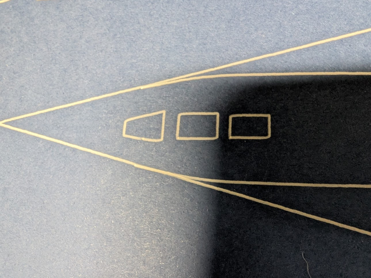

Tried with yours + no changes to the gcode. It’s set to plunge 0.5mm, Fxy and Fz speed are both 5mm/sec, and unfortunately the issues recur but in different amounts of offset, plus the corners somehow get a bit beveled:
The pen mount also doesn’t flex enough to account for surface height variations - other parts of the plotted results were dug so far in that it almost tore through the paper, others were on higher parts so that the pen was too low during moves. I can account for those in the start height for the engraving steps in question but it seems like lateral pen movement isn’t the only culprit here.

…Missed the new posts, 300mm/min and the weirdly consistent jogs/offset in that last image rule out step loss.
