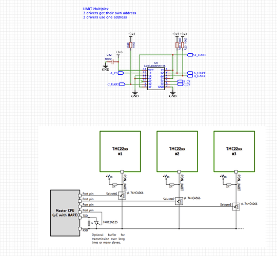

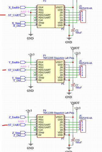

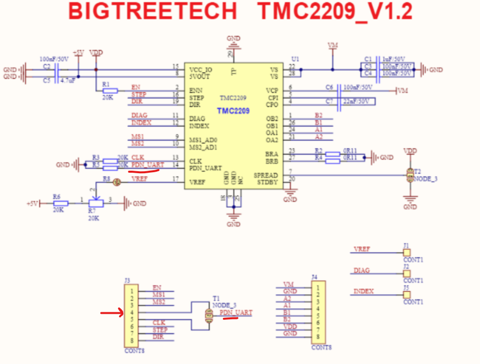

So if the ST_UART line goes into the first three drivers and when they are populated, that is 3-20k pulldowns. Does that help in balancing the R8 resistor?
3x20k resistors in parallel =6k

If I change out the R8, 10k no change, 14.66k and above the esp32 fully boots but there is no UART communication.
The 1k pullup makes the UART coms stop working at 5.86k and above. (actually at 5.86k only y2 and z2 work XYZ no go). Above that none work.

There’s something about those TMCs and their communication bus that is interesting here and we must not be understanding properly. That must relate to why after 3 TMC2209s for X/Y/Z , the 4th through 6th get the mux treatment. I looked over the Jackpot schematic again, and I realized that the lower portion I’m quoting is a screenshot from somewhere and not actually a part of the design.
Jackpot doesn’t have 74HCT4066s nor the 74HC1G125. That’s noted as optional, but it is at least instructive about the UART communications.
The reference embedded in the lower part is not how the Jackpot is connected. My gut says that after 3 UARTs bussed together either UART comm or ESP32 boot behavior became unreliable and thus the addition of that mux. We’ve rediscovered the boot reliability issue.
The muxing seems like an attempt not to need another GPIO expansion to be able to talk to each TMC one at a time. It seems pretty messy.

The esp needs to put settings on each one individually. They may have only three configurable addresses. Or they have timing requirements that get too tight for 6 drivers. I definitely haven’t looked into it. The skr boards are another possible design to look at.
AFAIK, Ryan is the only one using the boot pin. So this isn’t the reason there is a mux. I was going to suggest we swap pins around to avoid pin0. But at this point, it is the devil we know. It may be better to use it as a pin we can keep tightly controlled. Moving it to some spindle output would be easier today, but cause issues for users down the road.
