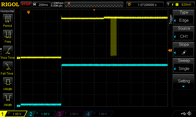

To see that much common mode noise on just that example was really surprising.
Was the USB-C cable disconnected for this test from the host? Just the USB-C board in the jackpot?
Yellow is boot0, right? After FluidNC is up and running, it has to talk to the TMC2209s.
If you zoom out in time on the genuine board, you have to see that communication or I don’t see how FluidNC would be able to control the 2209s.

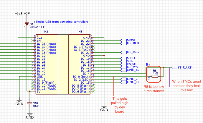

The genuine esp do not fully boot when they are plugged into the jackpot unless they have a terminal opened. Even without drivers on the board.

The boot pin really does not look to be getting pulled up high enough. I am going to try two quick test. BRB

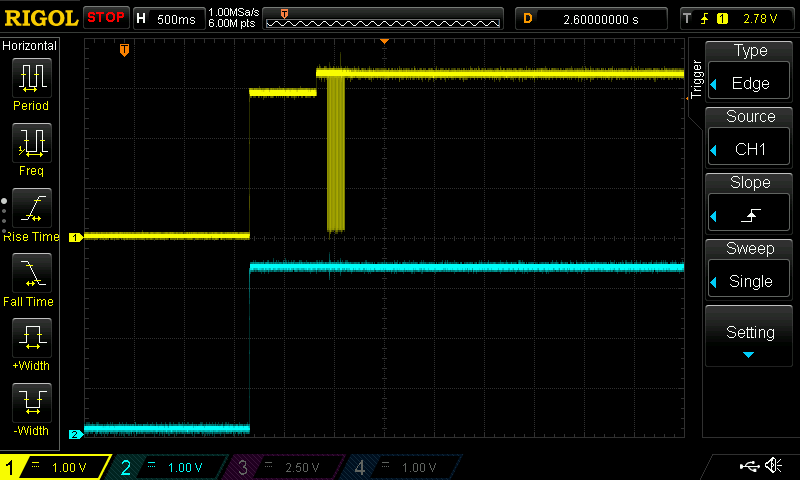

10k pull up didn’t work.
Looks pretty familiar with a 1k pull up though…
The 10k only lets it get up to about 2.8V and that is not enough to boot.
The 1k resistor pulls it all the way to ~3.2V
We’ll figure it out.
Nothing in there looks like an obvious reason for no-boot.
This is why R8 and leakage in the 2209s
Edit to add- this is also why more than one 2209 in X,Y,Z is a no-boot while empty or only 1 will boot.
Less leakage from the 2209s.
Edit2- it may not be a stronger pull up you need. It might be a higher value R8. See what 10k does…

So everything looks good with a 1k pullup (and they all boot and work)I ran steppers on each of those.
Well that was easy. Put a 1k pull up on the next jackpot. Will want to optimize R8 still.

Common mode noise is much better in that shot vs the no pullup. This makes all ESP32 dev boards viable, at least for this problem.
I noticed that as well. They all look pretty identical on my end. (sorry I changed the time per div, it slowed down a bit with the drivers and steppers in)
