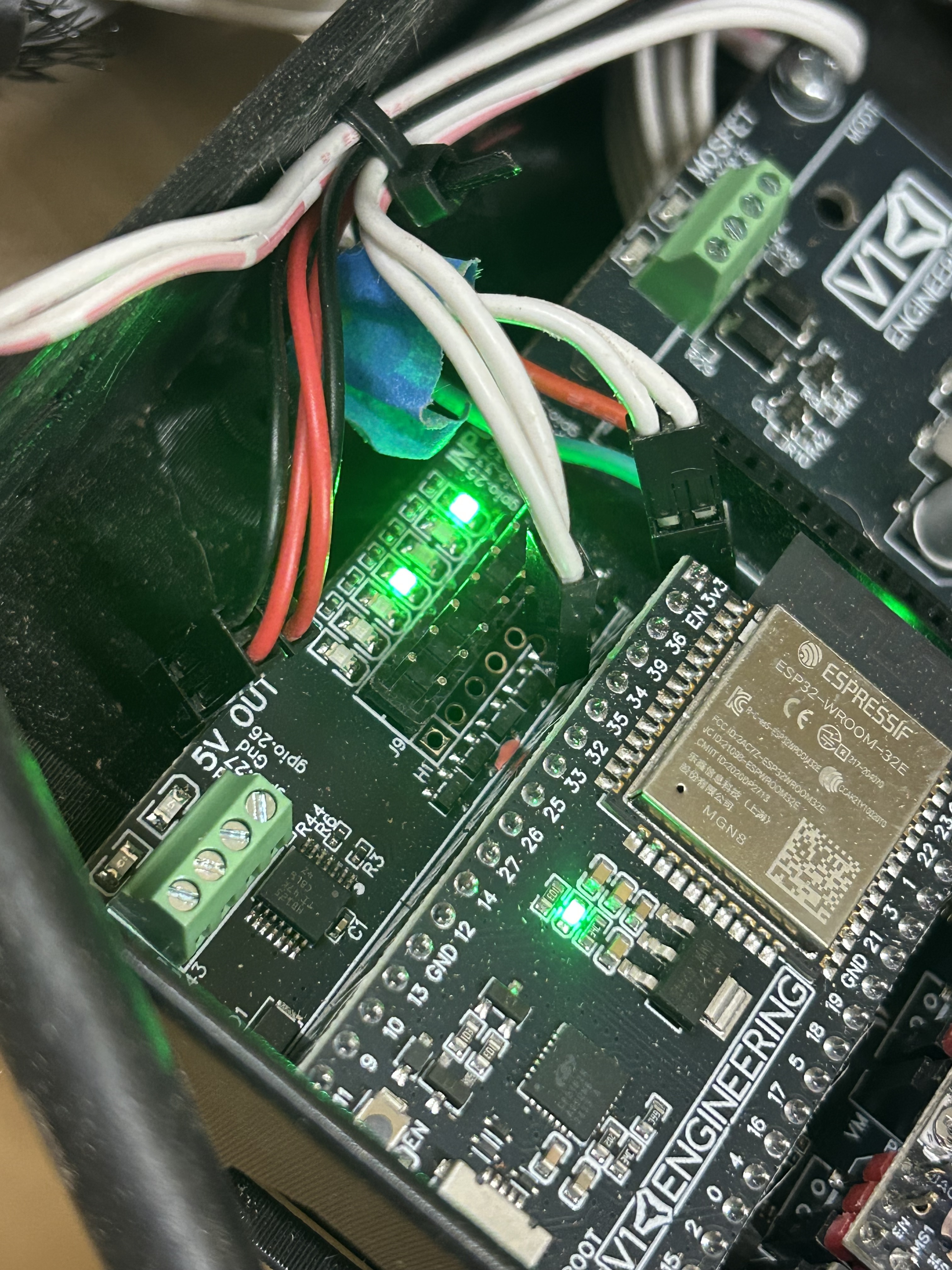

I recently finished my Lowriderv4 with the Jackpot and it’s been working like a charm without issue. Today when I went to home my machine the y1 endstop never triggered. I validated all my connections. I also validated that my connection to my motherboard worked by putting my y1 header onto another pin and it works just fine. I also tried another endstop on the y1 port and it did nothing. This pin is stuck In a triggered state. If I spam the end stop, you can see it lightly flash, but it doesn’t actually send any information to the controller. It worked absolutely fine yesterday. I’ve done a full layer one sweep and I don’t even see any damage on the board and I know for a fact my connections are sound. My vacuum hose is also grounded so I would be shocked if this was an ESD condition.
Any tips? I am new to the jackpot board. I am hoping the board isn’t damaged. I did find it interesting that the pin in question is lit up even when nothing is plugged into it. The other endstop pins do not behave like that. I also reseated everything including the ESP32. Should I flash my firmware? I bought this from Ryans’s site several months ago before I got around to building the CNC, so it came pre flashed. Here’s a picture of the pin lit up. Again, I have validated my y1 connection works by trying it on the other pins. The issue is isolated specifically to this pin, and none of the other endstop will trigger it either.

You have done the right troubleshooting to narrow this down to a specific port on the jackpot.
Options for you are to move the endstop to one of the spare pins (edit your config.yaml to match), or you could try swapping in another ESP-32. If it is an ESD hit on the ESP-32, then a replacement will fix it. If it is a blown endstop location on the jackpot, then the ESP-32 won’t help. Since ESP-32s are so inepensive, it’s probably good to have a spare anyway.
We should still try to figure out the details of your setup so you don’t end up blowing the next pin location.

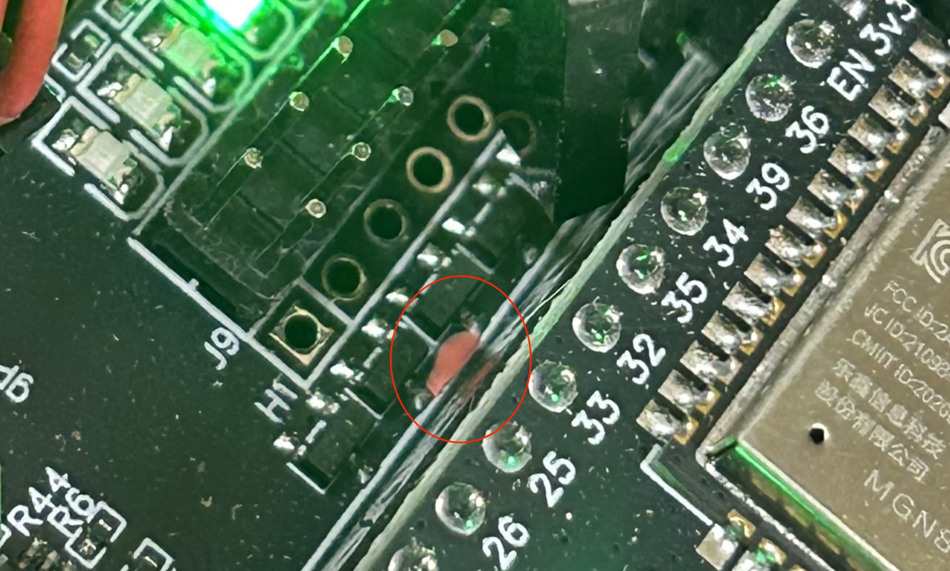

Edit: What is the shmutz shown in the circled area from your board picture?

That shmutz was a piece of wire from when I was stripping wire that I have since removed.

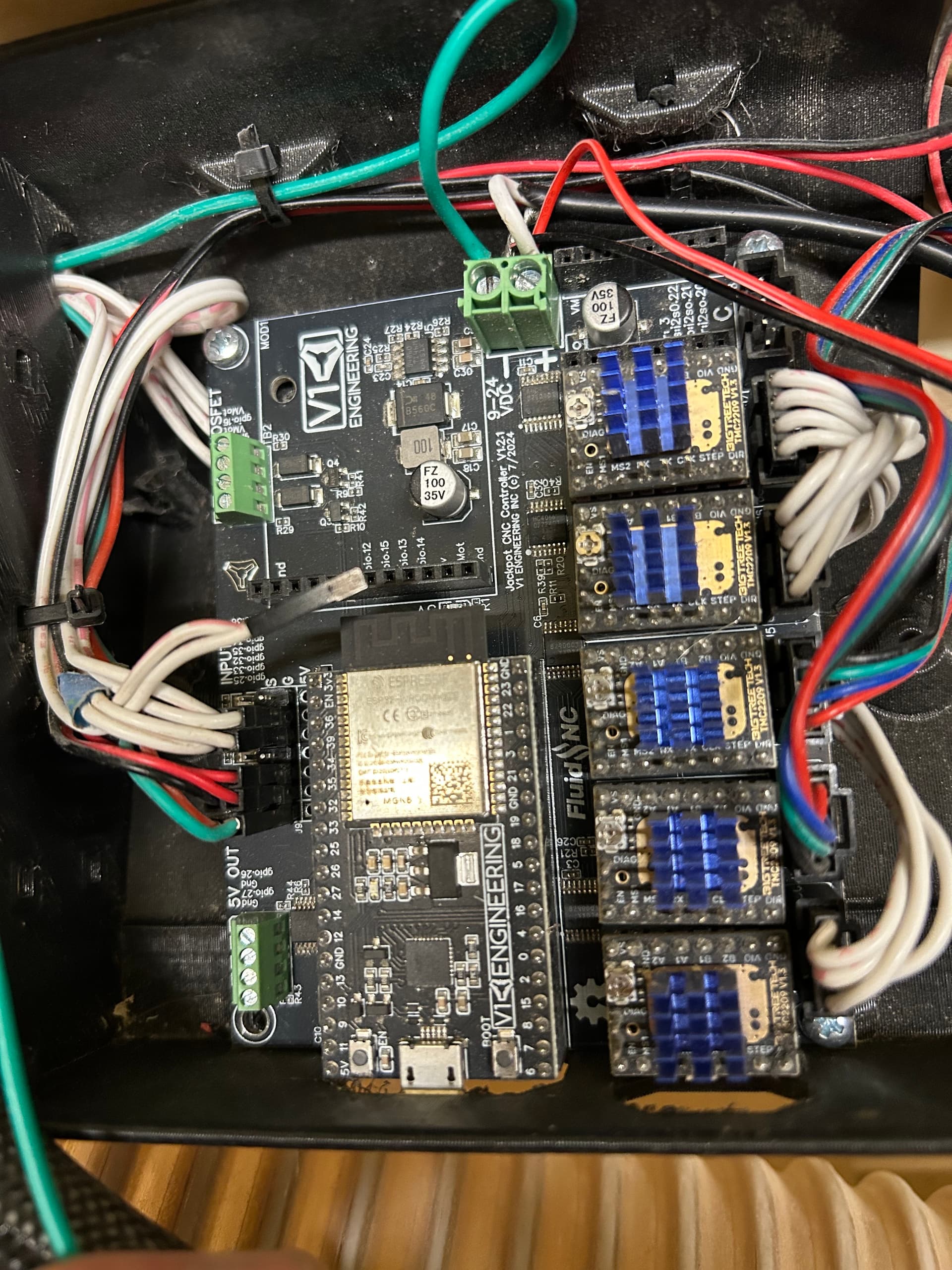

Let’s see a picture of your board wired up.
Do you have your Vac hose grounded?

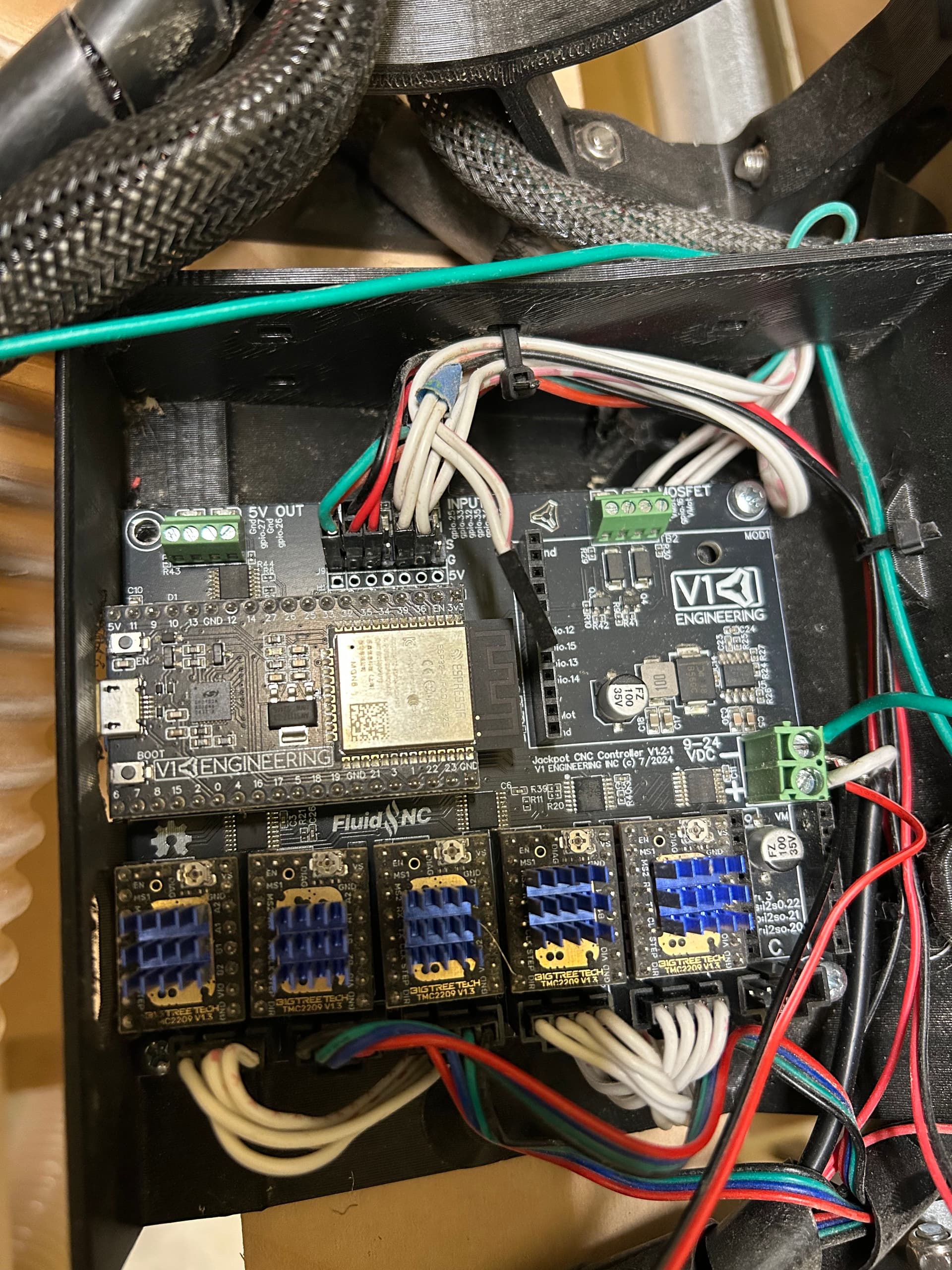

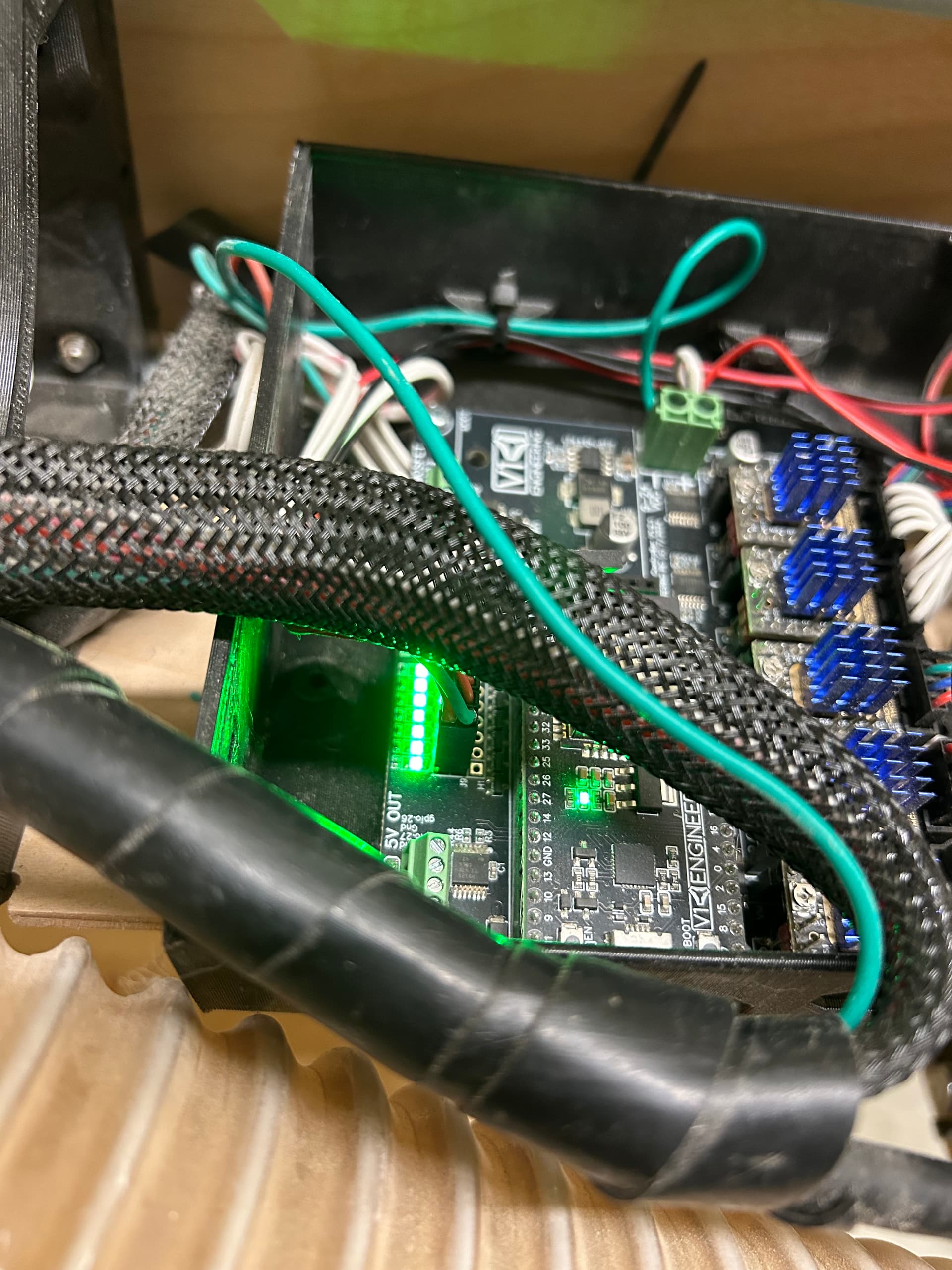

Here are a few pics. Yes, I have my vac hose grounded as well as my fan.

What is that green wire grounding?
I do not! That is the ground wire from my vacuum. I attached it to the metal rib to the ground port on the board.
do you have a reference you can point me to for conducting the repair? The guns don’t seem to be that expensive and I’m all for trying something new and acquiring a new skill
That goes to your wall power ground not directly to your sensitive control board.
Chances are really good we found the cause.

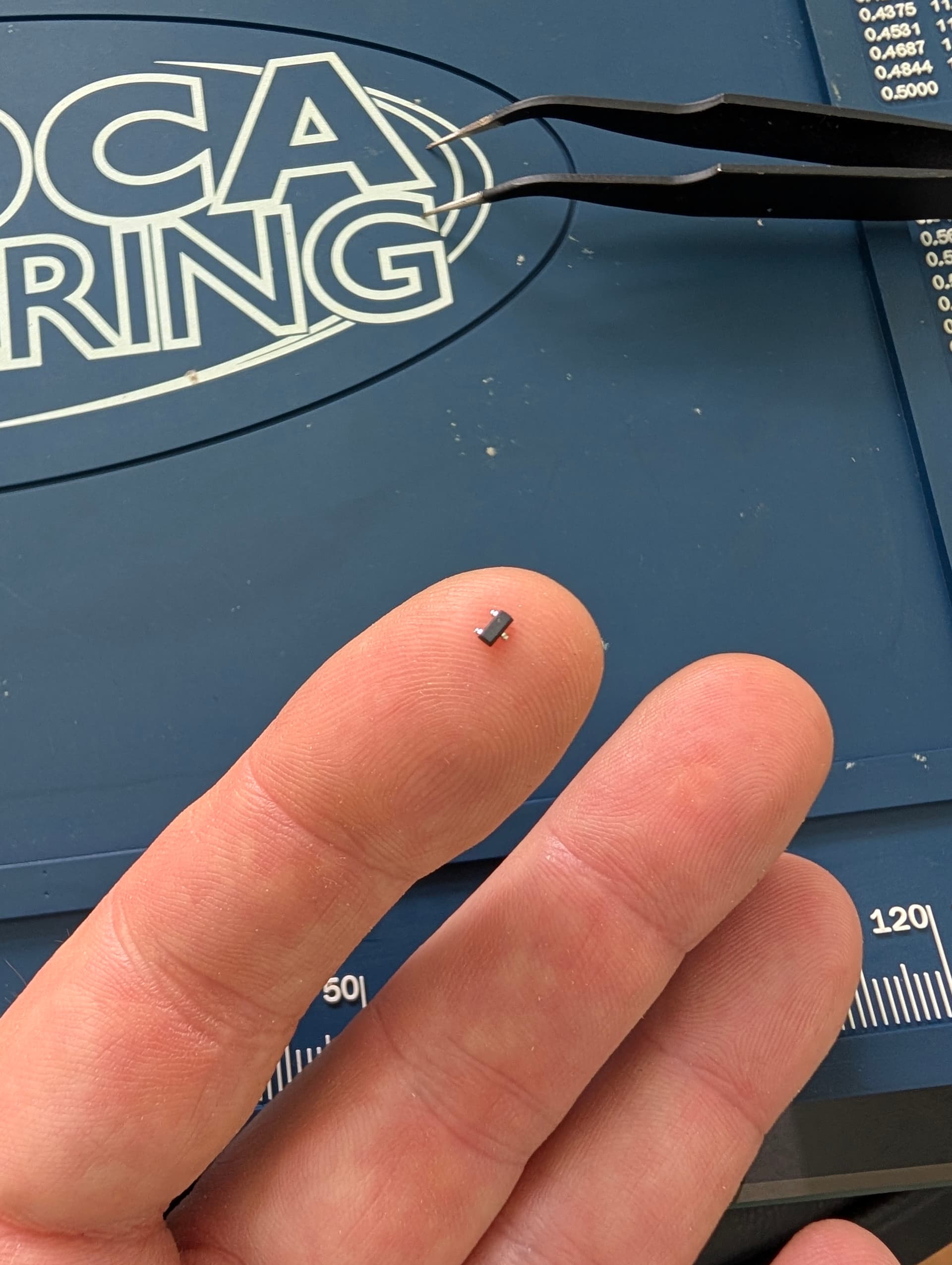

Here is the component that gets swapped out.
Well, that would make sense. my intentions were good :joy:
Not a huge deal, nothing too bad was lost. Now we know the Jackpot is a bit more robust than anticipated as that static charge can get massive. We can replace the components, or you can add a fluidnc input module, or..you can use the naked inputs from the module port. If you want to swap them out, Private message me here, and I can give you all the info on where to send the board and return label.
