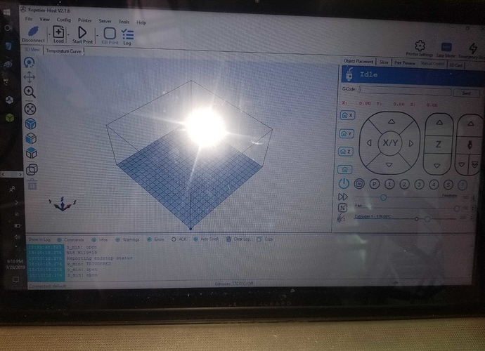

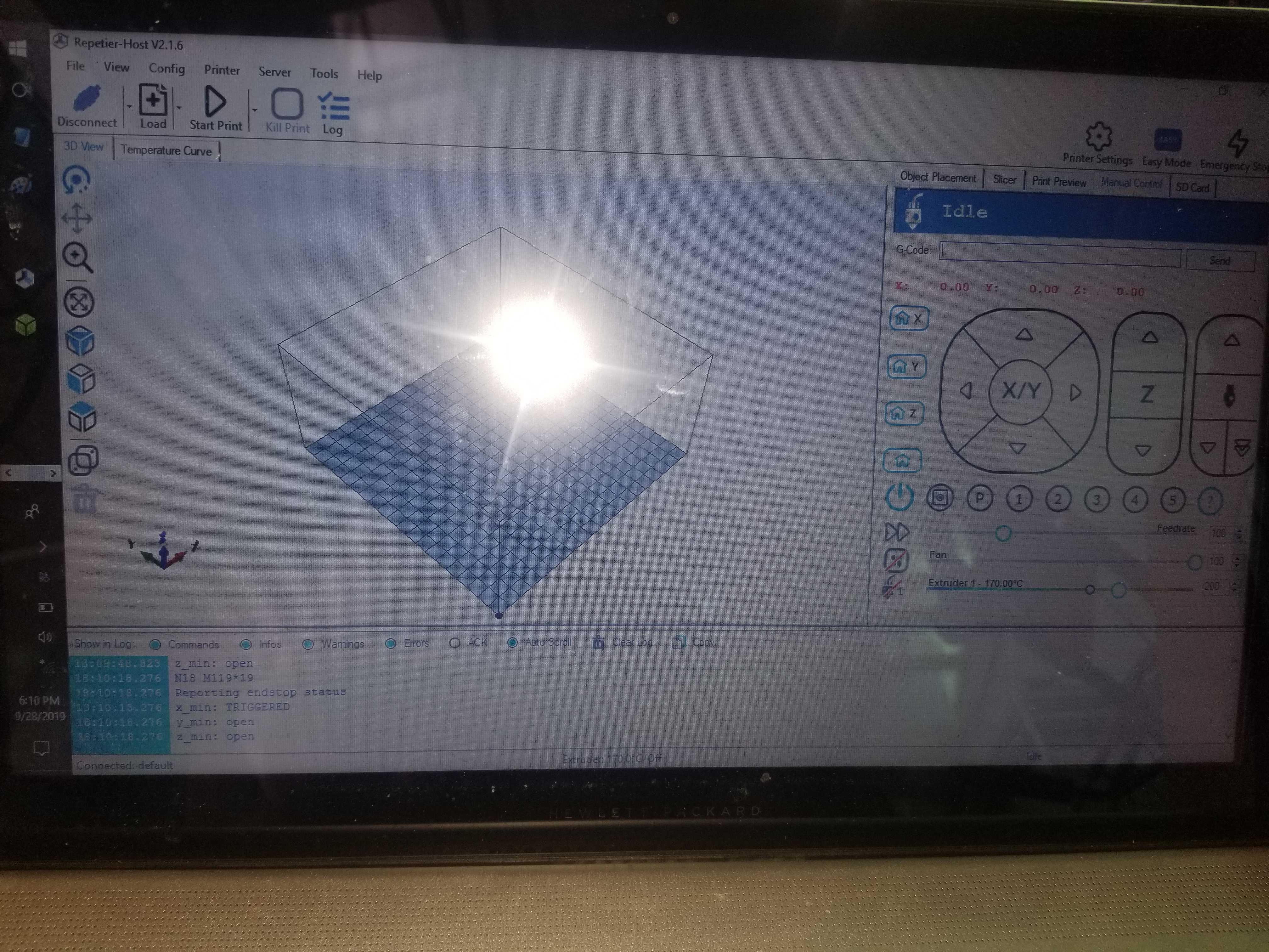

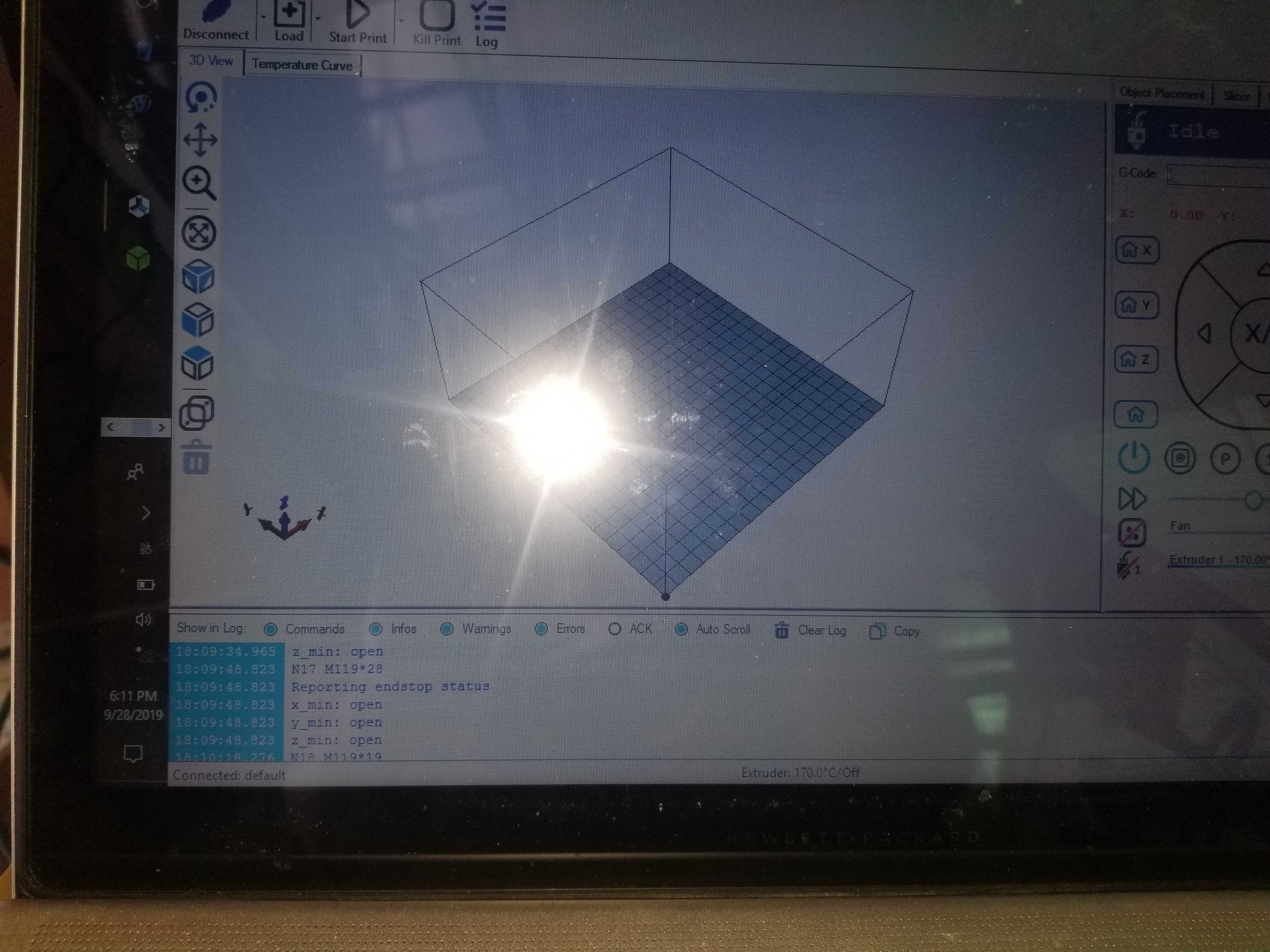

According to the repetier software my limit switches are “open” and wired with white wire on lever end side, black on lever attachment side of my limit switches. While the x-axis wiring is normally triggered and when pressed is “open”… so any recommendations are appreciated… I don’t see the x2_min and y2_min with the M119 command on Repetier…
The repetier software is only reporting what Marlin is saying. If Marlin is not reporting the x2_min and y2_min, then Marlin isn’t configured for dual endstops. You’ll need to flash with the dual endstop firmware, then M119 in repetier will show x2_min and y2_min.
If you want to just debug the first two endstops, then you’re doing it right. M119 should show OPEN when it’s not pressed and TRIGGERED when they are.
After you flash a dual endstop version of Marlin, you’ll see x2_min and y2_min in the results from the M119 and you can make sure they are also OPEN when they aren’t pressed and TRIGGERED when they are pressed.
Jeffeb3,
What you’re saying makes sense. My issue I’m worried about is my Xmin is “triggered” when not pressed, when I press down on the trigger it says “open” I don’t think it’s easy to infer by the pictures I posted earlier…
Not touching:
X=“triggered”
Y=open
Z=open
Pressing down X limit switch arm:
X=open
Y=open
Z=open
…maybe reflashing marlin will help… I’m still worried I wrecked something internally when I wired my “±” instead of “-S”.

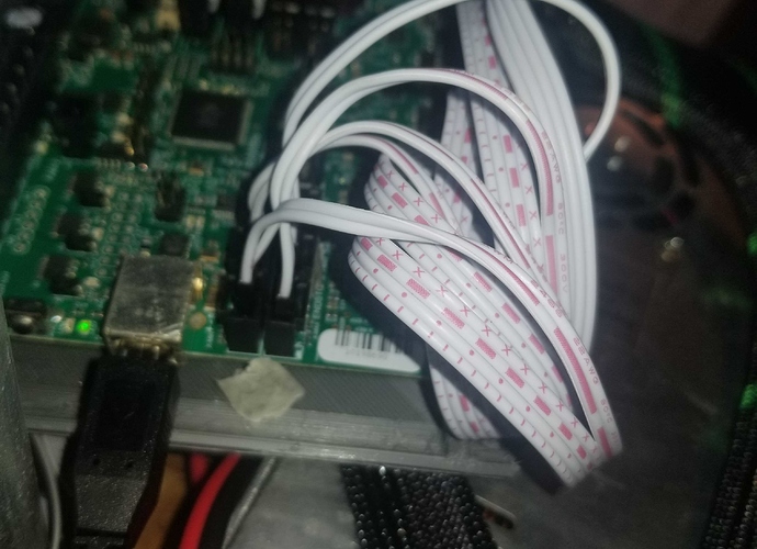

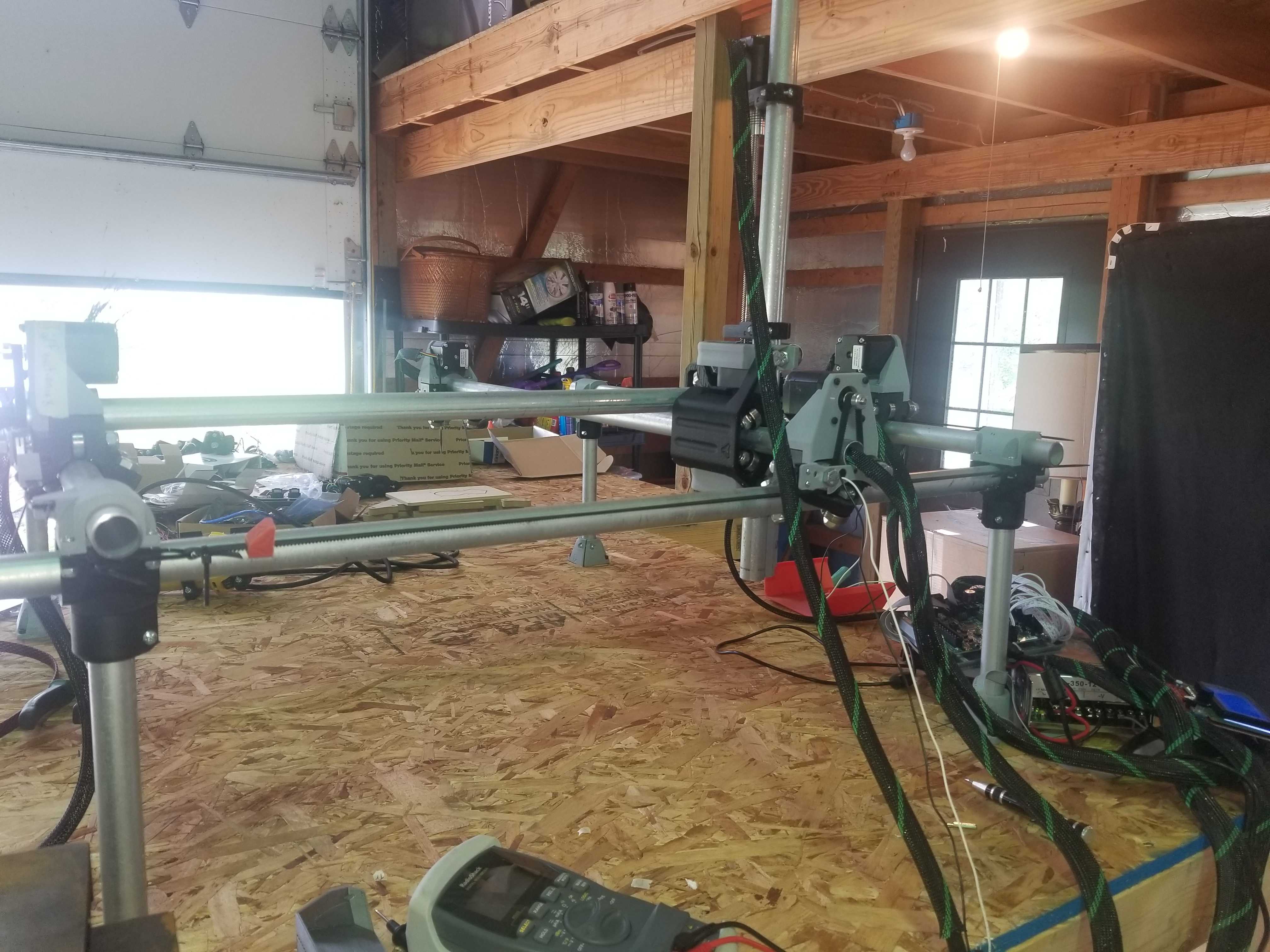

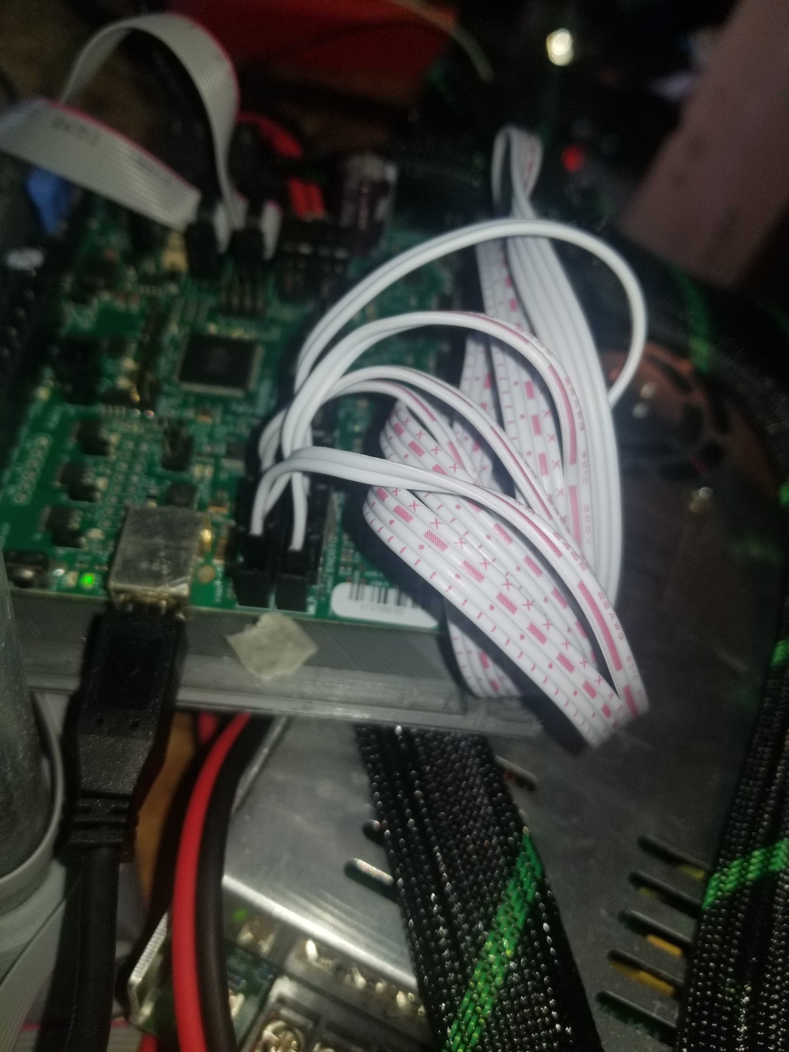

Give us some pictures showing the wires and the end stop switch.

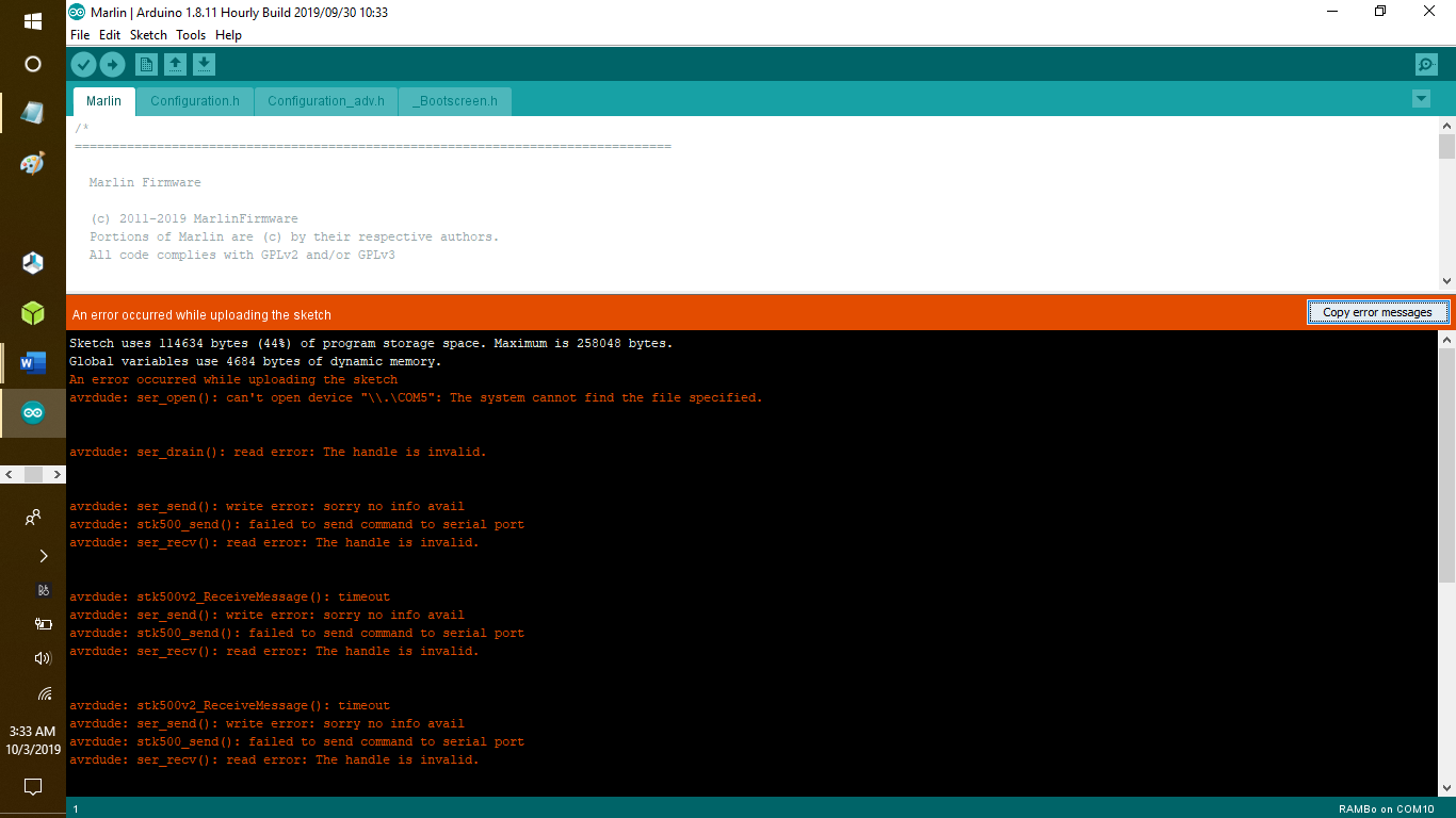

I apologize for no pics at the moment. I’ll try to submit pictures of my troubleshooting efforts when I have more time later this week/end so what I’m typing makes more sense…
Attached is my current issue with uploading MPCNC Marlin Version Firmware to my Rambo from laptop. I may be having com port issues (not sure) based on issues I had with Repetier… I should be able to upload more relevant pics by Saturday regarding repetier signal logs and comm connections while attempting to run commands…
If there’s another thread someone recommends I read into please msg me a link regarding the resolution of a similar problem as mine… thank you!
That looks like generic can’t connect errors. I’m not very versed in windows troubleshooting. I know the rambo needs a driver in windows. Otherwise, make sure you’ve picked the right port and have a good usb cable.
Try the current version of Arduino the hourly’s are super finicky.

Using Port : /dev/ttyACM0
Using Programmer : wiring
Overriding Baud Rate : 115200
avrdude: ser_open(): can’t open device “/dev/ttyACM0”: Permission denied
ioctl(“TIOCMGET”): Inappropriate ioctl for device
avrdude: ser_send(): write error: Bad file descriptor
avrdude: stk500_send(): failed to send command to serial port
avrdude: stk500v2_ReceiveMessage(): timeout
avrdude: stk500v2_getsync(): timeout communicating with programmer
avrdude done. Thank you.
the selected serial port
does not exist or your board is not connected
There’s your problem.
sudo chown yourusername /dev/ttyACMo
If that doesn’t work,
sudo chmod 777 /dev/ttyACM0
My tty devices show up with the dialout group. I just add myself to dialout
sudo usermod -a -G dialout chas
Jeffeb3 is smarter than me. I just brute force my way around linux.
I made a career out of stumbling around various bits of tech. From open-reel mag-tape drives in high school (summer job) to COBOL on an AS/400 (for a hospital; I managed to change prices on all their line items once) to eCommerce in ColdFusion (which I faked using my college Java as a guide) to embedded Windows CE and hardware QA (they were desperate) and now financial QA (whee! I get to poke around in DB2 servers trying to figure out how a global company stores its financial transactions)…
Jeffeb3 isn’t necessarily smarter than you, he’s just pulled that particular wool over someones eyes before… :wink:
No, I definitely did the sudo chmod trick a couple of dozen times in a day before I googled for a way to make it permanent. Whatever works.
sudo chown yourusername /dev/ttyACMo [needs to be ‘zero’]
These two commands seemed to work… my new board was flashed with a cool output process… my laptop froze before the 2nd board(old) could be flashed… restarted laptop and got a short summary of the board being flashed (different?) anyways I will try both boards and update how setup worked… thanks you guys! I’ll try to fill you in if I got the rambo to run repetier!
