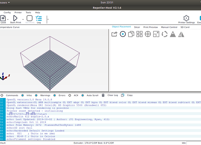

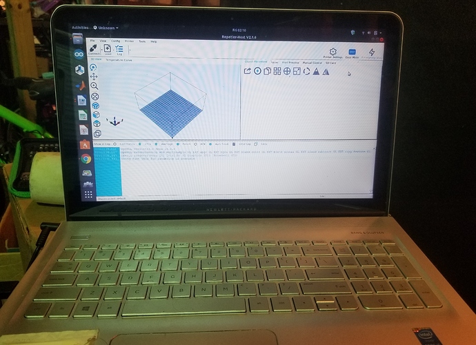

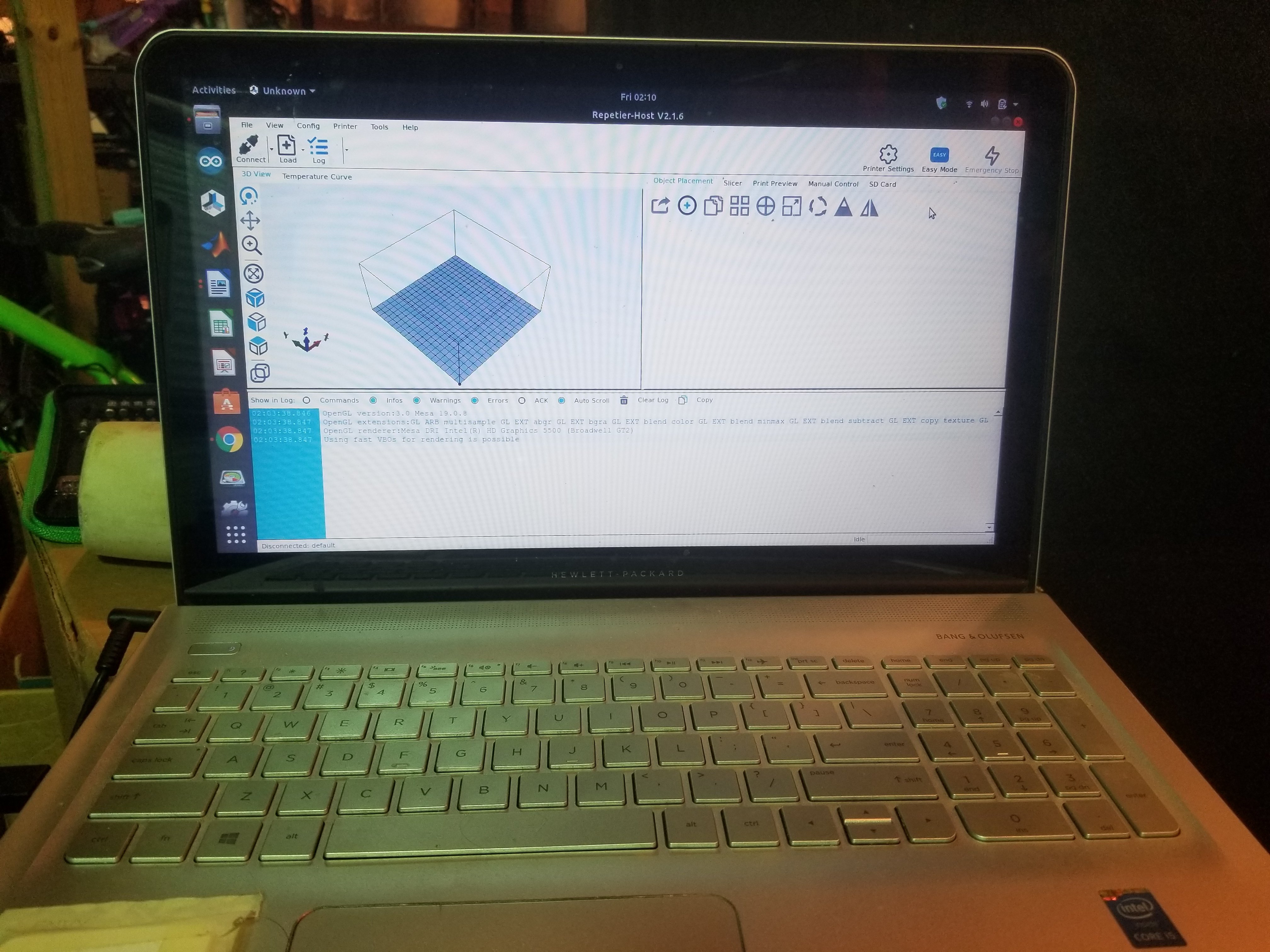

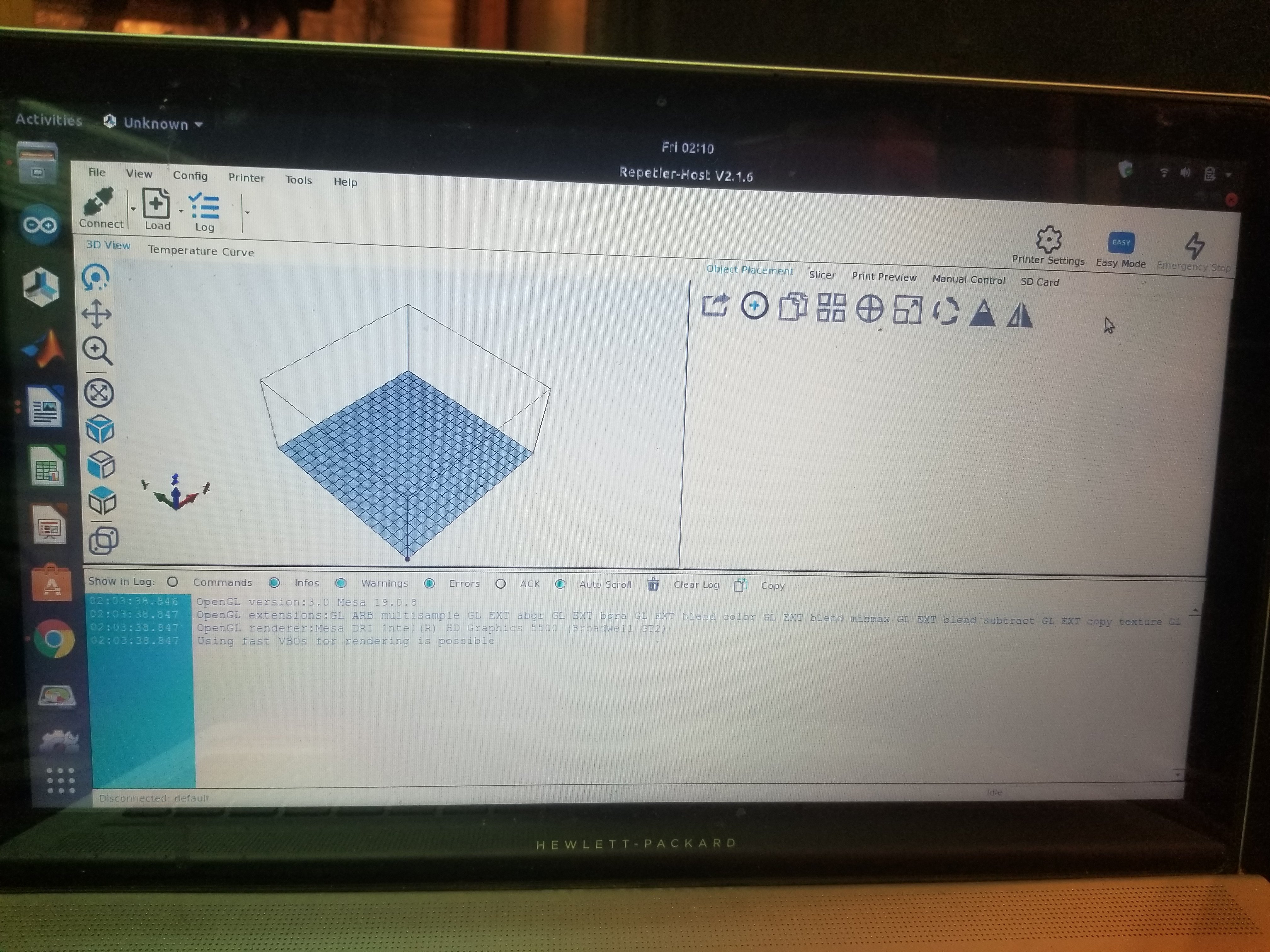

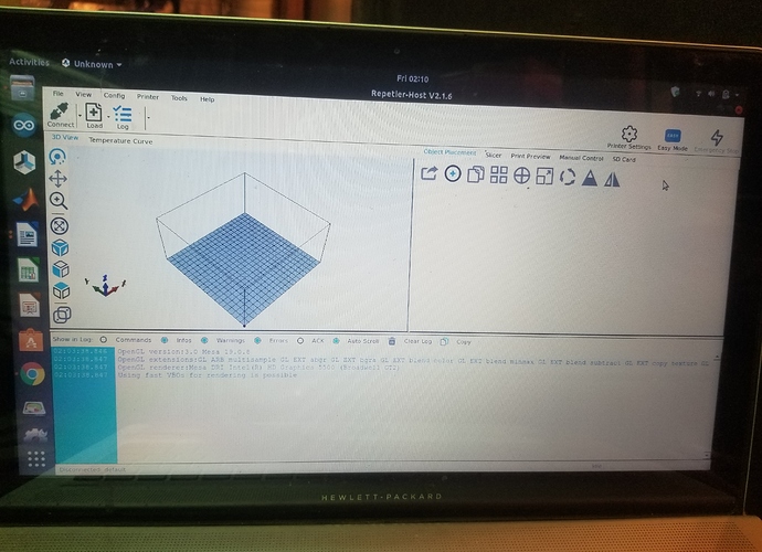

Hey guys. Here’s some pics. After flashing both boards I’m testing the new one with dual end stop marlin flashed on. Having trouble connecting :confused:
Looks like wrong serial settings.
Yeah, the garbage is mismatched port speeds.
