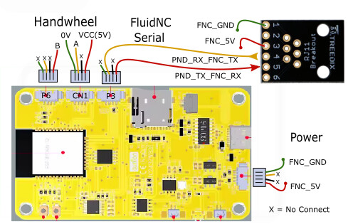

Hey cesar, are you currently using a CYD setup? If so, send me a picture of yours. That could really help me out, or, what code are you using? That would really help me out aswell. Thanks in advance
Do you understand I have the pendant working? The pendant will control the cnc from the touch screen. The issue is the rotary dial will not move the cnc. I will need help from someone who has actually used this screen and/or have flashed the cyd screen. I appreciate you trying to help me but you are just telling me to do everything I have already tried!!
you would be helpfull if you actually used the device!!! lol
So in your pic it shows handwheel connection. The wiring does not match your pic above, you have 2 red wires, why? Did you make your own harness? Have you verified that connection?
