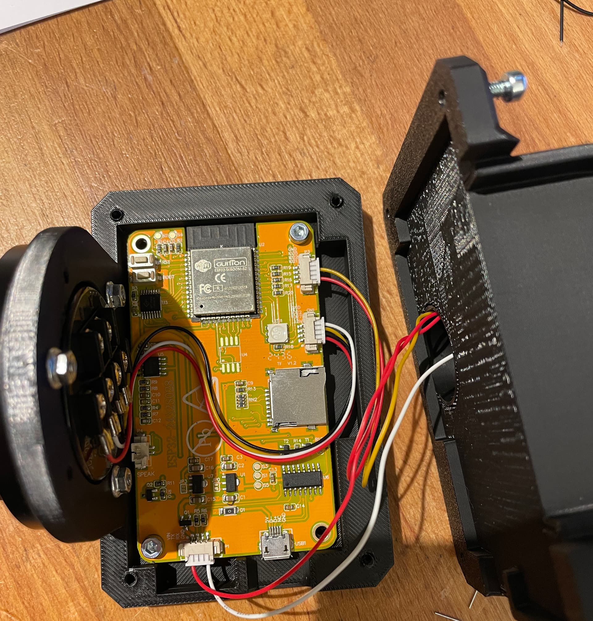

Had to wait for getting some Micro JST cables delivered. Encoder Pendant is done.

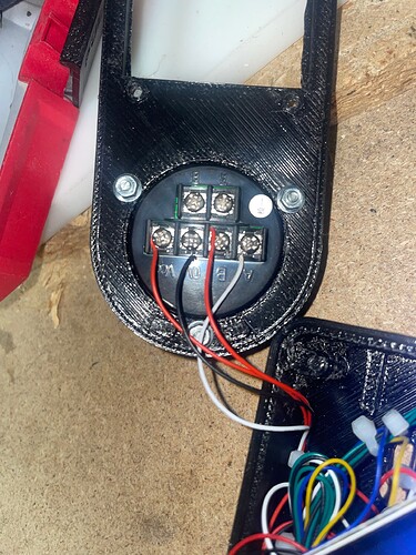

For the encoder i soldered on some ring terminals.

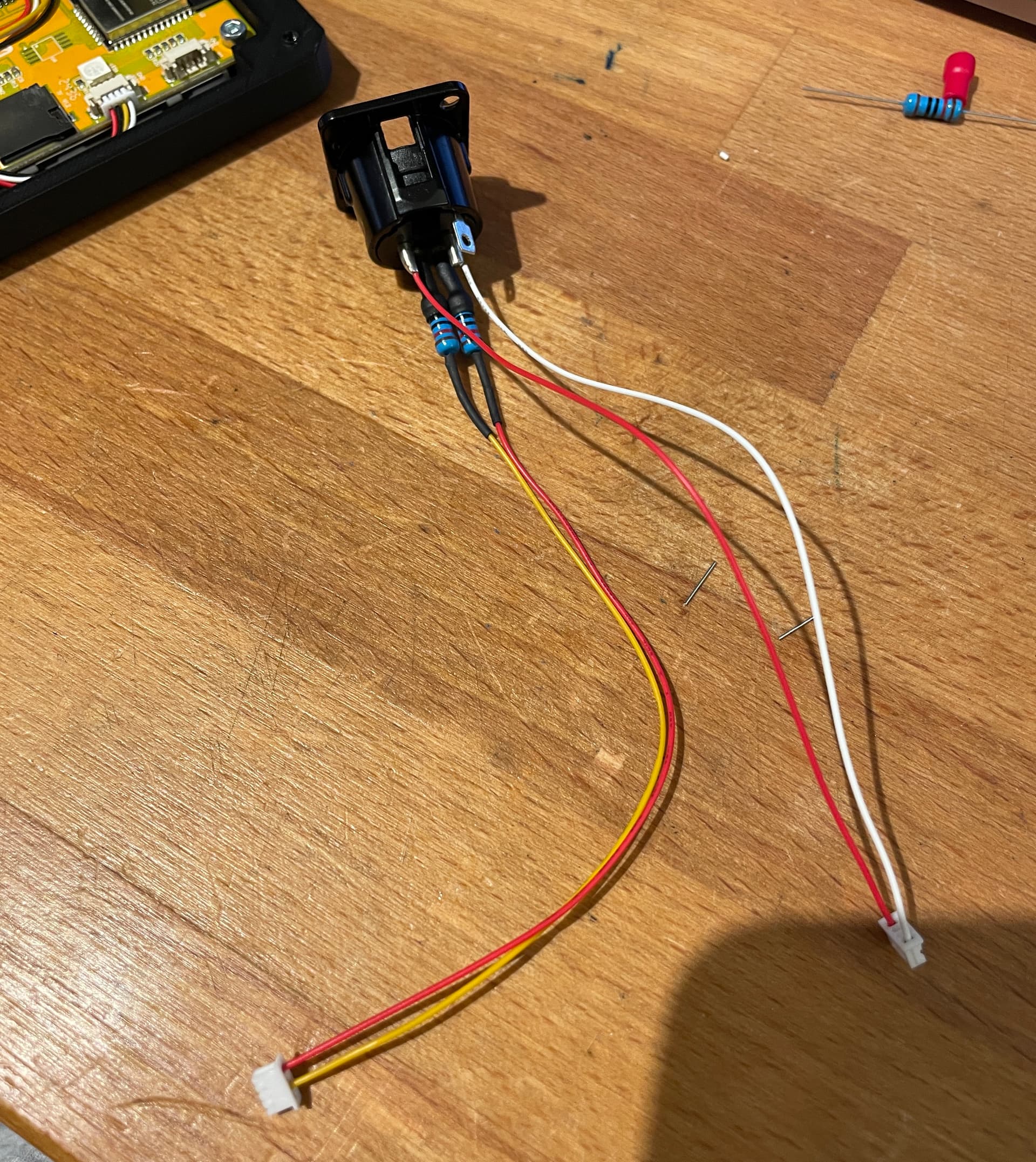

I soldered the 120ohm resistors straight to the XLR connector on the TX/RX Lines.
Don’t pinch those tiny cables when closing the Case!

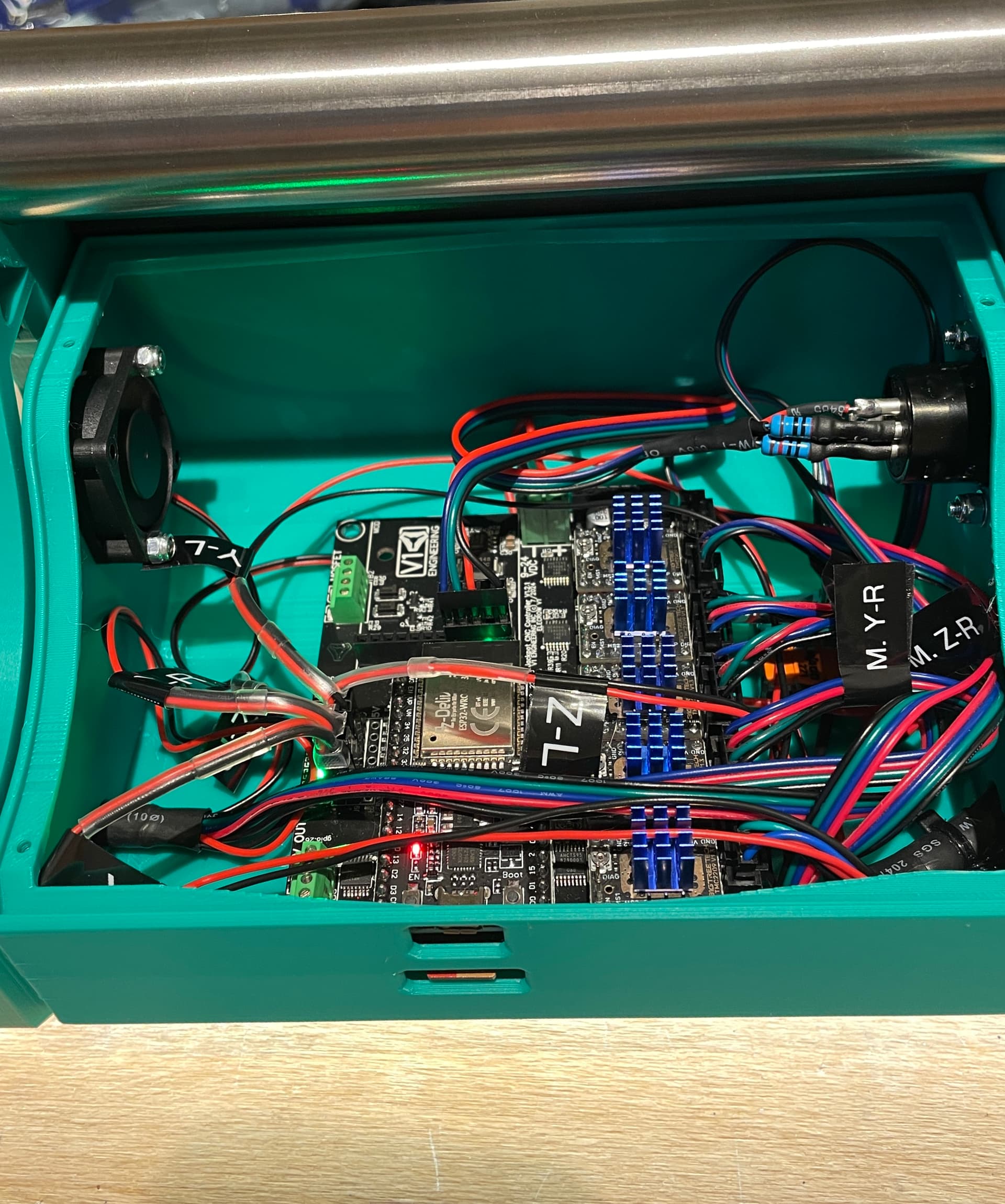

On the controller side i used a female XLR connector. There are two 120ohm resistors on the RX/TX lines as well.
The RX and TX lines get turned over on the Dupont connector on the Jackpot board.

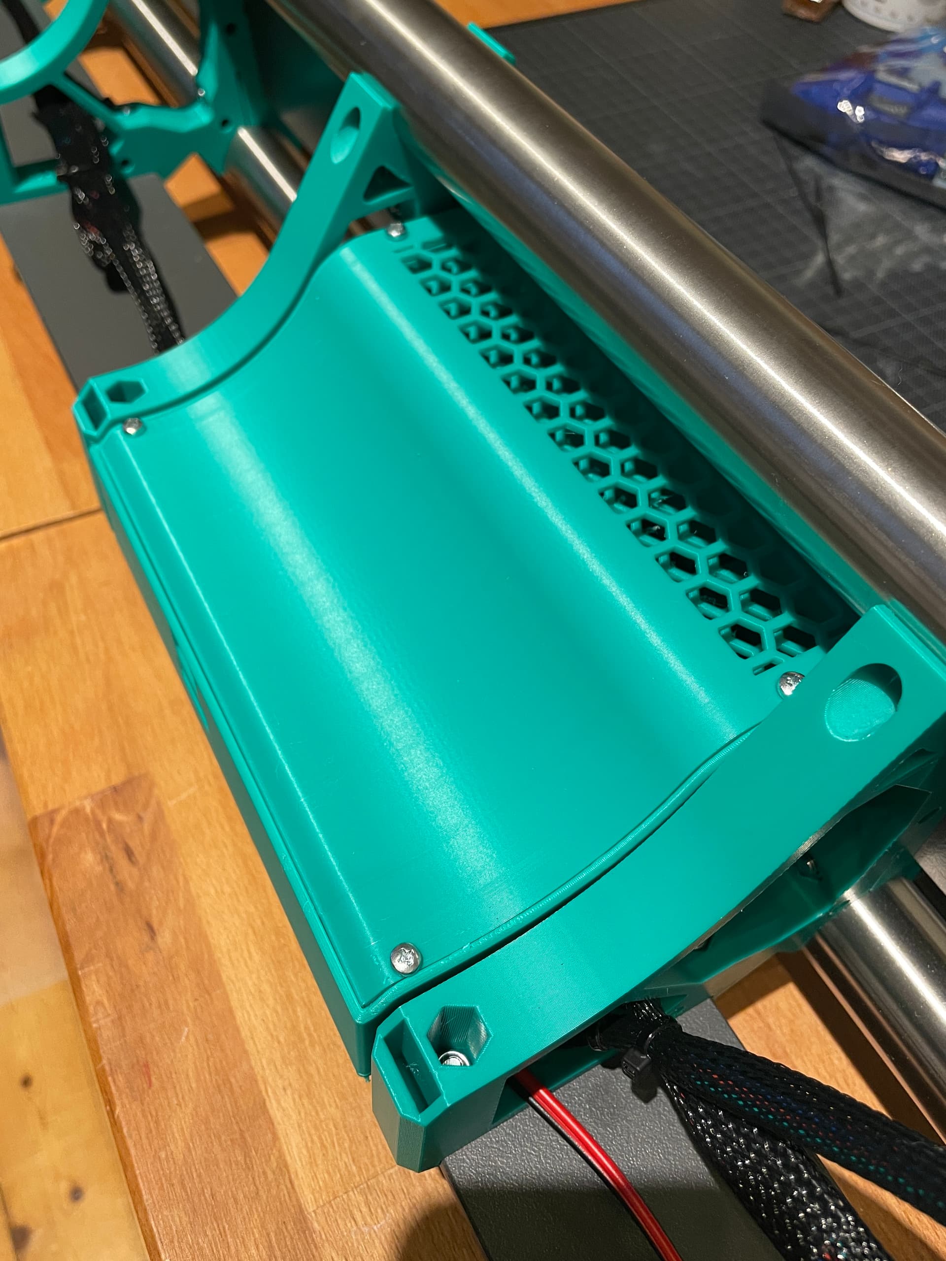

I integrated a slit for a filter element in the jackpot case lid so dust can’t enter. The 30mm 24V fan pulls the air out of the case.

I really love thie design of this case and the concept of it! I’m working on the pendant for this CNC aswell, and I’ve gotten everything to work besides the encoder.
I’m using the capacitve CYD, and the touchscreen and jog works on it. Whenever I try to use the encoder though, the blue light flickers in response to every click, which seems to be a good sign. But the screen itself never responded to the encoder.
Could it be something with the code? I uploaded a pic of my wiring aswell. Any help would be appreciated!
