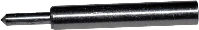

That is spectacular, did you use an endmill or a drag bit?
These are the only other pics I took. I suck at remembering along the way. Definitely need to get better about it
Drag bit. Just over 9 hours running at around 35mm/s. At one point I bumped it up to 40mm/s but then started worrying about over heating the drivers. Not sure at what point I need to worry so I backed it back down
What’s that?
Spring loaded with very small tip. Takes a while to do a sign this size but has very tight detail. I always mirror my image and engrave the back of the acrylic. Here is a video to one back on my old LR2…but you get the idea. This one was made on my Primo while the LR3 cut out the box
