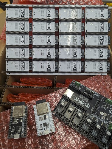

Really awesome to see the first copies out in the field.
Well, truth be told you designed in a killer feature. Your broke out all the GPIO from the USB interface into pads, so for folks doing embedded development you just delivered a really interesting upgrade to the dev board.
I’ve said before I’d buy some standalone, and that remains true.
Yes, this. You don’t have to price them at a level that eats into your supply for jackpot boards with no benefit to you. Price them such that it actually could contribute meaningfully to your bottom line.
I’m not offended, for example, to spend $25 on a specially equipped development and test asset, unlike if I were just buying a ‘cheap as possible throwaway embedded controller’.

The LED’s are much better now. Still bright but not ready to burn out a retina. The bottom pads are perfect.
It just occurred to me I can use USB-c connectors on these. I need to remember to do that next time.
The Jackpots got much smaller header holes and look much better as well.

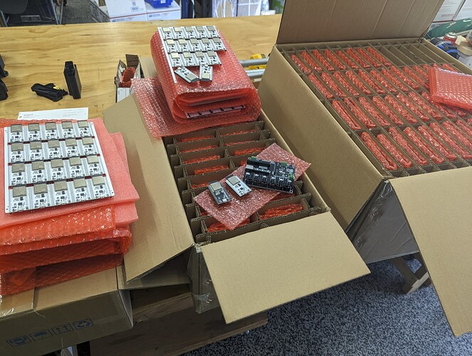

I need to get these in the Shop, hopefully later this evening.
I still have more on the way.
Man those look good! Need to get my hands on a few for sure and turn the ones I have into backup test boards LOL.
I must have missed it along the way but what are the pads on the bottom for? I don’t think I have ever noticed them on any other ESP32. But I may just not be very observant LOL

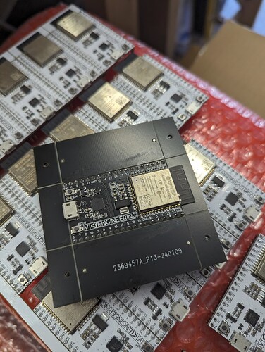

Check this out. Turns out JLC has a minimum size. Looks like I need to try a panel of 2, that would use most of the minimum and should save a few more pennies per board.
Makes sense now That I look at the jlc specs a bit more. A small panel might be better than the big panel, those are a hassle.
Yeah, it’s pretty normal to have different options for order quantities and panelization work out differently in weird ways like that. It’s pretty common to have a minimum size for running a board down the pick and place line, so usually you’d panelize it out to meet that size. This is just one of the more extreme examples I’ve seen!
The PCB part of it is so cheap now that I’m not surprised that this is how they would approach it.

I think they are just trying to tell you to make it a single board, not 2 :slight_smile:
