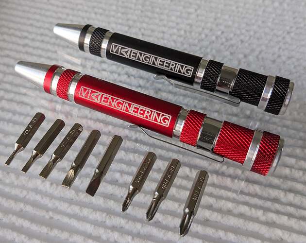

Yup toothpick, and this
Is a great capacitor removal tool
