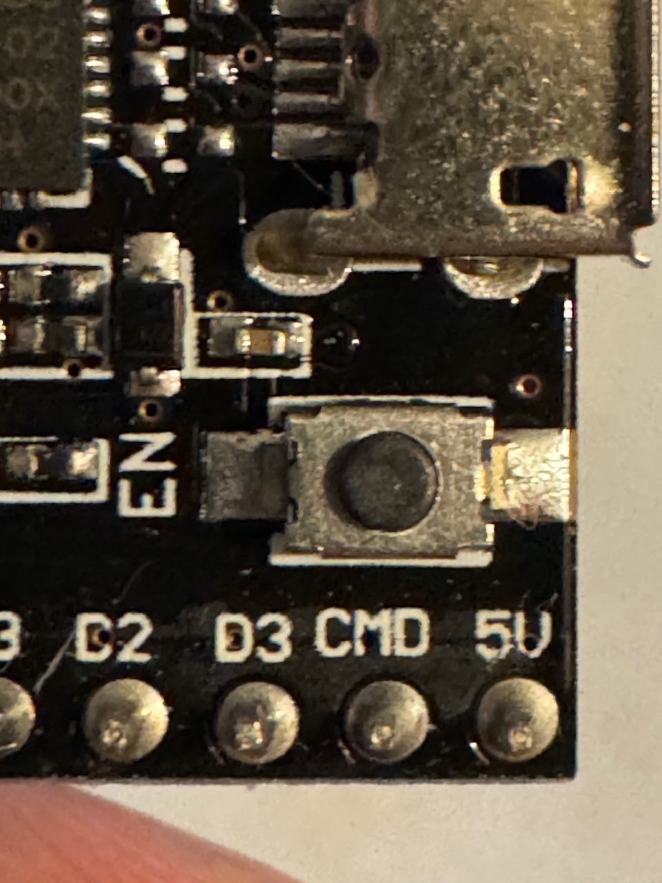

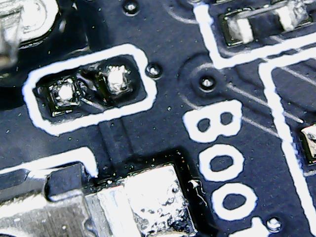

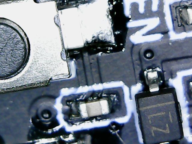

Wait a minute…I don’t think the genuine has a cap on the boot pin. Is that slowing us down?
They are so small you can;t tell…
1334897869383
boot side
1334897870364
En side
Until you zoom in.
Boot has the cap removed.
Definitely something interesting going on there, I wouldn’t have expected to see a significant difference in those pins.
I wonder why IO0 is jumping high there… That might just be when code starts to execute and it’s being configured as an output. That would make sense with EN reaching ~1.5V which is likely its threshold voltage.
The faster rise speed on the EN pin will just be the single 100nF cap instead of 2x. That’s almost perfect step response for a 10K/100nF cap.

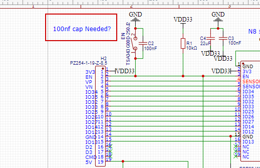

Ah, interesting. That’s a bit of a smoking gun, there. The schematic being correct for the layout but there will be a separate BOM document to check that shows whether parts are actually fitted or not.
Okay so I will pop it off and see what happens.
Is that this one with the question mark?
“Is that this one with the question mark?”
No that one we did not place.
AND!!!
THAT IS IT!!! popped it off and the SSID showed up and the boot is identical to the Genuine!!!

Yeah, that’s a nice trap to be aware of.
This is one of the ambiguities that you run into with schematics. The schematic often refers to the layout, specifically, not the actual final assembly.
With version control systems, we typically have a tracking number for the schematic which will be correct for the layout, we’d have another tracking number for the layout/unpopulated PCB. There would then be another tracking number for the BOM which would be linked to yet another tracking number for the assembled PCB.
There are good reasons for doing it like that, in that often it follows the workflow: Schematic gets made first, then layout, then after testing the assembly gets finalized (which is where you’re at now).
So in your case, you’d have a BOM that matches the final assembly and would not contain that capacitor.
You CAN do this with schematics, but given that you’re giving BOMs to the contract assembler, it needs to be done on the BOM as well, so often it’s only at the BOM level anyway, with the schematic remaining as a single schematic that needs the BOM to be correctly interpreted, etc.
The EN needs one, the Boot is the tricky one that doesn’t
