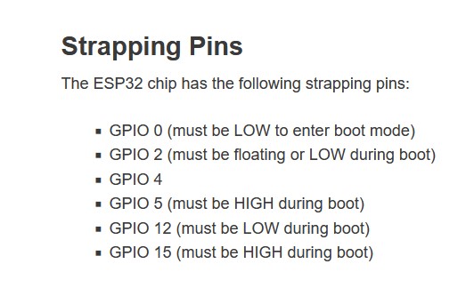

This seems to point to one of the several boot pins is floating somehow that should not be?
Maybe a poor choice of a component. That $ss thing is really sitting wrong with me. It seems odd. When the big batch of Genuine Espressif boards gets here we will really see if it doesn’t happen with them.

The one issue I am worried about is that they do not boot right on USB only. I tested all the pins any that should be high are and any that should be low are.

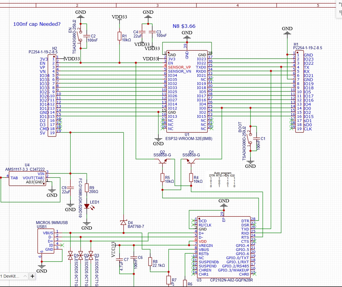

I checked all the pins for resistance to ground. On the V1 board the pins are ~11M, and on the Espressif board they are ~12M. That seems okay (but why is there a difference?). The Enable pin though…that one is different. On the V1 board, it is 11k, the espressif is 80k and keeps counting up higher and higher.
Espressif - https://dl.espressif.com/dl/schematics/esp32_devkitc_v4-sch.pdf
The only thing we changed on the enable line is that one cap, so I soldered one on…no change.

Are these still using the AMS1117-3.3? Honestly, if so the first thing I’d swap would be to put a better regulator on one of these and see if it then works correctly on USB.
Potentially, but ultimately I’d probably investigate that further first rather than replacing it. A scope probe on the 3.3V rail on startup will show you if the regulator is having any issues. If it’s failing to hold regulation, it’ll be pretty obvious by dips/overshoots on the 3.3V rail. If the 3.3V rail is solid, there’s not really any way that the regulator is likely to be influencing anything else.

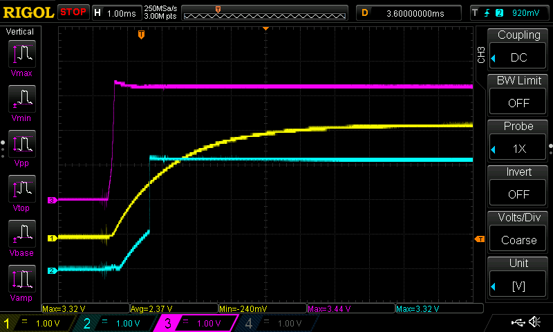

Trying the scope on en, 3v3, io0 and io4. zooming in to look closer.

Interesting. Top is V1 bottom is espressif.
Purple is 3.3V
Yellow is Enable
Blue is io0
What pin am I missing on boot?
3.3 is looking good to me, maybe even better on the V1?
Enable is identical
Maybe io4 is the one to watch edit- nope io4 is way later.
What’s the timing there? Is gpio0 being pulled high too slow compared to genuine?
Can you verify whether it’s in boot loader mode?
