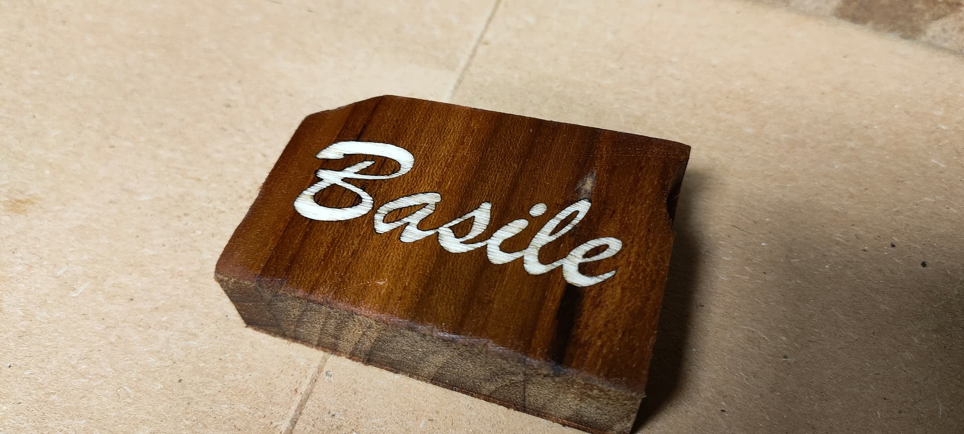

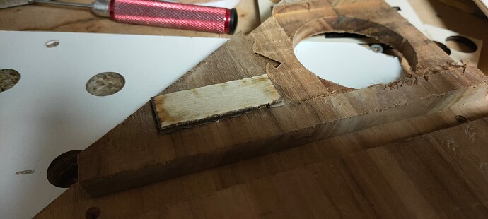

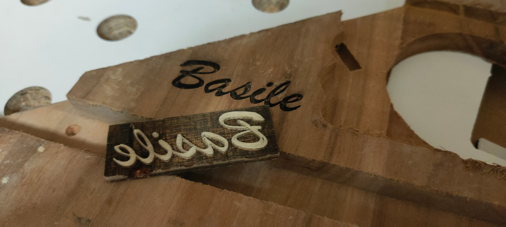

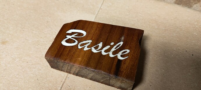

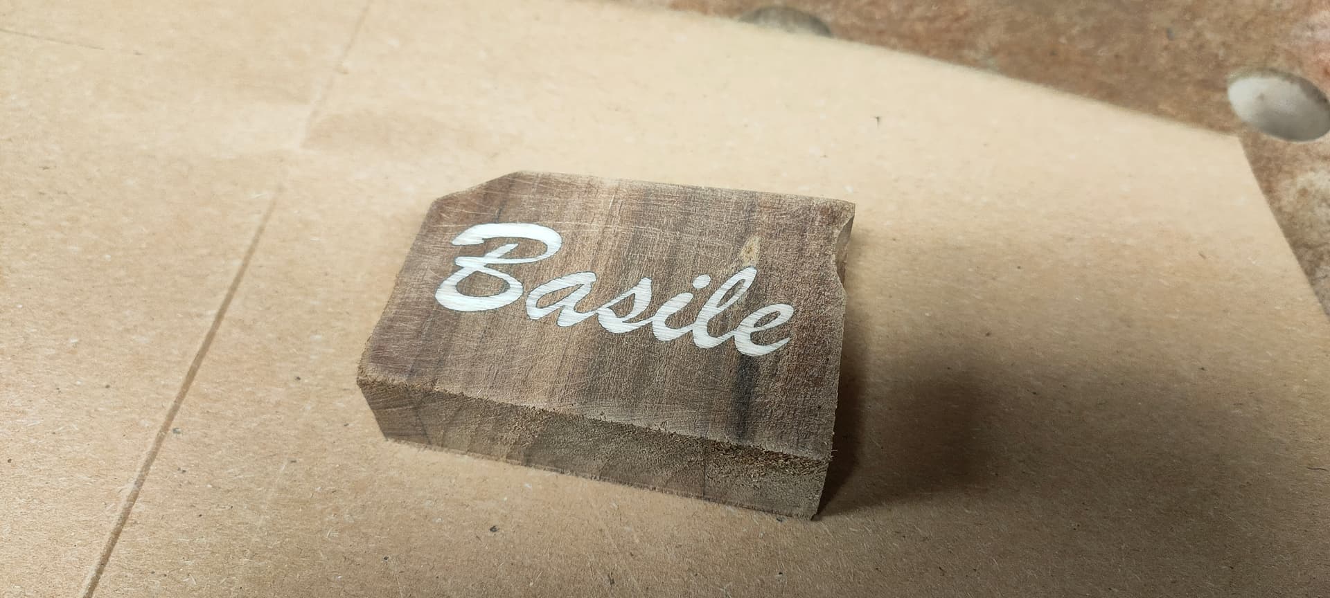

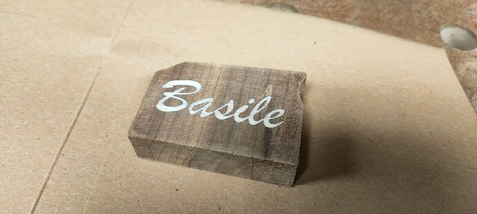

Just a little test with my son’s name on scrap teck
The inlay is plain poplar plywood as I do not have a clear hardwood available
I used an offset fill for the pocket rather than horizontal lines
400dpi 50mm/s 100% power 2 passes for the male part
600dpi 50mm/s 100% power 2 passes offset fill for the female part
The inlay is 60x20mm

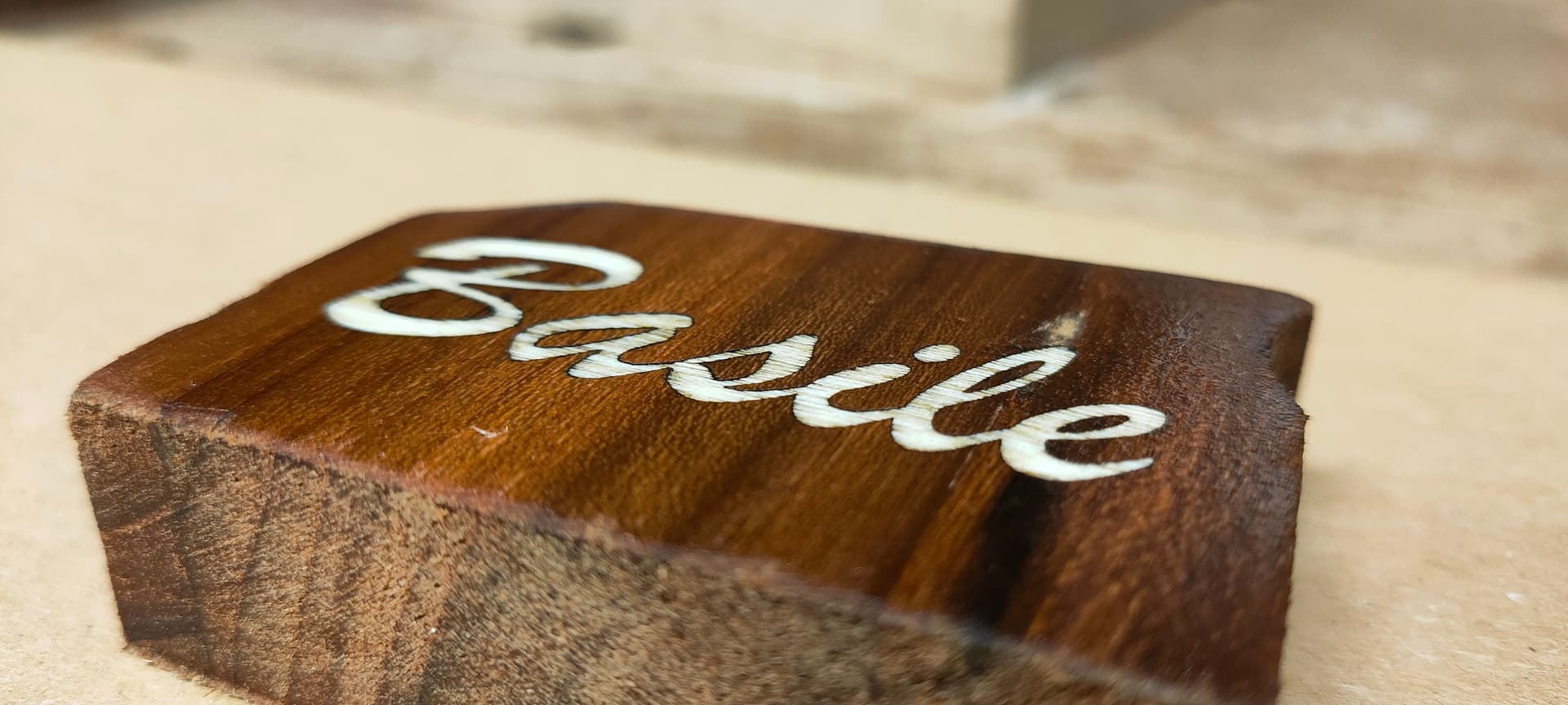

The process is indeed pretty easy, just got to keep organized with the different steps and find the correct settings for the materials and your specific laser setup
The result is great, with very thin lines easily do-able (see the “s” and “B” shallow parts)
Very impressed, thanks for the discovery !

That is a fabulous result, Fabien! I’m so glad you gave it a try. And thrilled that you found it relatively easy to do. AFAIK you’re the first to test it. Since describing the method in the first post, I’ve found that there will still be a few little things to fiddle with to make the offset operations work in “all” cases but, as you’ve indicated, staying focused and being willing to test a few things will soon make it become “easy” to get good results!
Hang on to all your little “test” pieces… eventually a way to use them will occur to you. I found that a box generator program like “boxes.py”, for example, will allow you to make custom-sized boxes that incorporate your test pieces in some way.
Again, congrats! Thanks for sharing… you’ve really made my day!

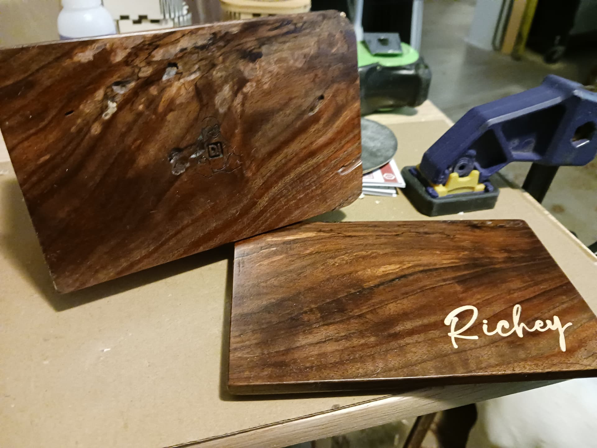

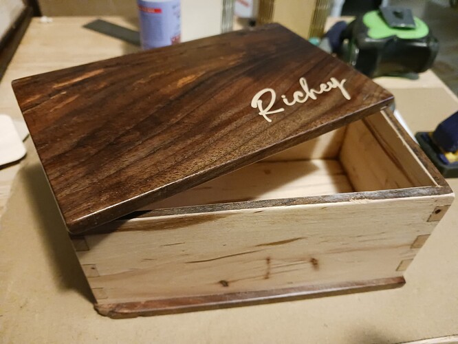

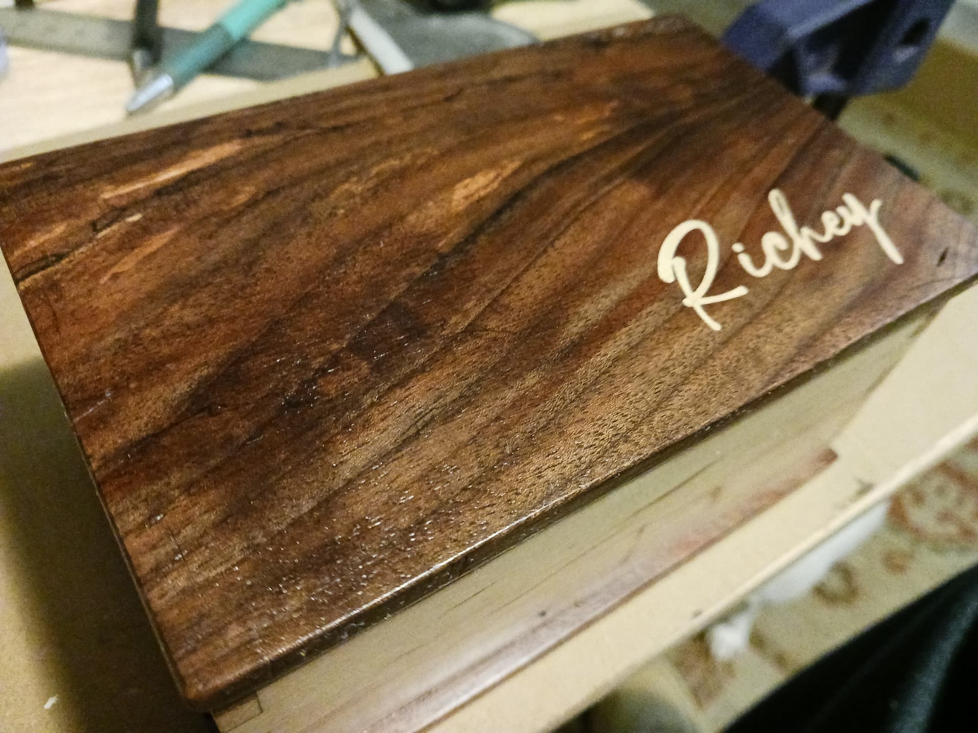

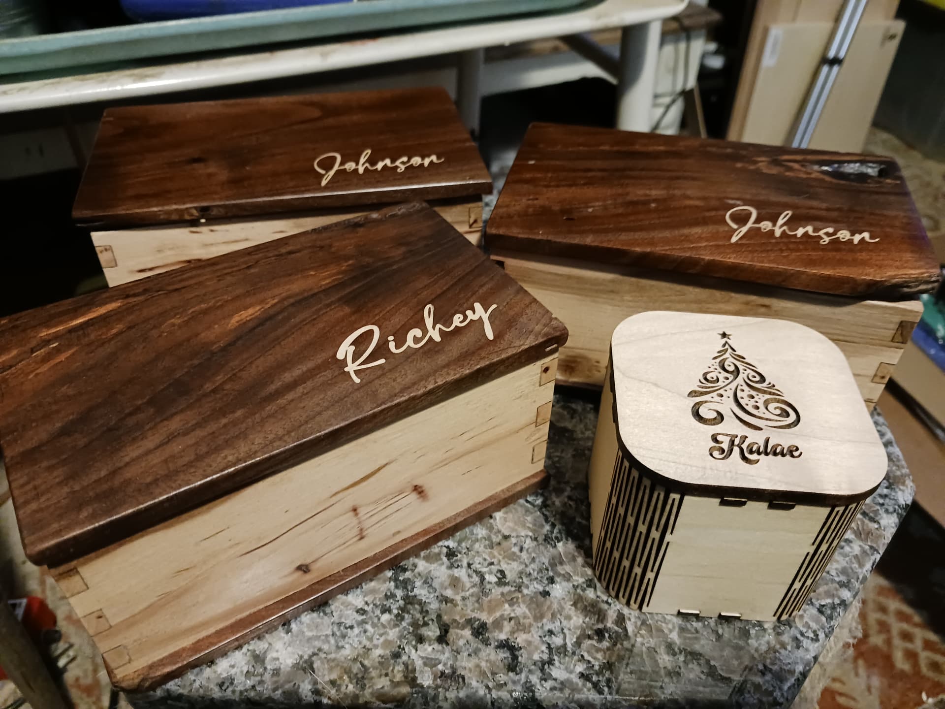

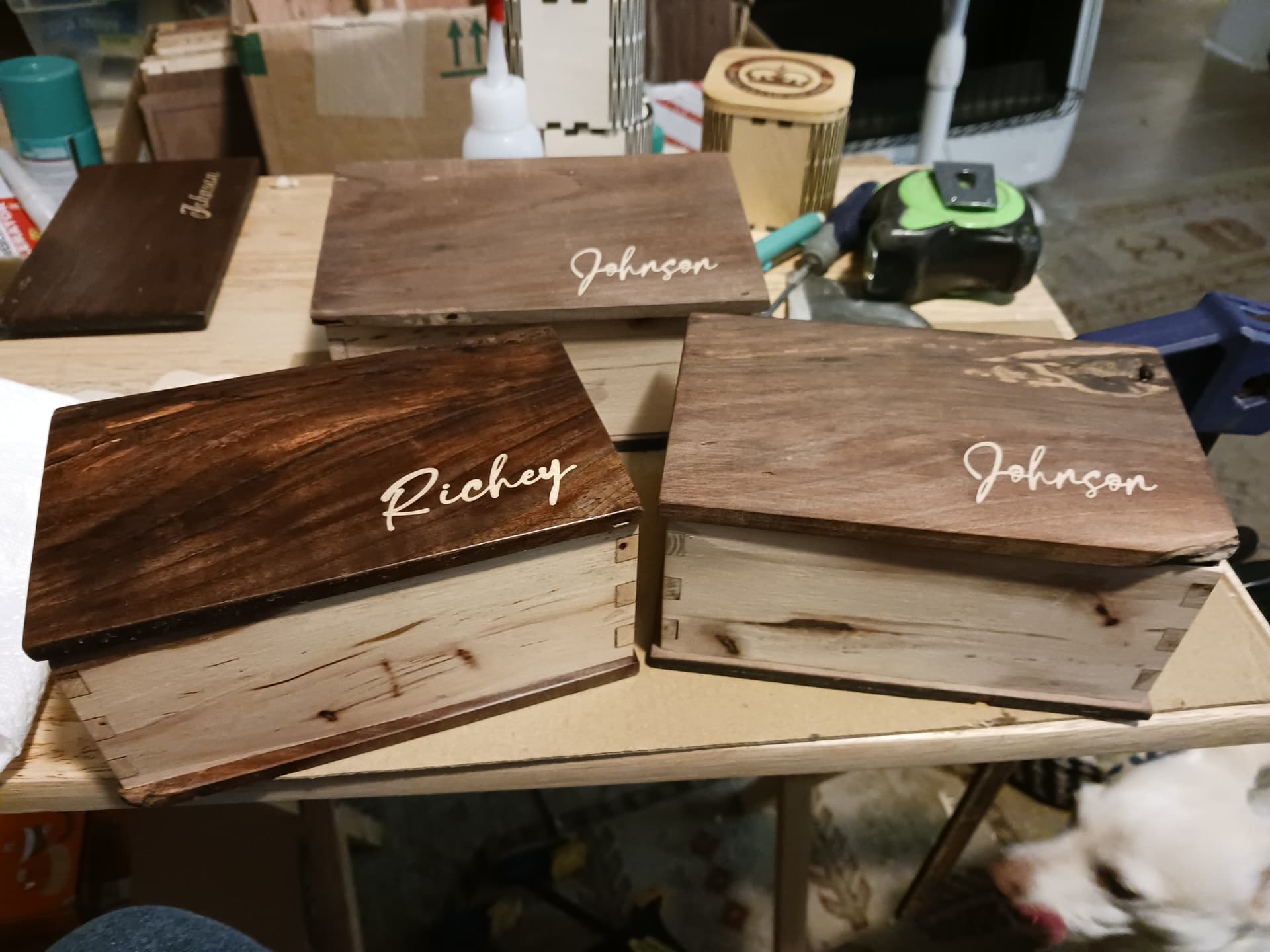

More progress on the Family Christmas boxes…one down, two to go!

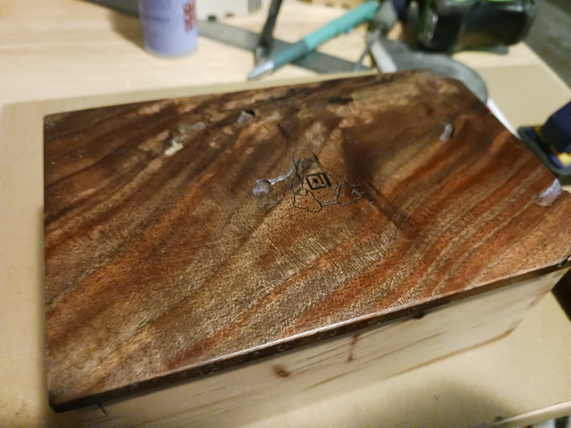

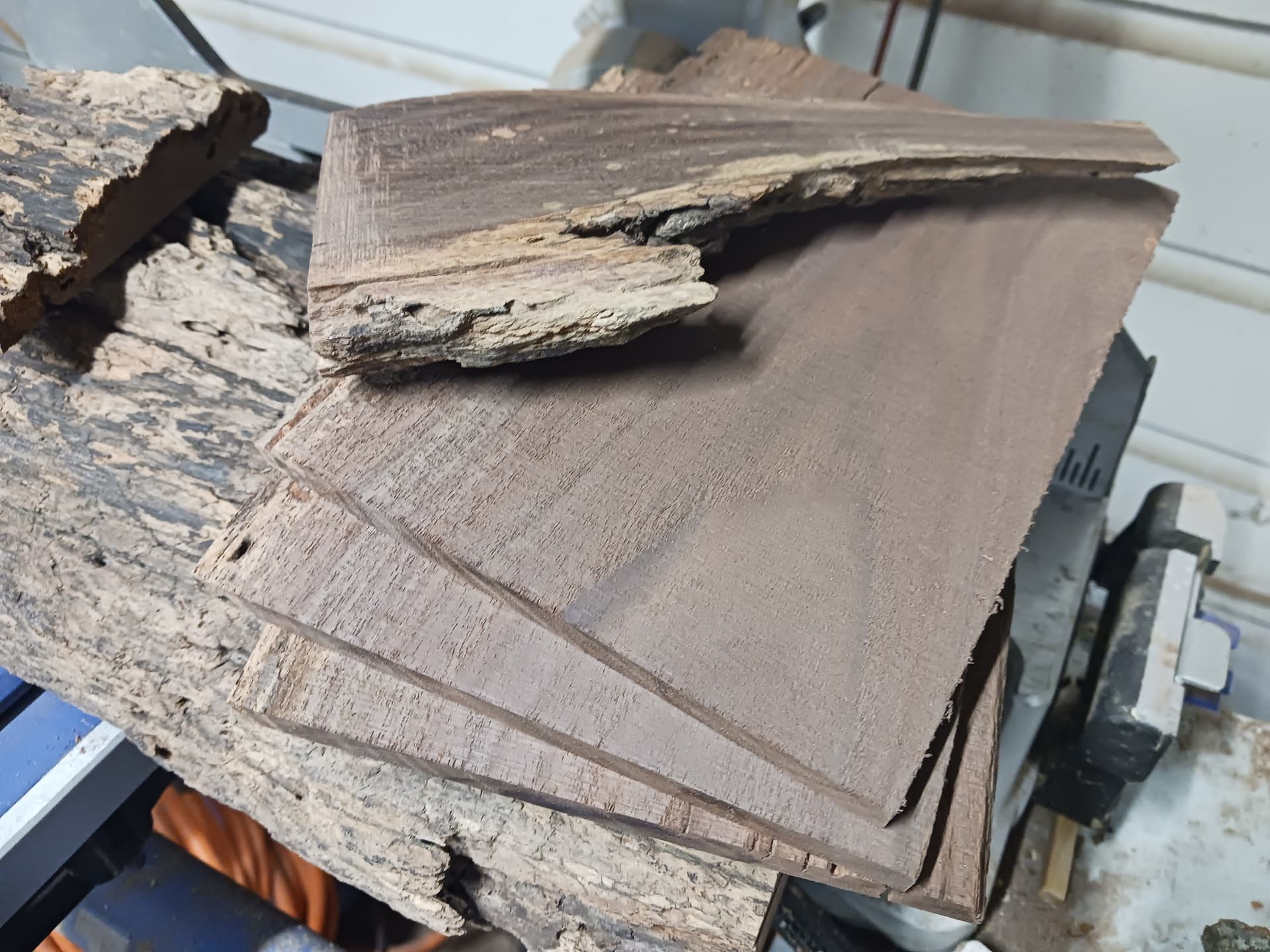

Wormy pecan and ratty walnut with maple inlays. I’ve also been watching a bunch of Rob Cosman YT videos and trying out his small box finishing technique… 3 light coats of Deft Clear Wood Finish (Satin). I think I like it!
I know… it’s hard to believe HD and Lowes doesn’t carry this prime box-making stuff. Sadly, I’m down to my last few pieces of the walnut…
Plenty of inclusion-rich, wormy, pecan, however…
Grandkids Christmas-money boxes are next… similar to this. Not nearly so time-consuming to make as the family boxes…
It’s been a long time since I’ve worked in my woodshop. I’m enjoying the journey!

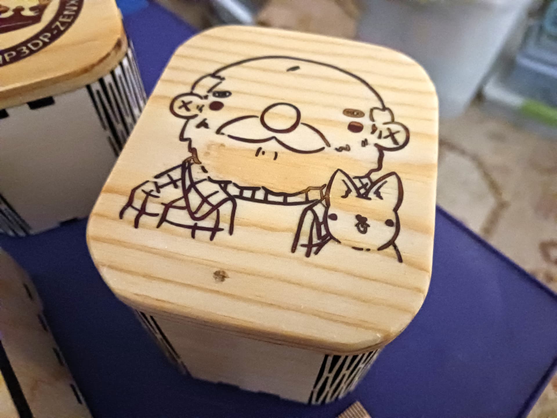

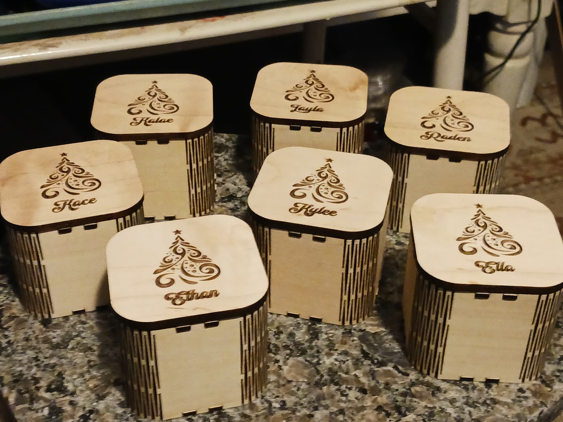

Got Christmas gifts done by Thanksgiving! Three family boxes for kids… seven gift boxes for grandkids. The family boxes have the inlays I’ve shown ad nauseum… and the gift boxes are 3mm birch ply with engraved solid maple lid. The Christmas tree is one of Robert’s (@robertbu) Midjourney shares and I managed to find a fairly nicely matching font to add the grandkids names.
Just sitting around, twiddlin’ my thumbs and contemplating my navel now… a bit embarrassed that it took me so long to do what appears should have been a fairly straight-forward task. Not sure what to do now…
– David

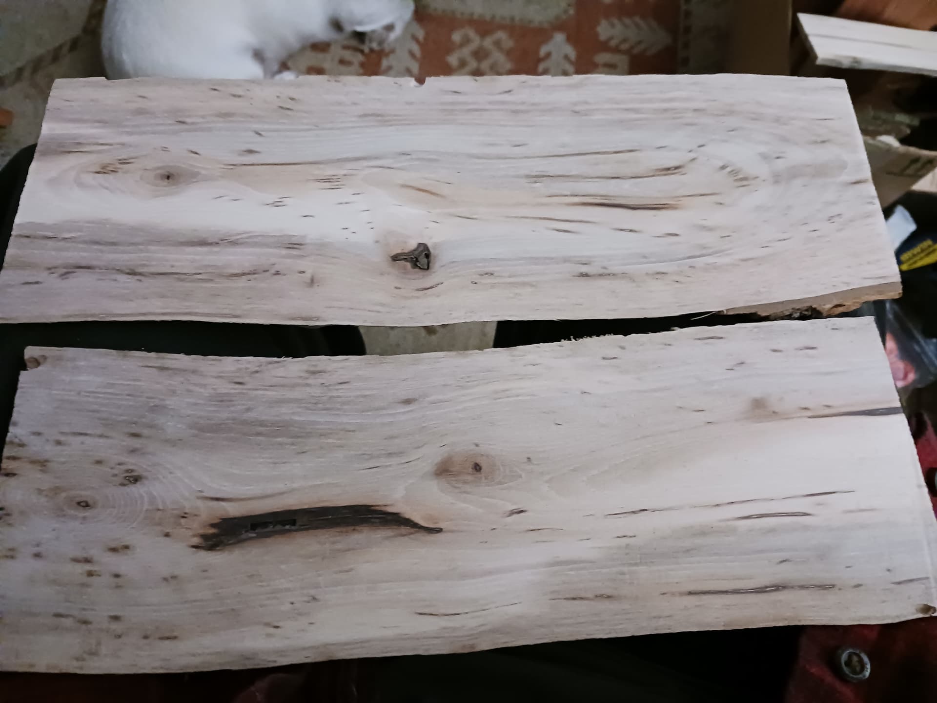

If you have a 4" side and a 8" side. And all sides are 3/4" thick, you start with a blank that is 12" long and 1.5" thick.
You resaw down the middle to make two blanks that are 3/4" thick. Then cut the sides like this:
Rotate the small sides counter clockwise and you have this:
The corners all match up and the grain flows around the whole box, but two sides are actually mirrored (book face matched).
(For the math. I ignored kerf sizes and the loss to smoothing on the planar/joiner)
Ah, got it! So easy to comprehend once you see it spelled out. Thanks!
