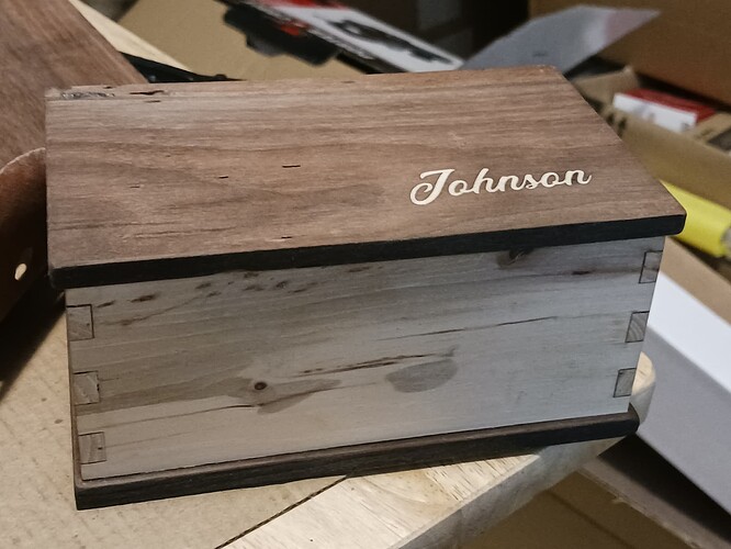

I’ve been having a hard time making up my mind on what the family Christmas box lid inlay should look like and it’s really taking a toll on the amount of usable OLD walnut I have. It’s really putting my woodworking skills (or lack thereof) to the test…
Ala Goldilocks, I started with the big bold monogram… and it quickly began looking too big and garish to me…
Looking for something a bit more subtle and “scripty”… but this one still looked a bit too blocky and “mechanical” to me…
Finally found one TLAR (“just right”?) and have about settled (I think…) on it…
I want to do MINIMAL wood fill/repair to retain the rustic look and yet have buttery smooth feel to the surfaces and edges. I’m very happy with the inlays themselves – these are maple and walnut – and have been great fun and good practice. The box sides and ends are planked out of a 70+ year old pecan tree my great grandmother and I planted in about 1950.
– David

It’s “Sachi Script”… found it out on Dafonts.com. Small mods to slightly thicken the lettering and put white space in the “e” for inlay…

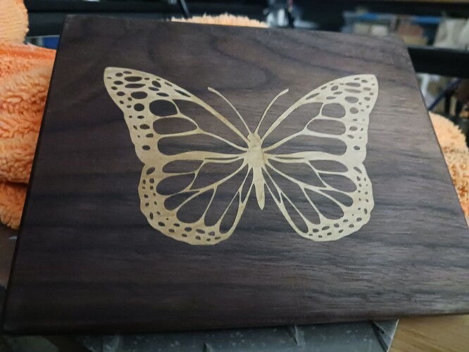

Still piddlin’ with boxes and inlays…
My eldest son came to visit for a couple of days. Had occasion to demonstrate to him how I’ve been doing these inlays. Simply screen captured an image of a nice butterfly off the net, quickly processed it in Lightburn using easy inlay method outlined at beginning of this thread, and then lasered it on small pieces of walnut and maple… butterfly is about 70 mm tall.
Forgot to photo the pocket but here’s the inlay straight off the laser…
Thought it turned out nice enough to share.
