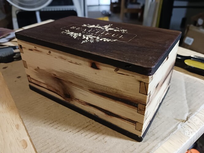

Daughter was impressed with box for SIL so felt she had to have one, too. I resisted, of course, but we all know how that goes… :wink:
Pecan and walnut, Danish oil and Minwax finishing wax…
Since I’m resawing the side and end pieces, was able to match up grain at each corner…
