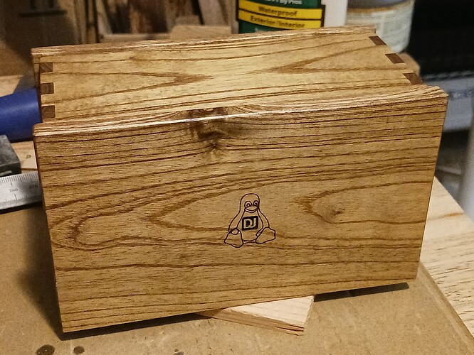

With the warmer weather, I’ve only recently started revisiting my box-making projects. My brother has a 75th birthday coming up so I thought maybe I could use that to get motivated again. I’ll show that in a different post. But speaking of grain-matching all four corners of a box…
Jeff has explained it pretty well with his incredible ascii art skills but I’ve been meaning to show a couple of photos that might help others visualize it as well. As a small limb (here catalpa) is planked out to rough thickness, adjacent planks can be opened up to reveal the “bookmatched” pattern.
Cut/laser the sides and ends as shown and ensure the bookmatched faces become the outside faces of the box, in the order shown (or as Jeff described), to match the grain at all four corners of the box.
It’s less apparent (but still pleasing) with finger-joints as shown here but mitered corners can really be made to closely match.
– David
As I said in my previous post, my brother turns 75 years young soon and I’ve decided to build him a box similar to the Christmas boxes I’ve shown previously.
I planked out a couple of small catalpa limbs harvested from trees on my property with my bandsaw and then used the cutting scheme I shared in my last post to laser cut all the box sides and ends with my Atezr L2 36W laser machine. I used my tablesaw to cut the top and bottom (could have used the laser) because I chose to also rabbet the lid to make it one piece vs two.
It’s also been a while since I’ve done my “easy inlays” and engraving. I had to do quite a refresher course to figure out the inlay process and Lightburn all over again.
Pocket and black walnut inlay pieces are laser cut…
Glued up…
Sawn off and sanded… catalpa with black walnut inlay.
So, the box is assembled pretty much as I’ve previously described and a couple of engravings are added… before sanding and finishing. Catalpa, though fairly soft, is actually quite attractive IMO…
That was a fun project. I also learned that catalpa laser cuts beautifully. Hopefully I stay motivated for a while and can do some more of this. It’s amazing how quickly I forget stuff… I had to really study hard what I had previously done with those inlays.
