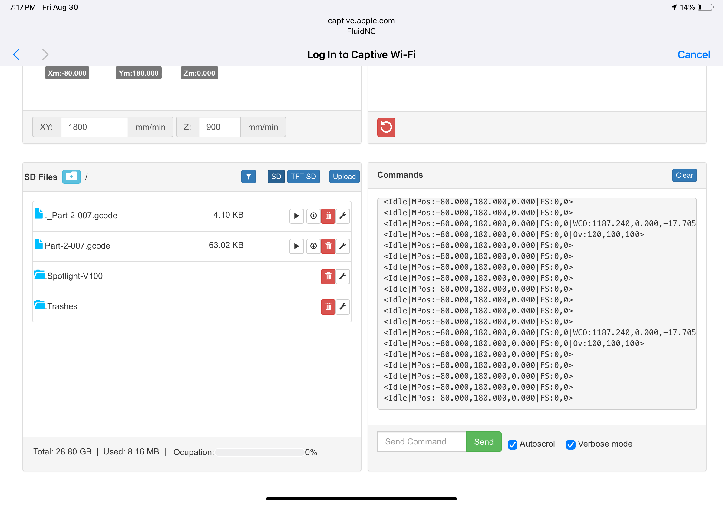

Duplicate Files and Still best to transfer SD Card on Jackpot?

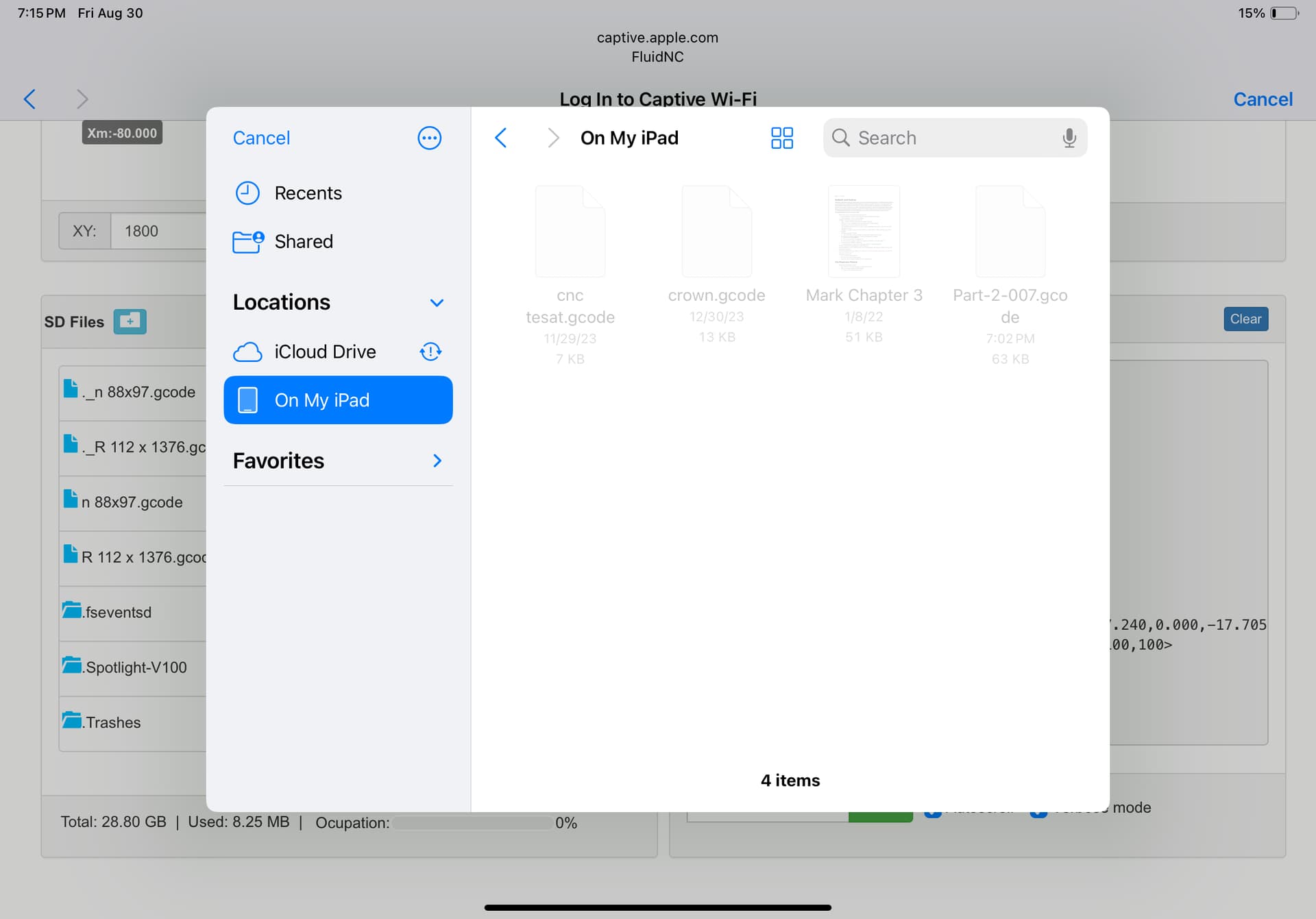

I have been transferring the SD card to get files there but everytime I do I get a duplicate file. Its not really a big deal other than an annoyance to select the right one. Is there something I am doing wrong here?
Also, uploading to the SD card from my iPad while connected to the Jackpot has not worked for me. Is it best still to transfer the SD card? Regardless of being in a browser tab or in the pop up, it wont let me select a file to upload. Maybe an IOS thing?
What, that is a new one.
Run $ss in the terminal and let us know what firmware version you are using. 3.8.0 updated a lot of stuff it terms of file transfer and should be good to go. I have not ever tried it on Mac stuff though.

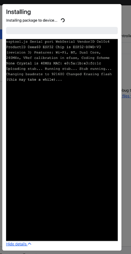

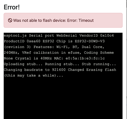

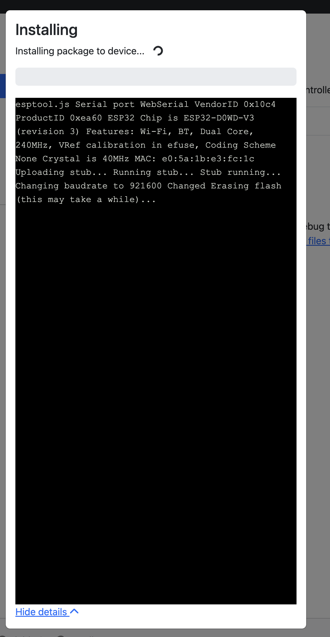

It gives me an error about the bootloader and then I hold the button down which switches it to the installing page. But after a minute or two it gives me this error. Let me hold it down longer maybe.
" This.
With a little practice, I learned when the ESP32 needed the boot button pressed to get it to successfully flash it. I’m on an M1 MBP. I’m not sure why, but it pretty consistently needed my help with the button press.
Good luck.
I am as well.

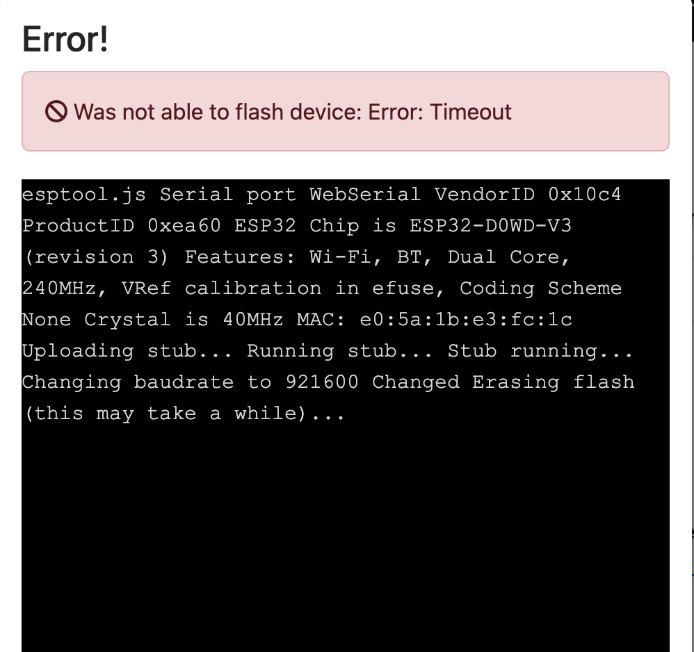

When I initiate install it says waiting for controller to enter boot. Then gives an error and suggestion to try holding the boot button. Which I do. And it switches to this screen.
But then after about 2 minutes it errors out

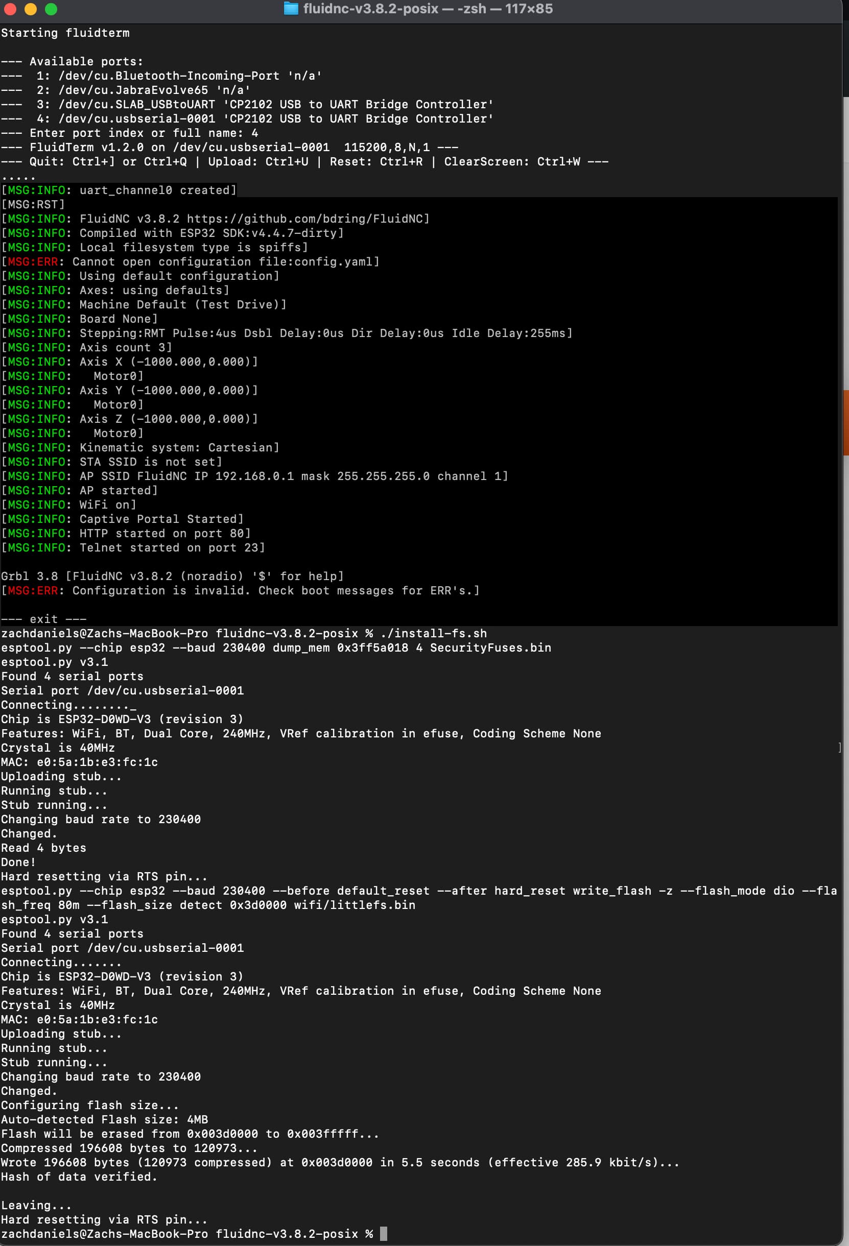

OK, here’s where Ryan and I part company a bit.
For me, I prefer to use the native FluidNC installers, and my preferred machine is my M2 MacBook Air.
Go here:
Then, grab the Posix installer:
https://github.com/bdring/FluidNC/releases/download/v3.8.2/fluidnc-v3.8.2-posix.zip
Extract that, then open a terminal window in that folder.
I didn’t recall needing to hit the boot button recently with the MBA machine, but you may neeed to.

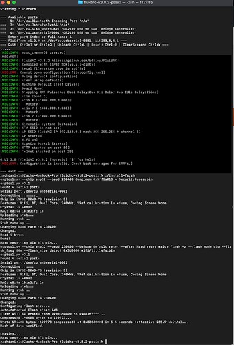

do these, in order:
./erase.sh
./install-wifi.sh
./install-fs.sh
Grab terminal output to share here as a post if it runs off the rails.
If it works, then power cycle, connect to the Web UI, and put your config files and the V1 macros and things back on.

Everything seemed to work just fine. I did have to hold the boot button down on every command. No biggie though of course. I will have to check tomorrow to see if this fixes the duplicate files and transfer issues. But either way Im updated! And I greatly appreciate it.
