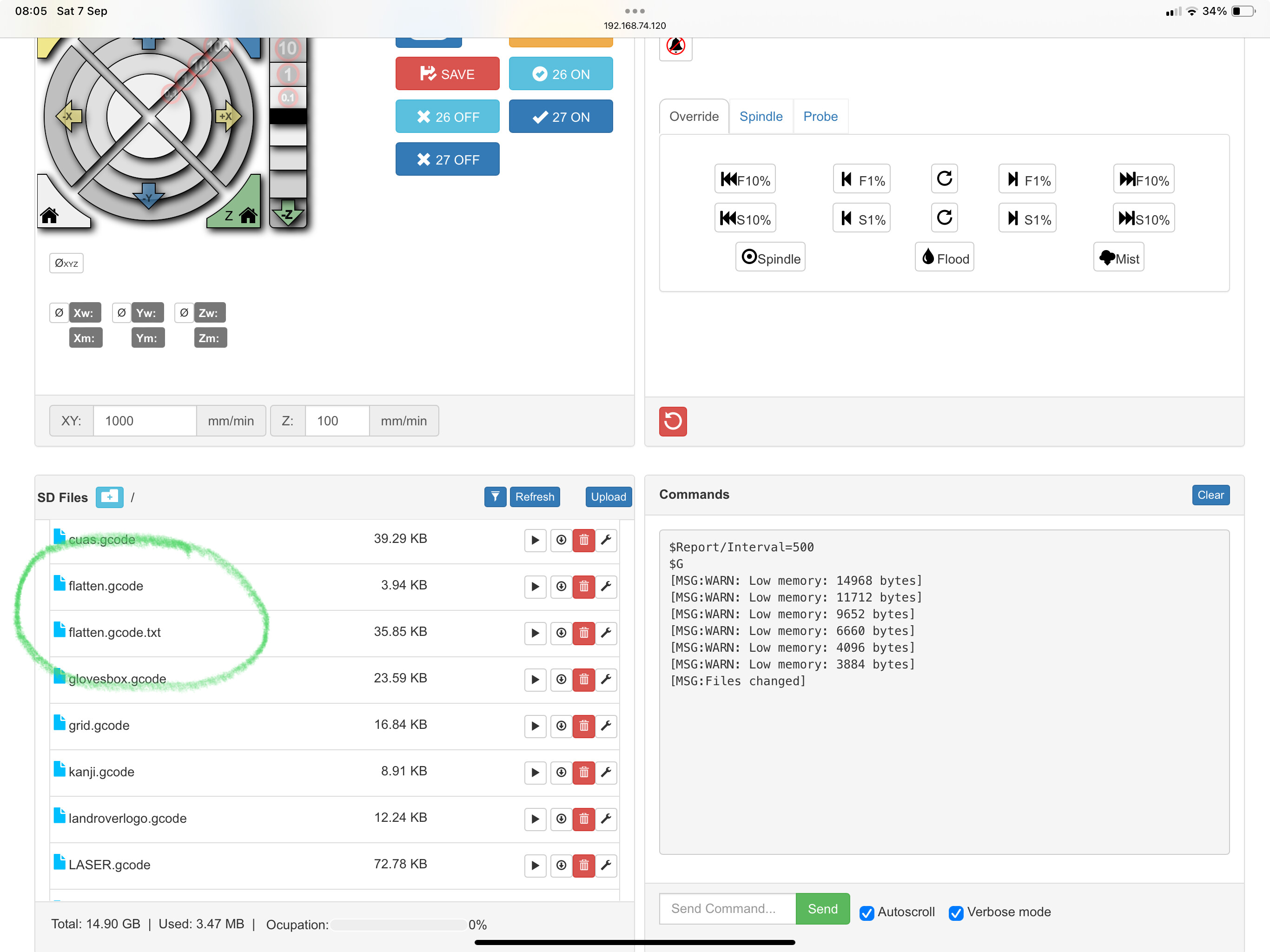

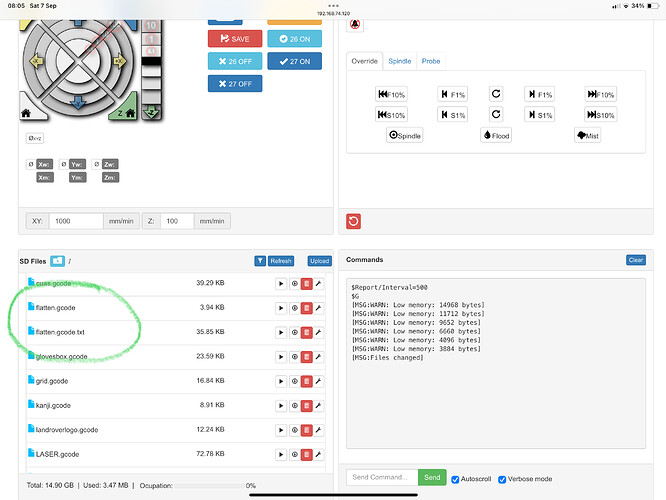

Must be an iPad/ios thing, I just tried uploading a gcode file and got 2
Interesting that your 2 are different than mine. I get one with an underscore vs a txt file. Also, for you looks like the bigger file is the txt file. For me the non-underscore is the larger one and always the correct cut file. Weird. Im jealous the upload worked though!
The dot underscore "." is a Mac thing. Here is a link to a Synology knowledge base article that explains it. You should be able to delete the files with the .
Why are files beginning with "._" created when I copy or back up files to an external storage device? - Synology Knowledge Center.
I am guessing the .txt files from an iPad or iPhone are a similar issue.

Bad news. The FluidNC update did not fix the double file thing (which @Joe_H says is a Mac thing which totally makes sense). Nor did it fix the being able to upload to the SD card from any of my devices. Which in the grand scheme of things is just whining. If Im making parts I can deal with that.

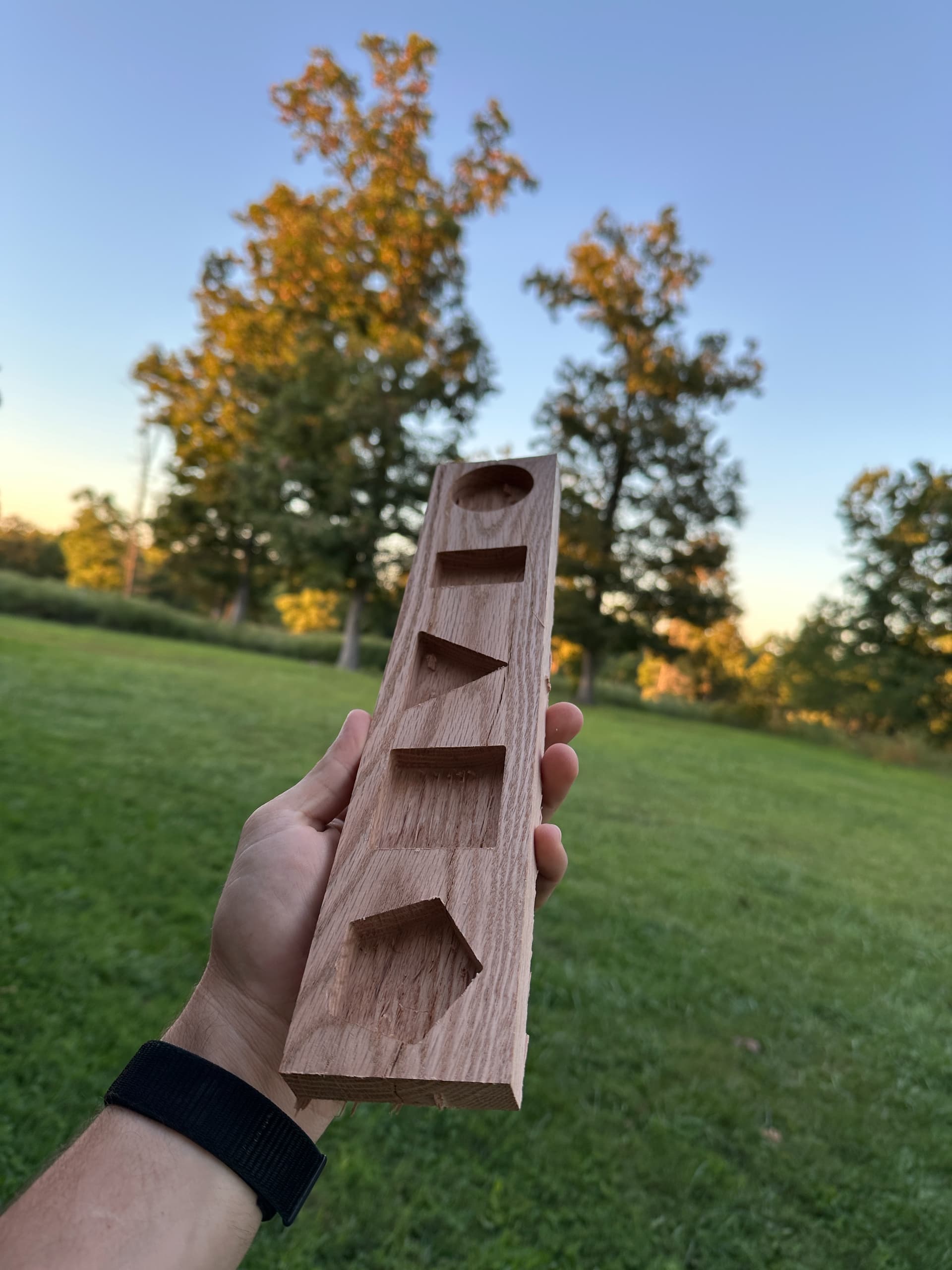

However, the good news makes up for it because after taking the brilliant @vicious1’s advice to use a single flute end mill, and a little more tweaking, I got one of the of the nicest parts off my machine to date.
Dont mind the ridges in the cuts. I had setup a new instance of Estlcam on a VM and forgot to change several settings. But they will sand out! Who cares! It looks awesome to me! Rough sawn red oak from my farm!
How freaking cool is that!?!

Oh, milling material from off your own property and getting results like that is just awesome.
