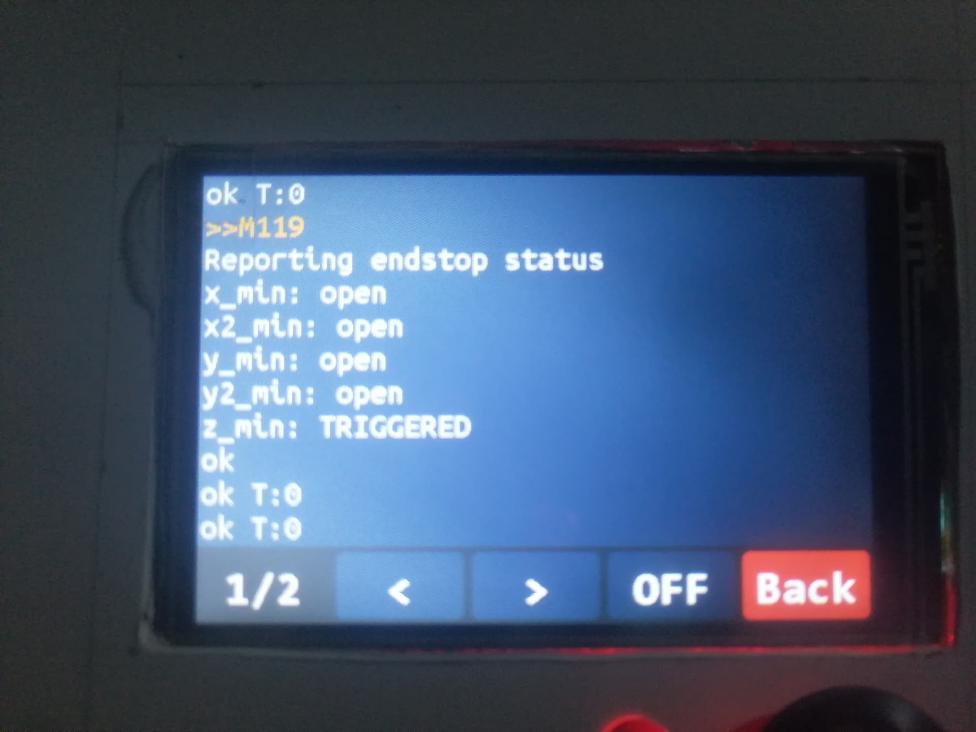

Done putting together my MPCNC PRIMO with an skr pro 1.2 board, which I got in November 2024. movements on all axis are fine but, I can’t get the end stops to work.
M119 always Displays
X_min: Open
X2_min: Open
Y_min: Open
Y2_min: Open
Z_min: TRIGGERED
I have tried the following but it still doesn’t change;

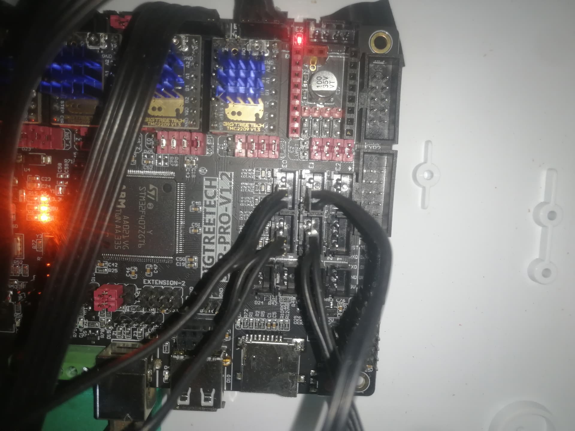

Something is strange here. Can you provide a picture of the endstop block on the control board? I just want to make sure you have them wired correctly. In particular, you want to avoid the voltage pin in each plug:
Also, I assume you are using the bare limit switches and not the ones on the circuit boards.
Though this would not account for the behavior you describe, be aware the switches need to be wired normally closed.
Note if you have any wire with Dupont connectors on the ends, you and manually trigger an endstop as indicated by both the LED and an M119. You want to short/unshort the GND and the signal pin on any connector. This eliminates the wiring and the switches and specifically tests the control board.

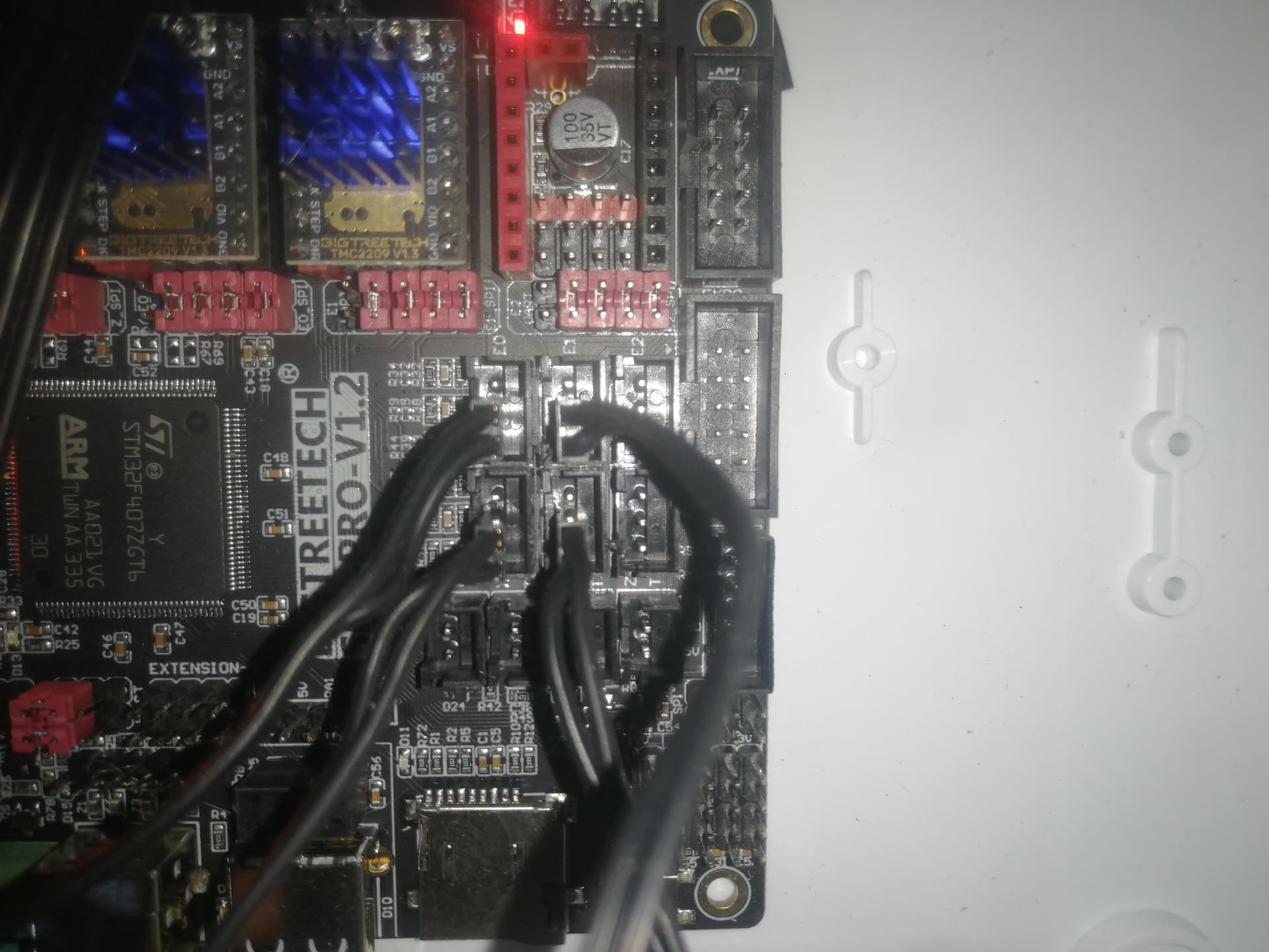

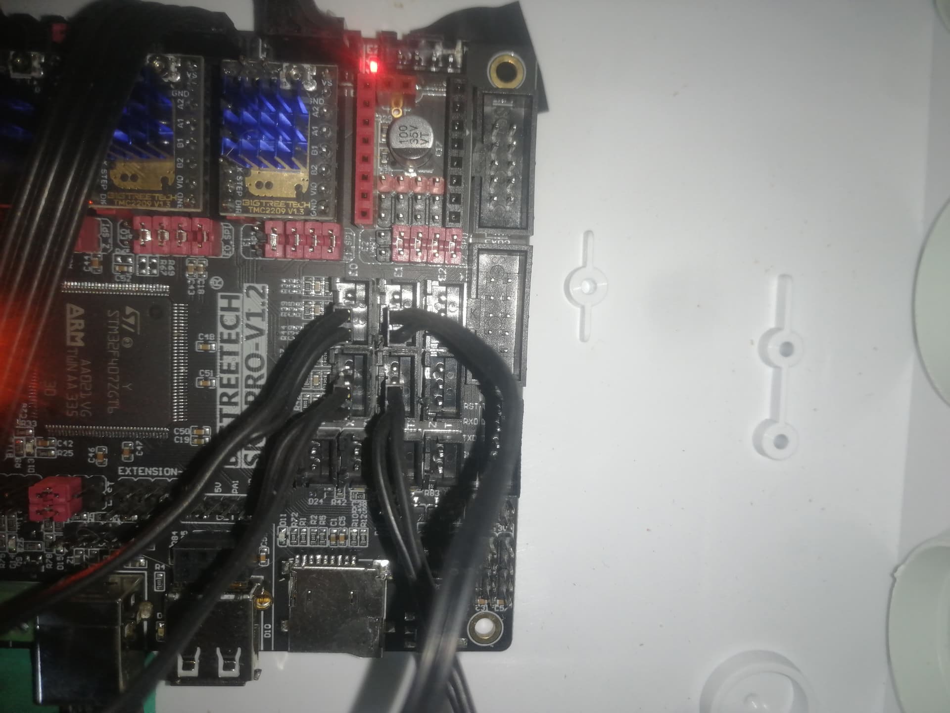

Here are pictures of end stop block.
Yes, I am using bare limit switches.
Shorting and unshorting the GND and signal pin still gives same output as before.
If the LED are changing state when the wires are shorted, but the M119 stays the same, then this is a hardware issue with the SKR Pro board. This is a known potential problem with the SKR Pro.
