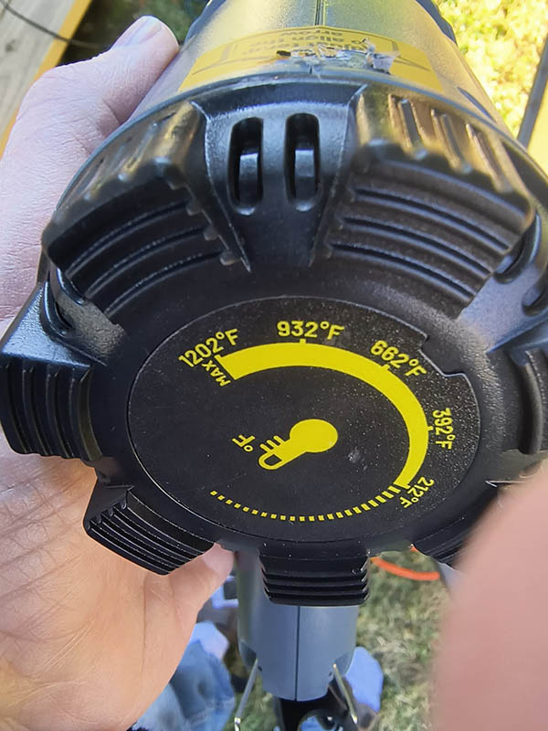

If the heat gun is temperature controlled then you’ll have output power varying with airflow rate, so more beans in will block more airflow meaning slower temperature rise, but also more beans means more total energy to heat up, meaning even slower temperature rise.
With the watt-meter on there and measuring the output temperature you should be able to see this by blocking the vents a bit. If the power stays constant and the temperature increases as you block the inlet vent then it’s uncontrolled. If the power drops and the temperature stays constant as you block the inlet vent then it’s temperature controlled.
If it is temperature controlled then that’s not the end of the world, but you’ll just need to be wary of choking the airflow with a batch of beans that’s too big, as it’ll have a compounding effect on temperature rise.

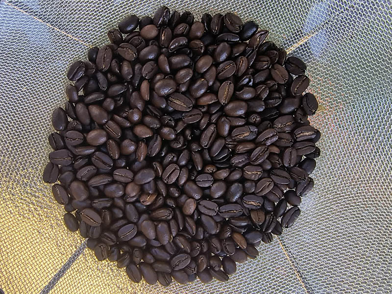

I hit 2nd crack, but beans still vary in color some. That seems to be that they are not getting mixed well. I used the battery screwdriver which ran at 17.5rpm. I lost maybe 6 beans or so. Think I will try another roast & turn down the heat some. This batch took less than 8.5 minutes. Some of those beans might have gotten a little burnt, but the roast smells good. I did a video of it and will post that later. Now I am going to try another batch with a little lower heat, the 6:1 gears and the 10” extended screen on top.
Interesting result. That timing seems like it’s too far on the high power side which I suspect would also increase variability. Those look a lot less variable than the last batch, although that much oil immediately after roasting means you’ve likely gone way, way past 2nd crack. That’s not surprising given the beans were likely increasing in temperature extremely quickly at that point.
I can’t remember what the general ‘ideal’ time is, I just remember that the popcorn poppers at 5-6 minutes were considered way too fast to let some of the caramelisation reactions occur properly leading to a lack of flavour development and the Behmor at 25 minutes was considered way too slow so it would result in esters breaking down and losing flavour.
I also vaguely remember that the generally preferred approach was to get the beans up to temperature very quickly and then slowly progress from 1st crack onwards. I think the goal of that was to minimize the time spent at elevated temperatures, in general, while drawing out the time spent in that 1st-2nd crack phase.

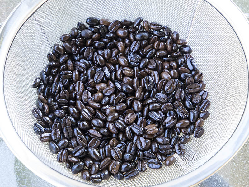

2nd roast of the day I change gears from the 9.5:1 to the 6:1 and turned the temperature on heat gun down from the max 1202f to about 932f and it took about 13 minutes. Not quite as shiny as the 1st batch but thought I might have gone too far with the 1st. It did smoke some near the end. Seems like I need a better way to mix the beans like I have seen in some the videos with this style roaster. Here is a photo of the 2nd roast of the day along with heat setting I used on the heat gun.
Is the power changing when you change the temperature setting?
I would think it would be, but I did not check that on the 2nd roast. I will just plug it into the watt meter tomorrow and see how it changes with adjusting that.
