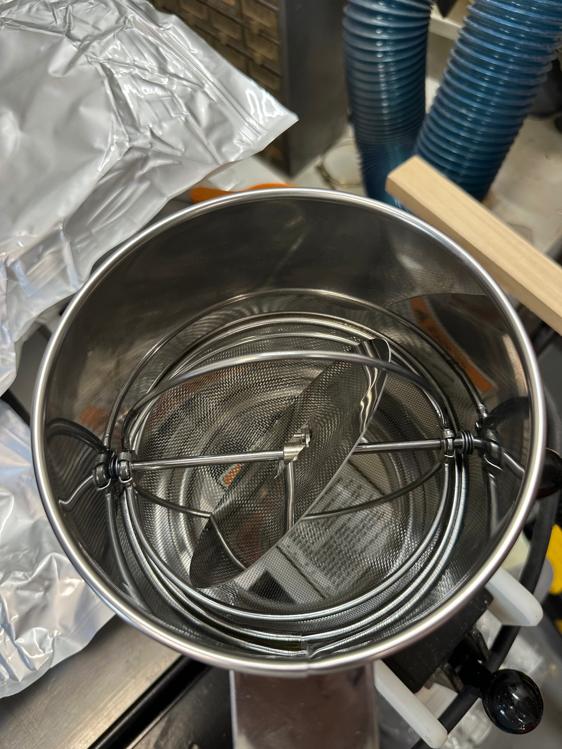

After ordering 100 feet of 22-gauge SS 316 wire, I might not need it after all. Think I might use that SS mesh I bought for the top instead and cut and bend it like shown in this photo since I don’t seem to need that. The 1.5” width center mesh will move it away from the heat and the outer blades will move it back in. I might put some painter’s tape on there first to see if it does what I think it will with some beans added.

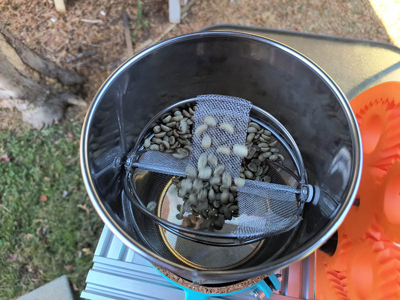

I did 2 different tests with the mixing of the beans today using painter’s tape as a mockup. The 2nd one which seems to mix the best to me is like the image shown in previous post. The 1st test has the tape all the way across on the sides like center is. I might should have done one more test with the center tape only on one side like the outside tapes.
I want to bend the inner agitators inward a little more since they are still scraping the bottom a little. Seems like over time the SS mesh or wire might wear out that screen and it does not really need to touch for my use.
I went ahead and did the 3rd method before it gets cold again tomorrow. Now I think the 3rd method is better. I made each method about 20 seconds long but made the 3rd method just a little longer.

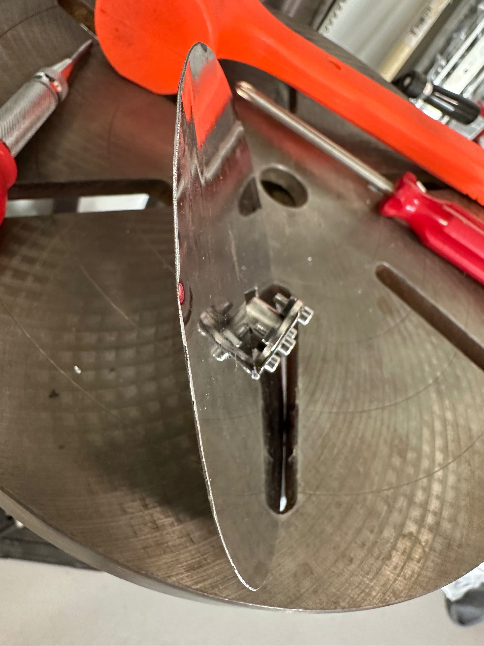

I took a stab at cutting the wire mesh for the internal paddles. I tried the 8 mesh SS first, but the weave came apart on one side. I was thinking if I had not had that problem, I could wrap around the center shaft and outer edge would just hit the closest outer ring wire when it rotates and the beans would push it against it. That did not work, so I am going to try cutting the 20 mesh SS I have today. I will probably have to wrap that around the center and one of the outer rings. If that does not work, I will go to plan C and try wire wrapping 22-gauge SS wire. My neighbor is really good at wire wrapping and will see if she can wrap it if this mesh does not work.

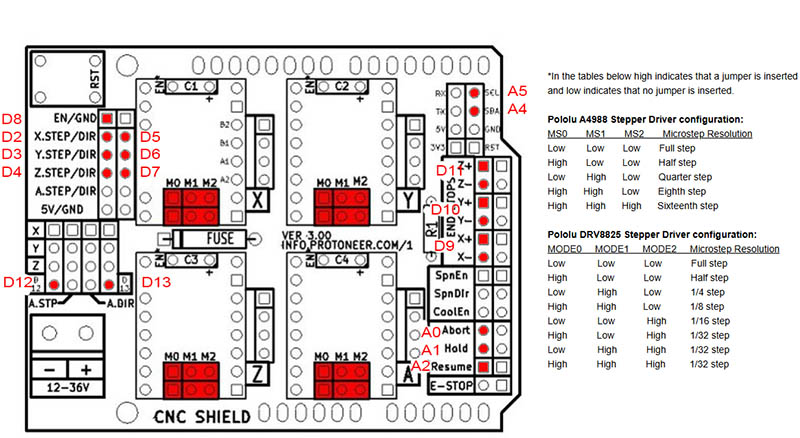

I’m still working on the electronics. I have all the Digital and Analog pins mapped to what they are on the CNC shield as they are labeled differently. I used this link for a lot of the information and a simple Arduino sketch to verify what I thought they were. Arduino Compatible CNC Shield Instructions
I created this image from that page and added the Digital and Analog pin assignments.

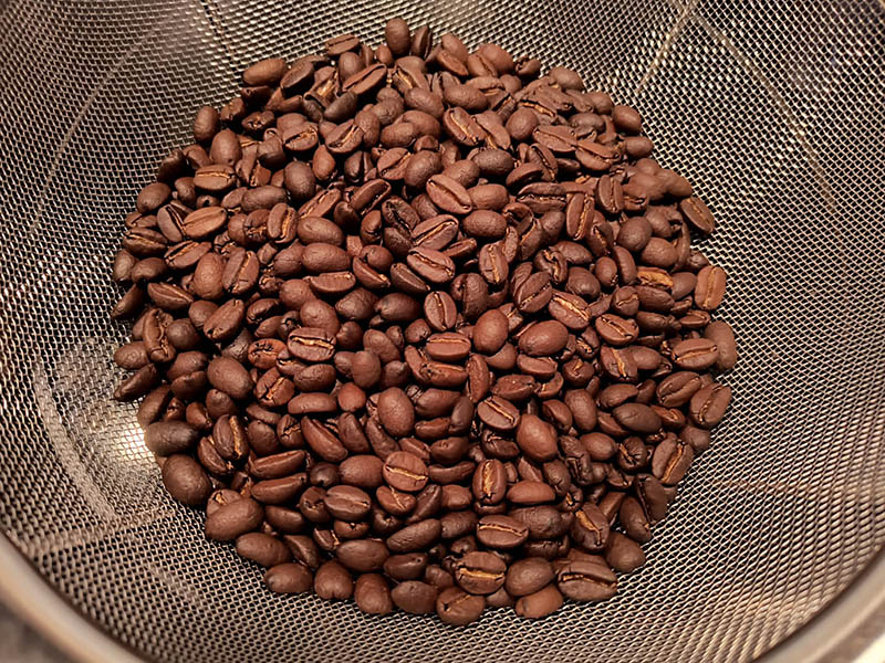

After 3 good roasts, I declare this machine a success. I still have some tweaking to do but works better than I expected it to. Here is a video of the 3rd roast I did today.

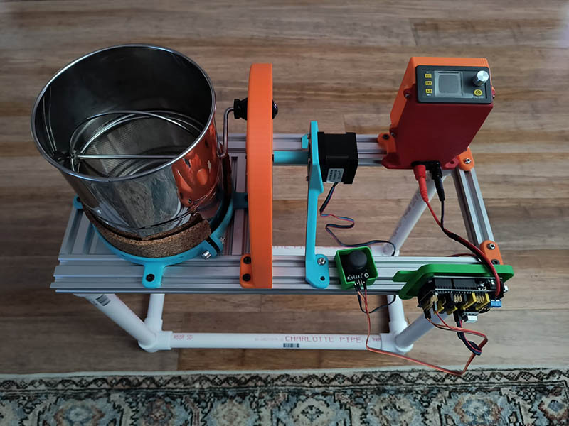

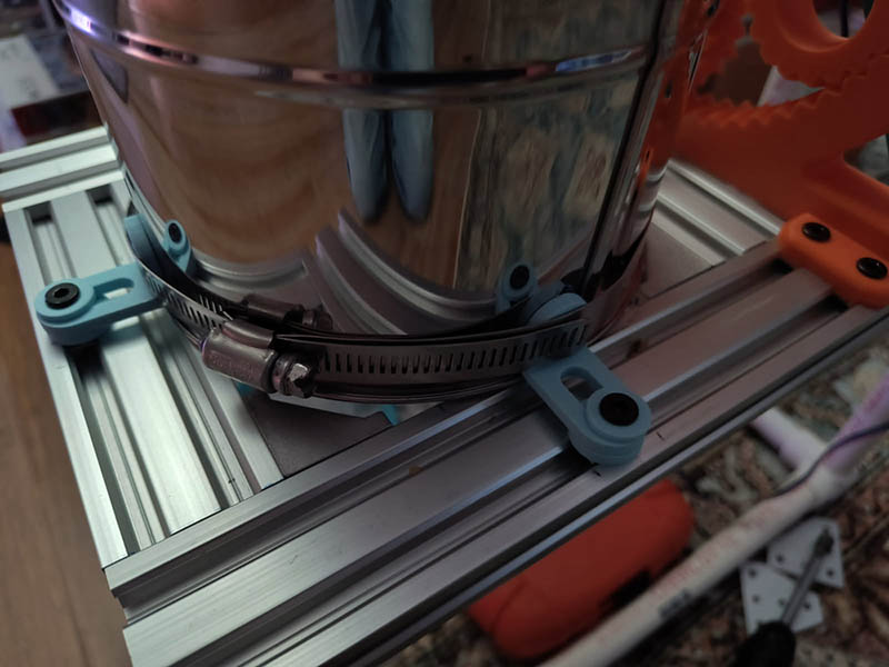

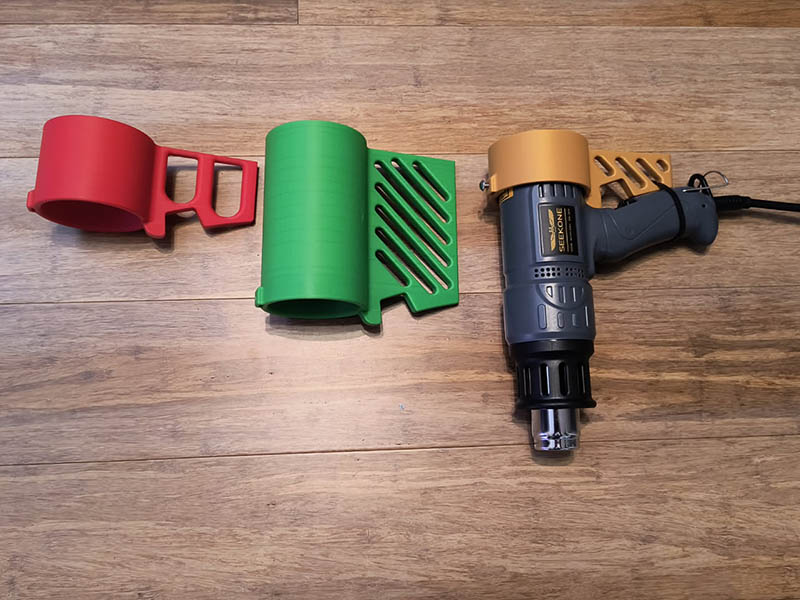

I did another roast yesterday using my same plastic clamping system since the L brackets have not arrived yet. Now that I am happy with the height of where the heat gun is, I shortened that bracket by 100mm and also cut 100mm off the height of the PVC pipe. That does make the heat gun less top heavy. I started out with the red mount when I tried the flared attachment on the heat gun. I would like to come up with some way to adjust the heat from the side easily without having to do it from the end.
I was doing 4oz (113.5g) batches before. I used 6oz of green beans this time and only had less than 4oz when the motor was bogging down. I guess some beans got caught. Since I had not done 6oz yet, I did a dry run without heat. To give the motor some more torque, I switched from the 3.63:1 gears to the 6:1 and that solved that problem. I changed the motor RPM to 180 to keep about the same drum speed of around 30 rpm. I was thinking it would take a bit longer to roast, but the time frames were within about a minute of being the same. I did pull the roast before it really started cracking as I was concerned about the temperature the cork was getting. It got to 169c behind the cork at the bottom whereas it was around 125c with the 4oz. I was thinking it would take longer to roast with the extra volume. Maybe my temperature measuring was different from the other roasts. I will not have to be concerned with that heat when I switch to the L bracket and band clamp. Here is a photo of the roasted beans. They might have a little variation in color.

Not clear the flour sifter I bought on amazon years ago still exists, but the shaft unscrews (from both a nut on the opposite side and one side of the “egg beater” is threaded on that end) - so I just bought a 5mm flange and ran the shaft through it. I just bought a little sheet of hobby stainless at the hardware store, don’t remember the gauge, it’s held pretty tight by the egg beater.

It doesn’t look like you’re using the Spindle Enable pin, but be aware that the v3.00 shield was designed for an older version of the grbl/gnea firmware. The newer firmware will work, and most everything about moving the stepper motors is fine, but to allow for PWM control of the spindle, they swapped the Z endstop and Spindle Enable pin in the later firmware configuration. No one ever updated the silkscreening on these boards.

Actually, I am not using grbl. I didn’t initially realize I could use this board without grbl or else I would not have tried all those different motor possibilities. This shield will run with just a standard Arduino sketch. I did run a test Arduino sketch to see what pins are available on the shield and you are right, no pin shows up for SpnEn. I tested each pin for being either A0-A5 or D2-D13. I just put a jumper wire from a GND pin to each pin in succussion and it displayed what pin it was if it was one of the pins in that array. A3 is the only pin that did not show up for me in that test, but I could solder a jumper wire on the UNO if I really needed another pin. D2, D5 & D8 are used for the X motor which is only motor I am using. A4 and A5 think I have to use for the LCD and the thermistors apparently have to use an Analog pin, so I am using A0 & A1 for those. I will probably switch to a thermocouple at some point instead of one of the thermistors. I might have 1 spare pin after the 4 buttons, 4 LEDs, LCD, buzzer and thermistors.

It’s been a long time since I looked in to “what’s new” with grbl, and now it looks like they’ve juggled the pin assignments again to enable self-squaring, but that breaks the PWM control for spindle speed/laser intensity.
