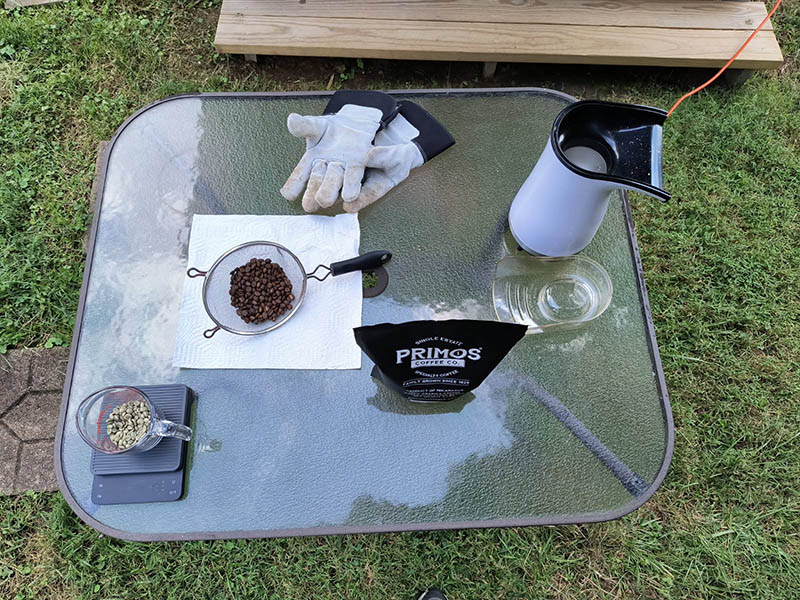

Here is my current setup.
There are several advantages to fresh roasting. The green coffee beans have a long shelf life & you can roast just the amount you need. I also understand fresher roasted coffee beans are higher in antioxidants. I did a google search with “is fresh roasted coffee healthier“.

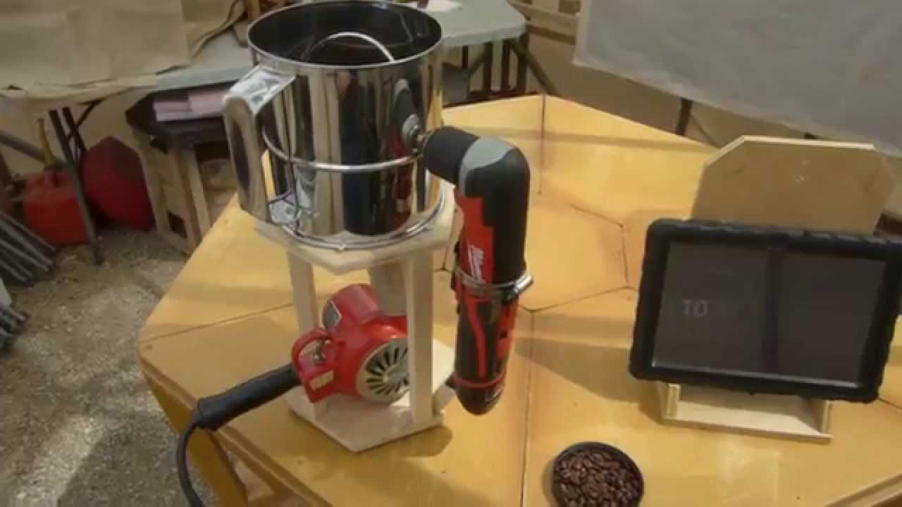

After roasting this way for a couple of months, I am searching for a more automated method & one that will roast more beans at a time. I was looking at maybe buying a dedicated roaster, but they are a little too costly for me. The method I like the best so far involves using a cranked flour sifter, heat gun & electric screwdriver to power the crank.

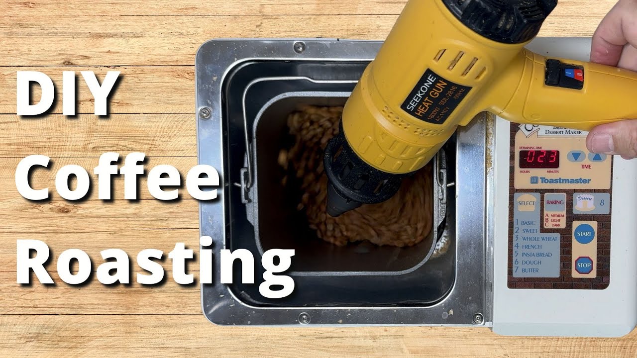

The method below using a bread machine with the heat gun is also interesting, but doesn’t seem to lend itself as well to automating
After looking at these ideas yesterday and bouncing some ideas off a friend, it occurred to me that an old 3d printer controller board could easily be used to control the temperature & speed of rotating the beans. With a google search of “what are ideal temperature for roasting coffee beans“, looks like the range is from180c to 250c within the range of a normal 3d printer thermistor. The heating part seems like it will be the most difficult and maybe dangerous for me, but I will be using this outside & not inside. I’m going to see if I can find a heat gun at a thrift store to take apart and see if I can go anywhere with this idea.
Anyone have some thoughts or concerns about this idea?
I like the physical setup of the Milwaukee one. You could make the heat gun work similar to an AC heat bed. You will still want a thermal fuse for over heat protection. The problem witha thermistor is that the air has no thermal mass. No matter what you set it to, the air is going to be hot when it’s on and cold when it’s off. You could make toggle the heating element and leave the air on all the time. But it will still heat and cool very fast. Where would you put the tememperature sensor? In the path of the air between the heat gun and the sifter?
You could easily attach a stepper motor through a gear to the sifter arm. Then programming different temperatures and durations would be pretty easy. Otherwise, skip the stepper motor and just attach a DC motor with a relay and drop the printer firmware all together. A PID loop would be about 15 lines of code and most of the rest would be the user interface.

I obviously didn’t know enough about the thermistor to realize it would not work in this way. For the flour sifter method, I would have to put it through the side near one of the connections of the rotating sifter as it would be in the way of it anywhere else. Guess I need a different kind of sensor though. I have not bought anything yet, so still have time to change my mind on what might work better.

Here is my current method & seems to be working well for me.
I measure 76 grams of green beans which is supposed to be about the most you can do with a popcorn popper & 76 grams splits a 1 lb bag into 6 batches. I usually do 2 - 3 batches. 1 lb of green beans comes out close to 12 oz of roasted beans.
  1. I turn the popcorn popper on & let it heat up for about 10 seconds, then pour the beans in & shake it for the 1st 10 seconds & leave the popcorn popper plastic top off for the 1st minute.
  2. For the first 2 minutes I shake the beans every 30 seconds. After that, once every minute for about 5 seconds.
  3. I wait for the 1st crack to end which is usually less than 7 minutes. Some beans, I have hardly heard crack at all.
  4. I’ve been going at least 9 minutes because if they are roasted too lightly, I have noticed too much earthy taste to them. I err on the side of going too dark, but I have not burned any yet. I also watch the color & make sure it looks about the way I want them. The last 2 types I roasted were 13 and 14 minutes to final.
  5. 10 seconds before the time I have decided to stop the roast, I pull the cover off, turn the power off & dump the beans in a stainless-steel colander.
  6. I then hold them over a small fan shaking them. It takes about 3-4 minutes for them to cool to room temperature.
It is actually quite easy to roast with the popper & the only thing I had to buy other than the green beans, was a $20 popcorn popper, a $20 coffee scale & timer & a $5 colander. I would just like the automate the process a little bit & be able to roast 2 - 3 times more at one time. Interesting thing I discovered about the coffee scale/timer is the timer will shut off after about 13 minutes if I don’t tap the scale & it doesn’t say that anywhere. It must be a normal thing because I sent back a different brand because it did that.
After roasting a couple of batches of Guatemalan beans while monitoring with a digital thermometer, looks like I will not be able to get it hot enough for 2nd crack. It was mostly in the 160-180c range an occasionally dropped down to 110-120c which I am sure is the safeguard circuitry. I did see it go in the low 200c range & spiked to 220c once or twice. There are quite a few people that have modified the circuitry on these to get them hotter, but I’m not going to do that.
I’m glad I bought this thermometer as it did give a better idea of what is going on with the roasting & limitations of the popper. I did adjust my procedure after discovering this. I stop shaking the popper once a minute after the 4 minutes to keep it hotter. Most of the chaff has also flown off by then.
