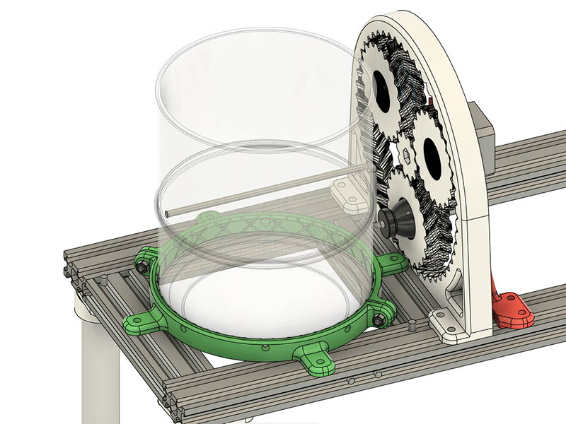

I was spinning my wheels trying to get the motor & controller to work Friday that I ordered from Amazon. It would just run intermittently. I finally tried the motor by itself hooked up to 12v and it worked perfectly. The controller must be defective, so I sent it back. I did get a chance to test the speed difference between the 3 different ratios of planetary gears I had printed & made a video of them.
The ratios appear to be:
9.27:1
6:1
3.64:1
I pulled the pancake nema17 off my bamboo pen laser engraver & will work on getting that to run with this.
I did some temperature testing today. Before doing so, I did change the plastic V-slot brackets to metal & left the flour sifter plastic clamps off for testing. Looks like those plastic clamps may not get too hot. I was measuring around 40c on the face of the outside of the sifter and I could easily touch it with my hand. It was about 50c near the top on the outside face. I initially set the heatgun to about 600c, but didn’t get hot enough, so I set the temperature all the way up. I wasn’t getting high enough reading with the flour sifter in place & probe at the bottom of the sifter, but temperature probe was showing 250c & spiking to 290c occasionally at the same height as the bottom of the sifter. It was 53f (11.6c) outside temperature.
Doing the electrical always slows me down, but the directions seem straight forward. After I get this motor working, I’ll actually try roasting some coffee if outside temperature is warm enough. I’m getting ChatGPT to give me the wiring and Arduino code. What I have checked so far seems pretty accurate. I’m initially going to breadboard an Arduino nano, 1602a display, DRV8825 with a potentiometer (show motor RPM speed for now). I also have an Arduino UNO, but nano takes up less space. Which step rate would be best for this DRV8825 driver?

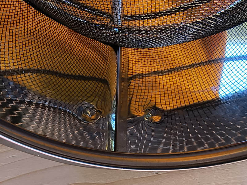

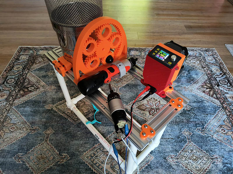

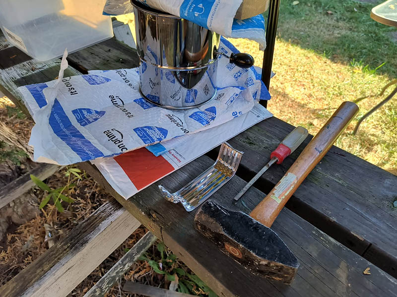

I finally had to modify the flour sifter a little with a big hammer and chisel. The handle is just in the way to put the top stainless-steel mesh on. It only took a couple of big taps with the hammer on each dimple. Not sure if I will do anything with those dimples.

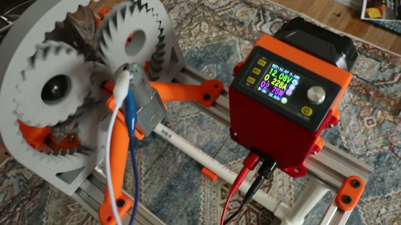

I realized yesterday that I have a couple of B&D Model 9078 Type 1 3.6v (180rpm) pivot drivers and one of them has a dead battery. I took the bad one apart and hooked it up to 3.6v and seems to run the gears good. I am printing a bracket for the good one first, but the one that uses the portable PS might be a better long-term solution than the other one since that battery could stop working in the middle of a roast, but will try the one I did not disassemble first as I am not sure how I want to connect the wiring to the gutted one. I was testing how strong the motor was by trying to stop a gear with a finger and almost hurt my finger. That was the motor torture test.
You can also see the stainless-steel mesh in this photo. It extends 10” above the sifter and overlapped 2” on the sifter held on with a stainless-steel band clamp. I am using some 22-gauge copper wire to thread in the overlap for a smoother mesh surface.
Okay I love this. It has a steam punk type of thing going on but…3d printed. Maybe we are in a new era PrinterPunk.
I had not really thought about it being steam punk.
I tested my new setup today and looks like I need a better clamping system. Those plastic clamps just don’t keep it from rotating around. I looked at clamping some aluminum plates down over the lip on 4 corners of the V-slot but looks a little kludgy. Think I really need to drill 3 holes in the flour sifter below the sifter mesh and the right height to use 3 aluminum 90-degree corner brackets to pull it down against the v-slot. I just have to figure out the best position and way to drill these. I will definitely create a 3d printed drill template for it. Maybe I will make a 3d printed mockup of the bottom of the sifter before attempting the drilling.
Here is a video of the latest test.

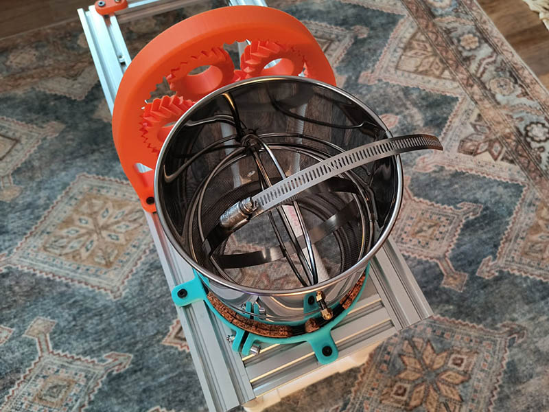

I had several ideas of how to clamp this flour sifter down securely and this is what I am going to try next. This seems like it will work if the plastic does not get too hot. I added some inside knurling all the way around the inside to vent any heat better. The holes along the circumference of the band I initially had because of an earlier thought to drill M5 holes in 4 spots and secure it with a 90-degree metal bracket to the V-Slot.
Just use ABS/ASA. :smiley:
I had seen where someone had wrapped the top of their roaster in cork as a shim to put a glass chimney on, so I looked up how much heat cork panels can withstand, and it is 248F (120c). It should not get anywhere near that hot at that location. That will make a nice gasket to tighten the brackets against also.
Using that new clamping system with the cork keeps the sifter quite secure, but now my old problem of the inside wire cage scraping and sometimes catching the bottom of the sifter is the main problem now. I was thinking about how I could bend them just a little bit, so they no longer touch the bottom mesh. Initially I was thinking of using my 16” channel locks and then realized this stainless-steel band clamp might be perfect for that. Alas the 5”-7” clamp I have is right at 5” limits of what I need. I might could have wrapped something in there to get the extra length I need, but I will just go get at 4”-6” clamp tomorrow which should work. Just 1-2mm of movement is probably all I really need.
I 3d printed some spacers to give me another 10mm of circumference to compress this agitator. After looking at the inside more carefully while manually turning some beans, it seems like the real problem with the beans getting caught is around the lip of where the bottom mesh is attached to side. It is really only happening on the seam side of the flour sifter which now makes sense why it worked better when rotating the beans counterclockwise. Since it might be warm enough this afternoon and I have enough confidence in trying a roast, I will probably try a test roast today with manually turning the crank.
Here is a video of me trying to compress the agitator.

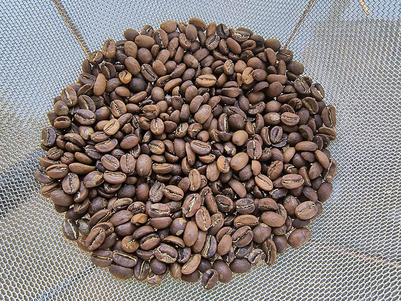

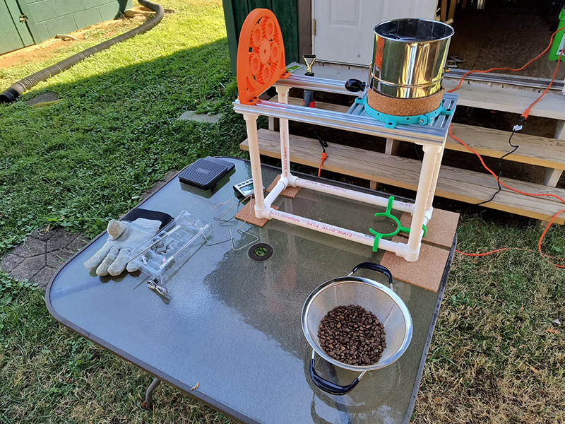

I did my first roast with the flour sifter in manual crank mode. I learned a few things, like @jono035 said that flour sifter will get hotter with the beans in there and it did get really hot. I measured 95c-103c at the bottom outside inside the cork. I had the heat gun set to the highest setting. I measured about 85c at the plastic clamp that was an 1/8” away from the sifter & had no cork in front of it but doesn’t look deformed yet. I continue with long term, I will use ABS for those clamps as I can easily print that. I am sure glad I protected that plastic with the cork. I didn’t smell anything burning, so the cork didn’t get too hot. Google search says it should be good to 120c which it might get that hot there. The popcorn popper is still a lot simpler than this method so far. it was simpler to cool the beans with the sifter. I just substituted my fan for the heat gun when I stopped the roast. If I end up scrapping this project, I could use the flour sifter as a good way to cool the beans with the popcorn popper.
I did not put the 10” extra height of mesh at the top & did not have any beans go flying. I tried different methods of turning at first, just going back and forth and different speeds, but probably around 20rpm would be a good speed and only CCW. I didn’t hit 1st crack until probably 15 minutes. It is usually around 4-5 minutes with the popcorn popper. I let it run to 35 minutes before stopping it. It did not seem to look much different between 30-35 minutes. In the beginning the beans started changing color they varied in color quite a bit and think that was because I was not rotating a slow consistent movement. In the final roast they also look like they vary from a brown to a dark brown. I was hoping for 2nd crack but did not get that hot. I think the longer roast time is partly due to me moving the beans too much early on. I used 113.5 grams of beans which comes out to 4oz. I only use 76 grams (about 6 batches per pound) with the popcorn popper which is around the max people recommend using with that.
I am going to do another roast tomorrow with the heat gun 2” from the bottom of the flour sifter screen and not have the flared nozzle attached. For this roast the top of the flare was about 1.75” from the bottom of the screen. I believe @jono035 mentioned it might work better without that flare. I might keep the fire extinguisher close by this time as the outside surface of that sifter got hotter than I expected. Since I did not really have any problems with beans jumping out of the sifter today, I am going to hook up the B&D pivot driver running CCW using gear set that is about 9.3:1 ratio which when I just test it turns about 17.5RPM which seems like a good speed for the next test. I will use the same amount of beans to at least keep the variable the same. I will test it rotating for about a minute without the heat to make sure it is working reasonably well.
That’s super strange that it took that long to get up to temperature. You should be seeing 10-15 minutes to 2nd crack, ideally. It takes about 25 minutes for a 1lb batch in the Behmor and people rag on that for being too slow.
Is the hot air gun a temperature controlled one? If so, that may also be part of the issue, behaving similarly to the over-temp cutout in the popcorn popper.
It may also be that the exhaust plume is pulling some extra cool air in. I would try to get a thermocouple in there and see what’s going on, both in terms of outlet temperature from the gun and air temperature around the bean mass. Perhaps trying to put a temporary extension on the top might help, even if it’s just made of cardboard.
Those beans also look like there’s a lot of variability in the colour… Some look very light and others quite dark… Do you think the stirring is enough to keep them moving completely evenly or are some potentially staying ‘underneath’ the stir bar for a while before being picked up?
