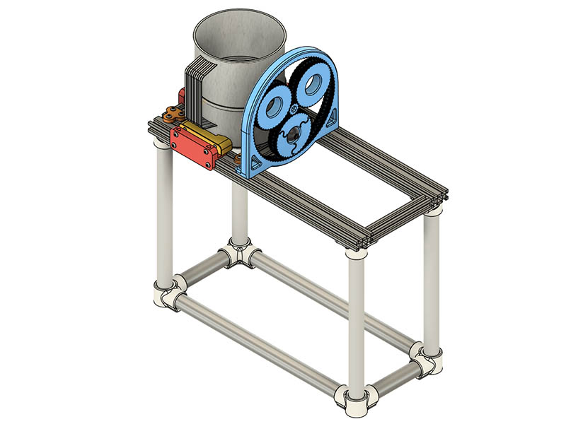

There’s no harm to slowing down the motor with the motor controller, the issue is that you lose significant amounts of torque with an open-loop controller like that, it’s basically just applying less voltage to the windings. As long as the motor doesn’t stall, you’ll be fine. Given that you’ve already got a gearbox there, I’d say that’s the most logical way to address it.
I would look at putting a taller chimney on in some way, even if that’s just cardboard/wood/whatever. Having the top be open is great for getting chaff out of the coffee while it’s roasting, which a mesh lid will instead catch and potentially clog. Either way, I’d give it a try if you’ve got a sieve that’ll fit, just be wary.
Yeah, I would definitely do a few roasts by hand and get an idea of how the whole thing works out that way. I would think more agitation is probably better, to start with, so keeping that speed and keeping the beans in is where I’d be going.

This design is actually coming together a lot quicker than I thought. Seems like I have only been working on the actual design of this for about a week.
I guess it is a lot more difficult to calculate the gear ratio on planetary gears. I am printing a new planetary gear with a sun gear of 10 teeth & and 3 planets with 30 teeth each which according to ChatGPT gives me a ration of 3:1. My current design has a sun of 21 teeth & 5 planets of 18 teeth and outer ring of 58 teeth which I was thinking was close to 1:1, but ChatGPT says it is a 3.76:1 which is more reduced the design with the smaller teeth for the sun. It is apparently the combined effect from rolling between the sun gear & the outer ring. Guess I did learn something today.

I did not count the teeth on the ring before as this openscad script calculates that based on the outer diameter you give it. Looks like I might have a 5:1 ratio with this new print of a sun of 10 teeth, planets of 30 teeth & ring of 50 teeth, so worthwhile printing after all.

I would guess that your difficulty is that the center of rotation for the planets is fixed if you want to drive the handle directly.
So your turns ratio should be S / ( R + S) where S is the number of teeth on the sun and R is the number of teeth on the ring gear. The number of teeth on the ring gear is 2xP + S so if you want it in terms of planet teeth that would be R = 2P +S so the turns ratio is S / (2P + 2S).
The radius of your crank needs to be equal to the reference radius of your sun gear + reference radius of your planet gear. So we can say that Rsun + Rplanet = Rcrank.
The diameter of each gear is the number of teeth multiplied by the modulus, so the number of teeth on each gear is the diameter divided by the modulus. S = 2Rsun/m while the number of teeth on the planet gear is 2Rplanet/m.
Subbing that all in above gets:
2Rsun/m / (22Rplanet/m+22Rsun/m), which simplifies out to Rsun / (2Rsun + 2Rplanet). We know Rsun+Rplanet = Rcrank so that works out to the gear ratio being Rsun/2Rcrank.
So if we test that with Rcrank = 100mm, Rsun = 50mm, that would give us Rplanet = 50mm and they’d both have the same number of teeth. That would give us a ratio 1/(2+2) or 4:1, so 4 revs of the sun to 1 rev of the planet carrier, which is what it should be according to a calculator. Likewise, Rsun = 25mm gives us Rplanet = 75mm and a turns ratio of 1/(21+23) or 8:1, which also works out according to the calculator.
So you should be able to get any gear ratio you want pretty easily by varying Rsun and then defining a gear modulus to match, or by selecting Rsun such that both Rsun and Rcrank-Rsun result in integer numbers of teeth for the modulus you’re using (2Rsun/m = integer, 2(Rcrank-Rsun)/m = integer).
Working the other way, if you wanted a 10:1 ratio, you know Rsun/2Rcrank = 0.1… So if that’s a 100mm radius crank, that’s a 20mm radius sun. If you’re using module 5 gears then that’d be 2Rsun/m teeth or 8 teeth. Rplanet = Rcrank-Rsun so 80mm or 32 teeth. Rring would be 2*Rplanet+Rsun = 180mm so Nring = 72 teeth. Throwing that in to the calculator, that’s 10:1.
I started writing this before your edit with the online gear calculator, which is probably a better way to approach this, lol.
Thanks for the detail explanation. That helps me to understand it a little better. I know ChatGPT sometimes has errors, so it is good to have a formula to double check it. The Crank radius is 54mm. My 7-hour print came out well overnight & I put a tape marker on the sun & a planet to manually check the ratio. It came out to 6:1. Using your formula as a starting point, I worked on a 10:1 ratio. I could probably go to 10:1, but sun gear would be pretty small at 8 teeth. I asked ChatGPT for a spreadsheet formula for this and got:

N_s = 27 teeth
N_r = 81 teeth
N_p = 27 teeth
This assumes a module of 1, but the openscad script from Gear Bearing by emmett - Thingiverse
calculates that module tooth geometry from tooth count, pressure angle, clearance, and pitch diameter which came out to 1.97mm from my variables according to ChatGPT. I modified that script some to make it simpler for me to edit.
With a sun gear of 10 teeth, 3 planets with 40 teeth and ring teeth of 92, it comes out to 10:1 with both ChatGPT & your formula, so I am printing a 10:1 planetary gear today. Tomorrow or Friday I can test all 3 ratios with the motor to see which one works best.
I added a little debossing to the one gear for it to stand out when rotating. I will have to come up with a little better graphic if I print it again.

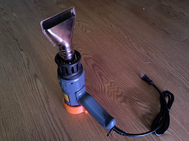

On another note, I decided to see how much it would cost for a 304 stainless steel 3d print of a simple funnel. It started out at $379 for a 90mm tall funnel 2mm thick. I got it down to $247 at 50mm tall and 1.5mm thick. So, I won’t be doing that. I used PCBway for the quote. Shapeways was over $1000, but used 316 stainless as it didn’t show 304.
I think this stainless-steel funnel will probably work. I might have to add some metal spacer on the heatgun to raise it up a little except the metal spacer would be resting on a plastic part of the heatgun & might melt it.
Amazon.com: Canning Funnel for Kitchen Use, Wide Mouth Funnel for Mason Jars, Large Canning Funnels for Filling Bottles : Home & Kitchen
The motor & controller came in today & will try that tomorrow. I was looking at the accessories that came with the heat gun & think I might not need a funnel. This will spread it out about 3”. A conical spread would probably be better, but this might work.
I don’t think a cone will actually ‘spread’ it out, anyway, as the air is leaving the nozzle with a certain velocity. You could just blank off the bottom with a bit of plate and cut a hole for the nozzle and it’ll likely to do the same thing. If you actually wanted to spread it out, I suspect you’d need to do something like the above or pass it through a diffuser anyway, which will then get f’n hot!
As long as there’s enough bean mass in the way then I think that’ll diffuse it inherently, anyway, and then as long as there’s enough agitation things should get heated evenly. I think that’s one of the advantages of the fluid bed method, it should be relatively forgiving of that kind of situation.
