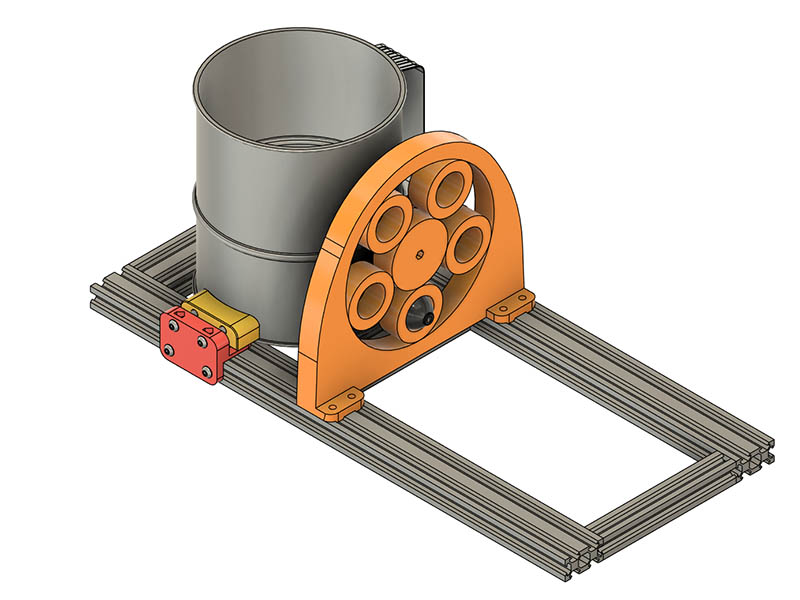

I found a couple of little motors in my supplies to try when I get to that point. I will consider straightening the shaft plan B. I think the planetary gear system gives the design a little more character. I designed the clamping system for the sifter today, using a CNC clamping design as a starting point. I show this photo with 2 clamps but could add a 3rd if that is not enough. I will 1st test it with 2 and also to see if it gets too hot for the plastic. I could print the push clamp part in ABS to give it a little hotter tolerance.

A sheet of aluminium foil over some cardboard works well as a radiant heat barrier and insulator if you do need to keep the plastic cooler. I’d guess you might end up with a fair bit of radiant heat coming off it.
Thanks for the tip. That might be all I need. I have the top frame all together but used 3d printed V-slot 1040x140mm lengths for the cross ties until I am sure that is the size I want before cutting the extrusions. I am sure I could not get away with plastic ones there. I have been researching looking for a stainless-steel funnel to put over the top of the heat gun to spread the flame evenly. i found some that might work that are used for filling mason jars, but they are about 2” or so at the small end. About 1.5” would be better. That actually might be a good use case to get 3d printed out of stainless steel since it does not use a lot of material. I didn’t price it yet though.

The 7-hour planetary gear print came out well & fits like a glove. I also change the 4 brackets holding the 2040 cross ties to the long 2040 sides. They were pulling apart when I tightened the flour sifter clamps. I also added another flour sifter clamp on the end & widened the one on the flour sifter handle side & cut a little gap in that one. This planetary gear system seems to work quite well now even at very high speeds. Here is a video of the 2nd test.

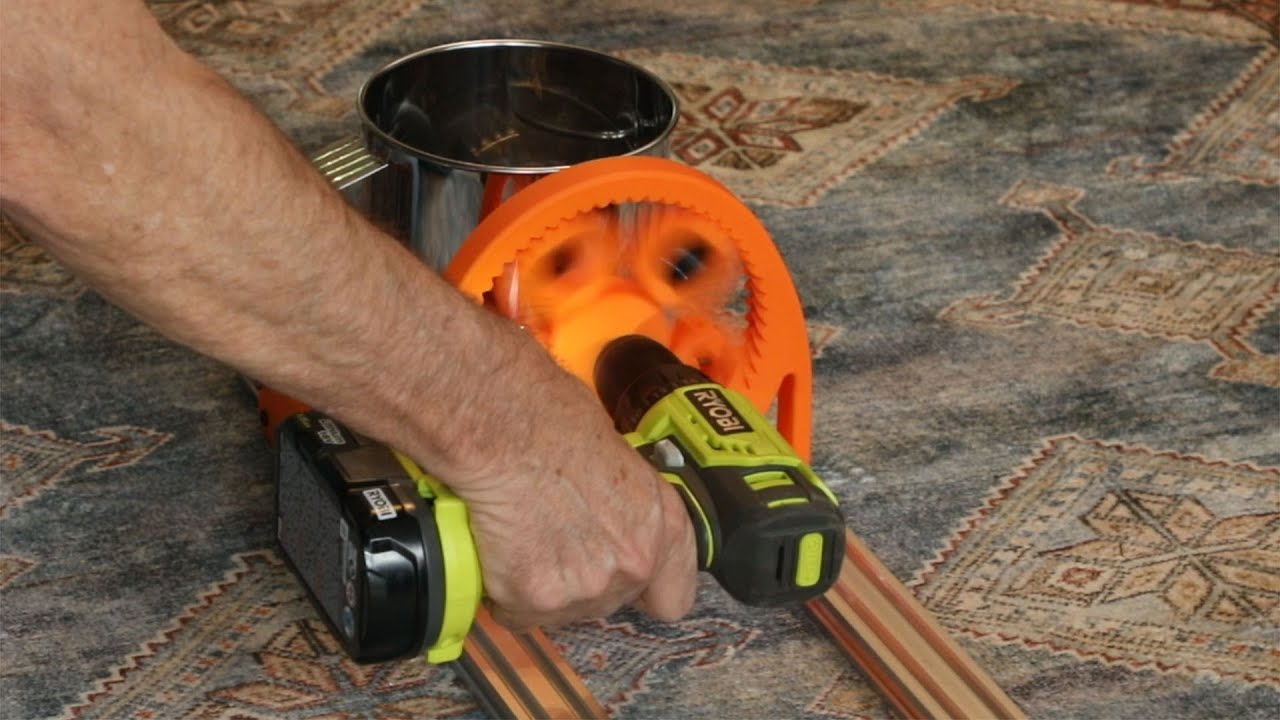

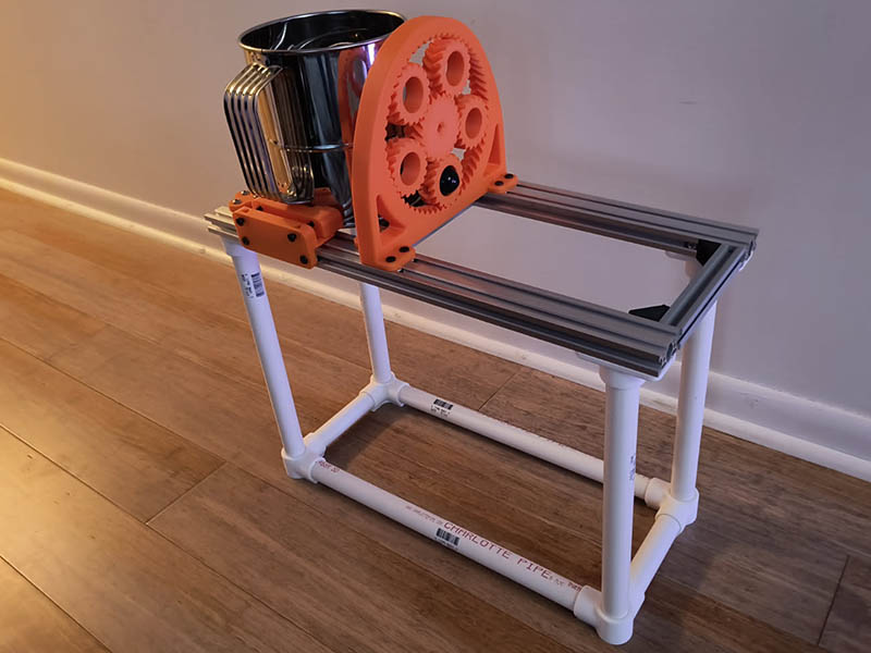

I was in my shed today & realized I had a lot of PVC around from another project & decided to see if it would work for a stand. After trying the drill test again, it seems sturdy enough and should be far enough away from heat. Now that I have a stand, I can try some heat tests to see if the plastic clamps are affected.

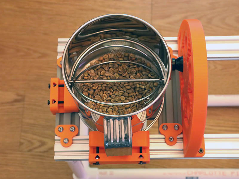

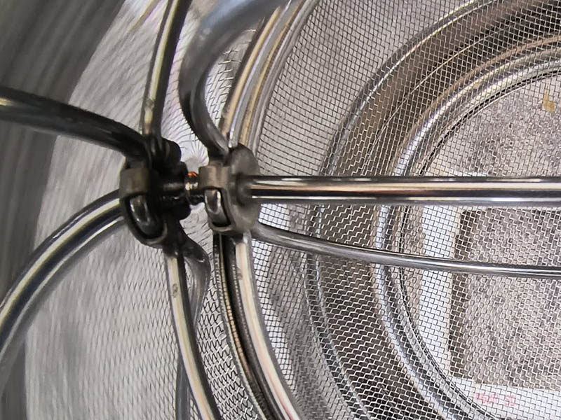

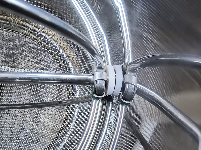

I might also have to modify that flour sifter after all. I put 6 oz of green coffee beans in there this morning to see how well they turned. I really should have done that 1st thing into the design. Turning it too fast will definitely throw some beans out which I sort of expected. Even turning slowly, the agitator catches the beans sometimes and they go flying. If I can get the agitator bent just a little bit so it doesn’t actually scrape the bottom screen it would probably work better. I needed a flour sifter with this defect. The crank shaft going straight through is 5mm with a 5mm nut holding it on. The internal agitator is attached somehow to that shaft and will not slide out. I really don’t want to give up the planetary gear. I am rotating the planetary gear 180 degrees & changing the mid V-Slot brackets to allow for it. Think I need to do that to have room to put the motor mount on.
Here is a photo of the inside of the flour sifter with 6 oz of green beans. That is about 3x the amount I can roast at a time with the popcorn popper.
Here are a couple of photos showing the inside connections of the agitator.
I’d just put a mesh lid on top to keep the beans inside and let them bounce around.
Thanks, that might be the perfect idea. While walking today, I was thinking that 150rpm motor might be way too fast since this agitator hits the beans 4 times per revolution. How much slower can you run those motors with the speed control without harming the motor? I was trying to think of some type of lid to use but wanted to be able to see the beans. I had forgotten about this video where a guy did something similar to that on a popcorn popper.

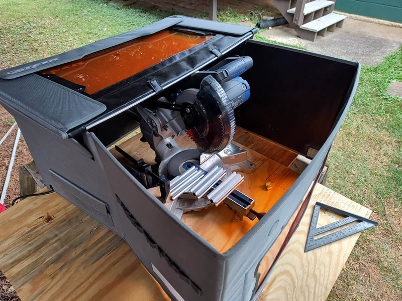

I finally cut the 140mm lengths V-slot today. I have a Kobalt 7 1/4 miter saw I use, but it always messy. Today I decided to use the cover on my laser engraver to keep all the metal in one place & it worked quite well.
