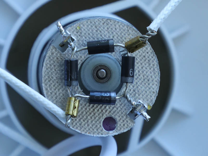

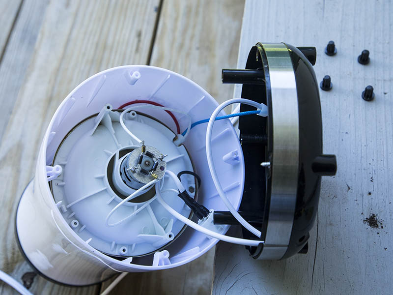

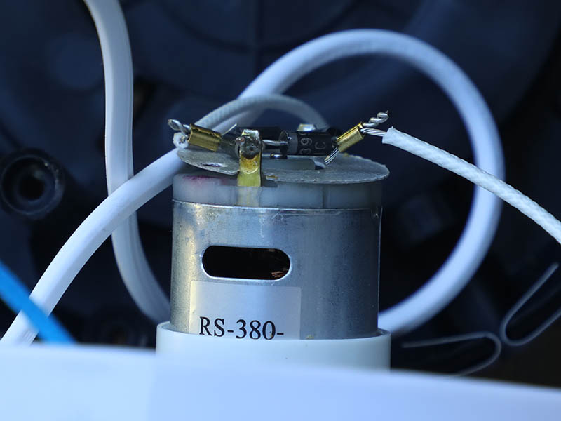

We’re visiting my wife’s brother and I did one roast with the popcorn popper yesterday to show him how easy it was. He’s going to start looking into getting a roaster now. When I get home, I might take the nastalgia popper to see how it can be modified. If I accidentally break it, might prompt me to get a real roaster.
I took the Nostalgia Air Popper Popcorn Maker partially apart today by taking 6 screws out. 2 slightly longer screws hold the bottom base to the inner part & 4 screws under the rubber feet hold the bottom base to the outside top. The little rubber feet just pried out with my fingernail. I started to disconnect the 2 wires to the switch, but they were not coming out easily & I did not want to accidentally break them. One of the white wires coming through the black base connects to the bottom connector on the white switch. Here are the photos I took. Not sure I want to tackle modifying this. I am leaning towards the flour sifter heat gun method if I go DIY.

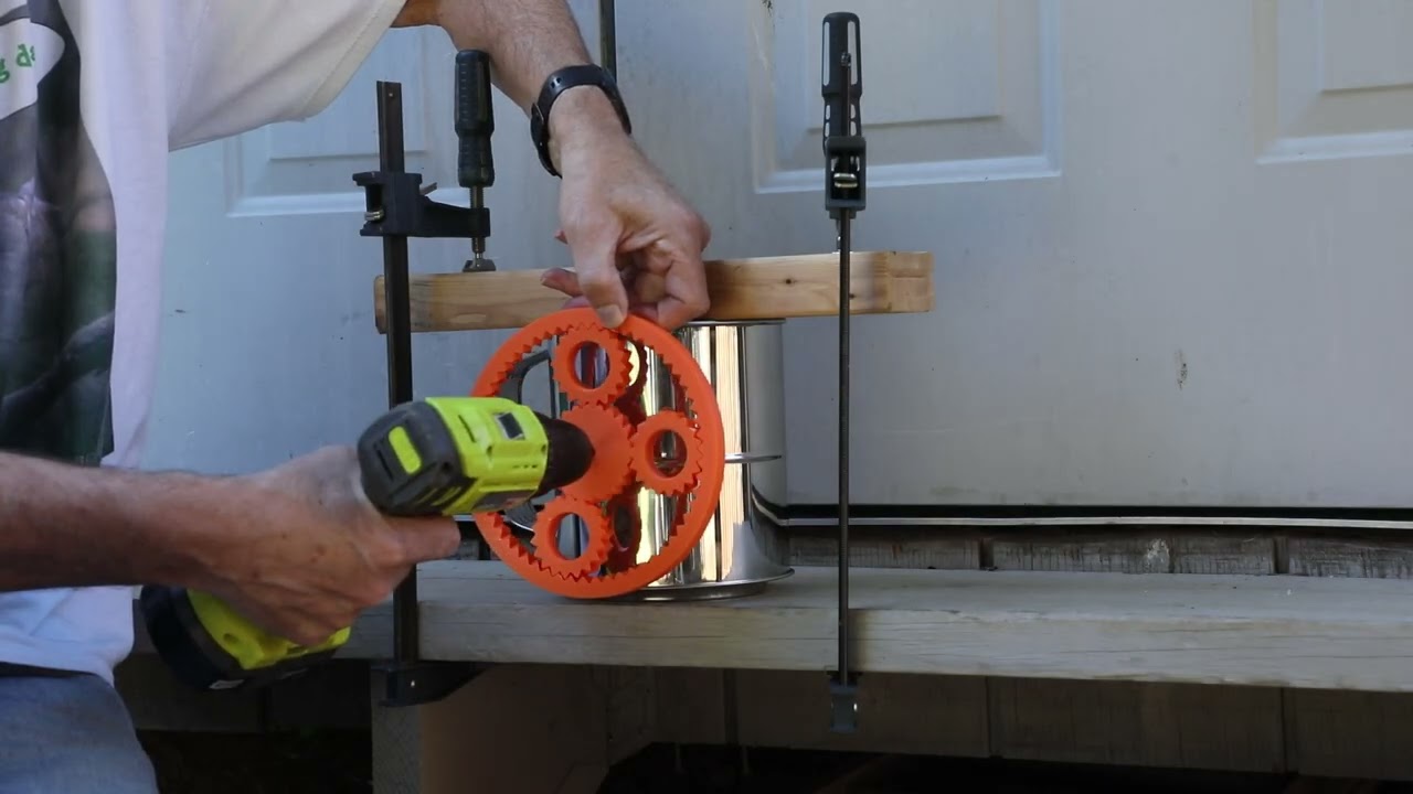

I decided to go ahead and order a heat gun & an 8-cup flour sifter yesterday. It will be here Thursday. I will probably just set it up for manual turning to begin with & just make a platform to put the sifter on. I have a lot of V-Slot, so will probably use that for the structure of the platform. I would like to make it a non-destructive build, so I don’t really modify the heat gun or sifter.

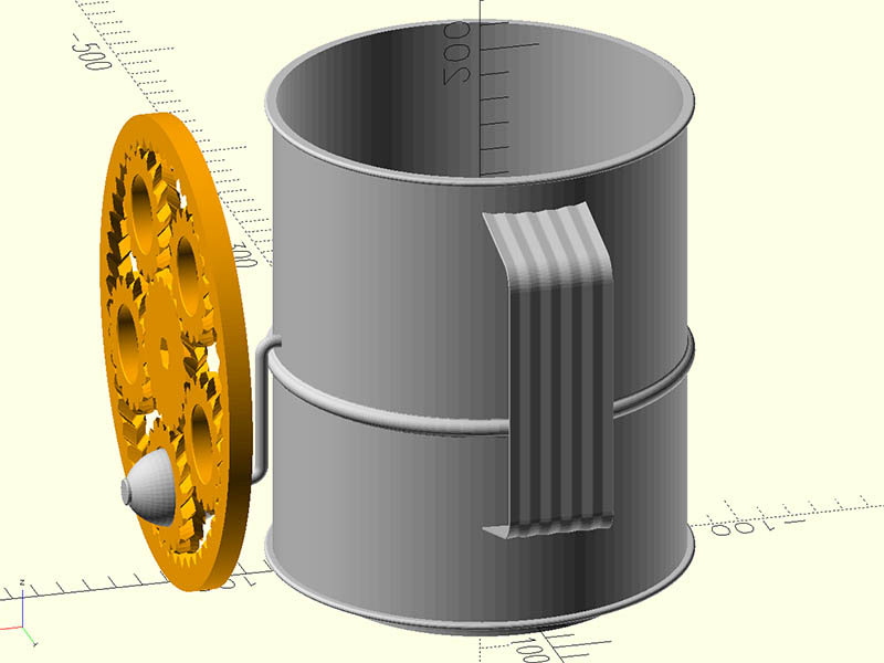

Parts came today. I have been thinking about how to drive the turning of the handle without dismantling it & am thinking a planetary gear might work if it does not wobble on me. I drew the planetary gear in openscad since there is a very good script to easily do that & I drew up a model of the flour sifter in fusion 360. Think I have some M6 set screws & would use that to tighten the crank knob to one of the planets. Currently I have it at 9mm thick but making it thicker might make it wobble less. It is about a 3.5-hour print like this.
The 1st test of the planetary gear system for turning the handle worked better than I expected. Here is a video of the 1st test. You might get a little laugh near the end of the video.

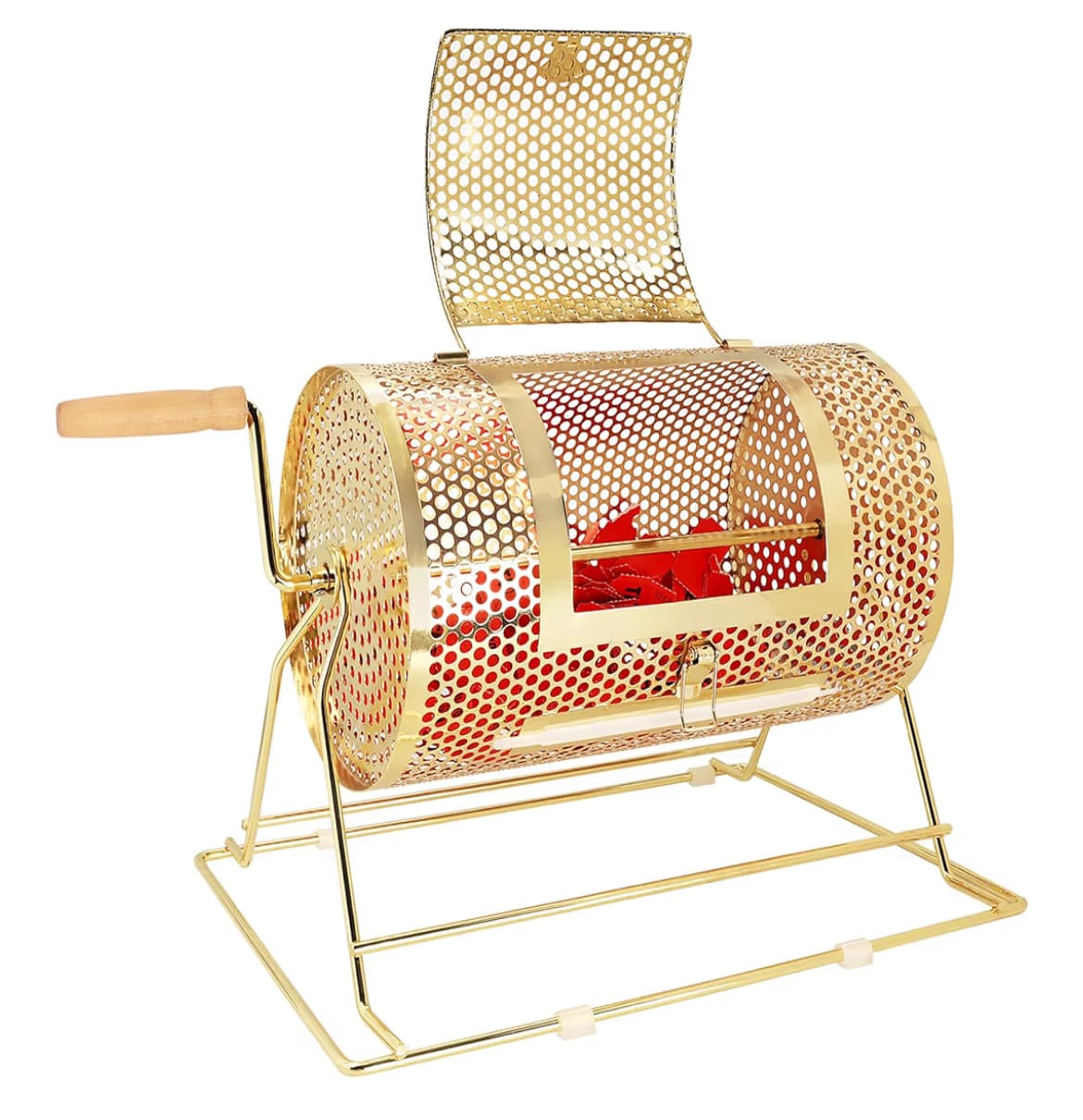

I wonder if one of these would work better for you?

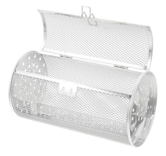

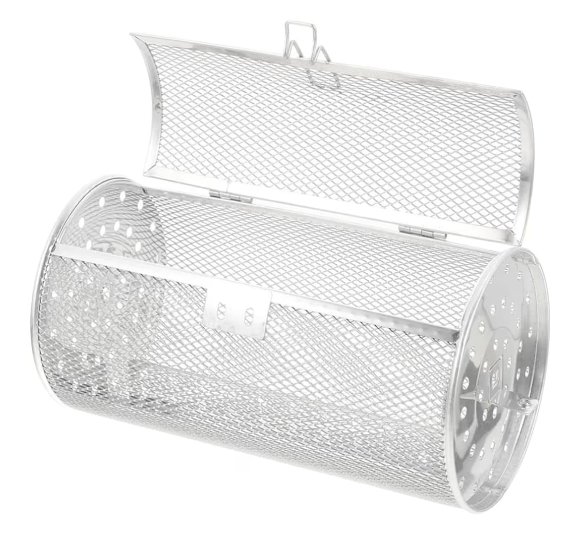

Or a rotisserie basket similar to this.
That 1st one is made of alloy steel & not sure how well that would handle the heat over time. I would prefer stainless. That 2nd style was mentioned earlier in the thread but seems a toaster oven I would use it in does not get hot enough to roast coffee.
