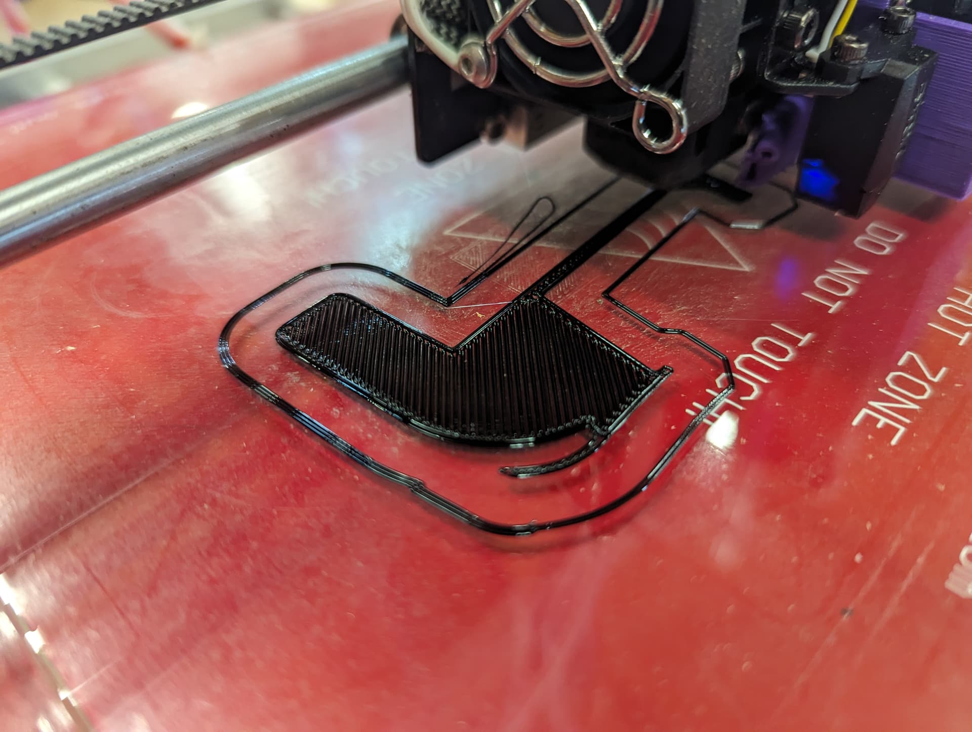

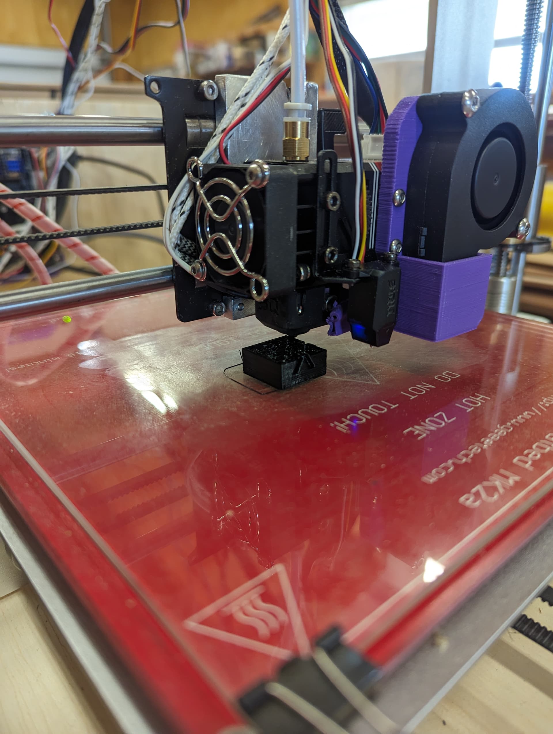

Printing Petg test cube. If this is successful, then I’ll print a Petg cooling fan.
Then I’ll either print a Petg core for the v4, or try printing Asa directly on this machine.
I’d rather print the Asa on the v4 as it has the enclosure, but this machine is all metal, so it might handle it better. I could do a caedb box enclosure.
Looks great so far!! Should have printed this cube…
https://www.printables.com/model/416565-v1-engineering-calibration-cube
I didn’t even know it existed till I was looking for something else yesterday lol
First layer height looks pretty good.

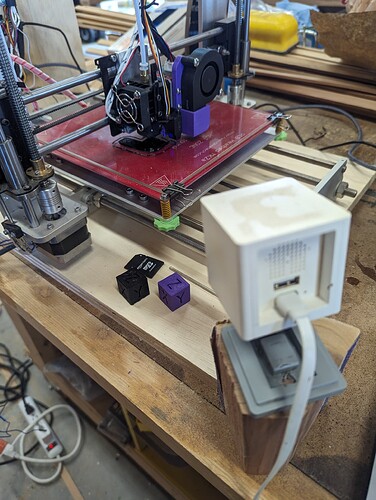

I need to get a webcam on this machine again so I can leave the shop while it runs.
Edit : forgot I have a wyze cam with a rtsp feed.
