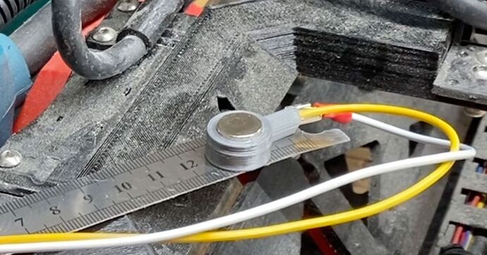

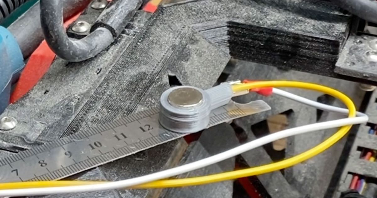

I’m currently remaking my touch plate probe wire, as per shown in the Printables listing and video below. My reason for remaking it, is the first time I made it wire that was too heavy gauge, and it did not matter then because on LR3 I was not routing it through wire management tunnels like on the LR4. So, now I need the wire to be closer to the recommended gauge.
Thinner wire: check.
Crimp on connector for stainless steel: check.
Crimp on Dupont connector to the Jackpot: check.
Disk magnets: check.
Super fast prints for parts: check.

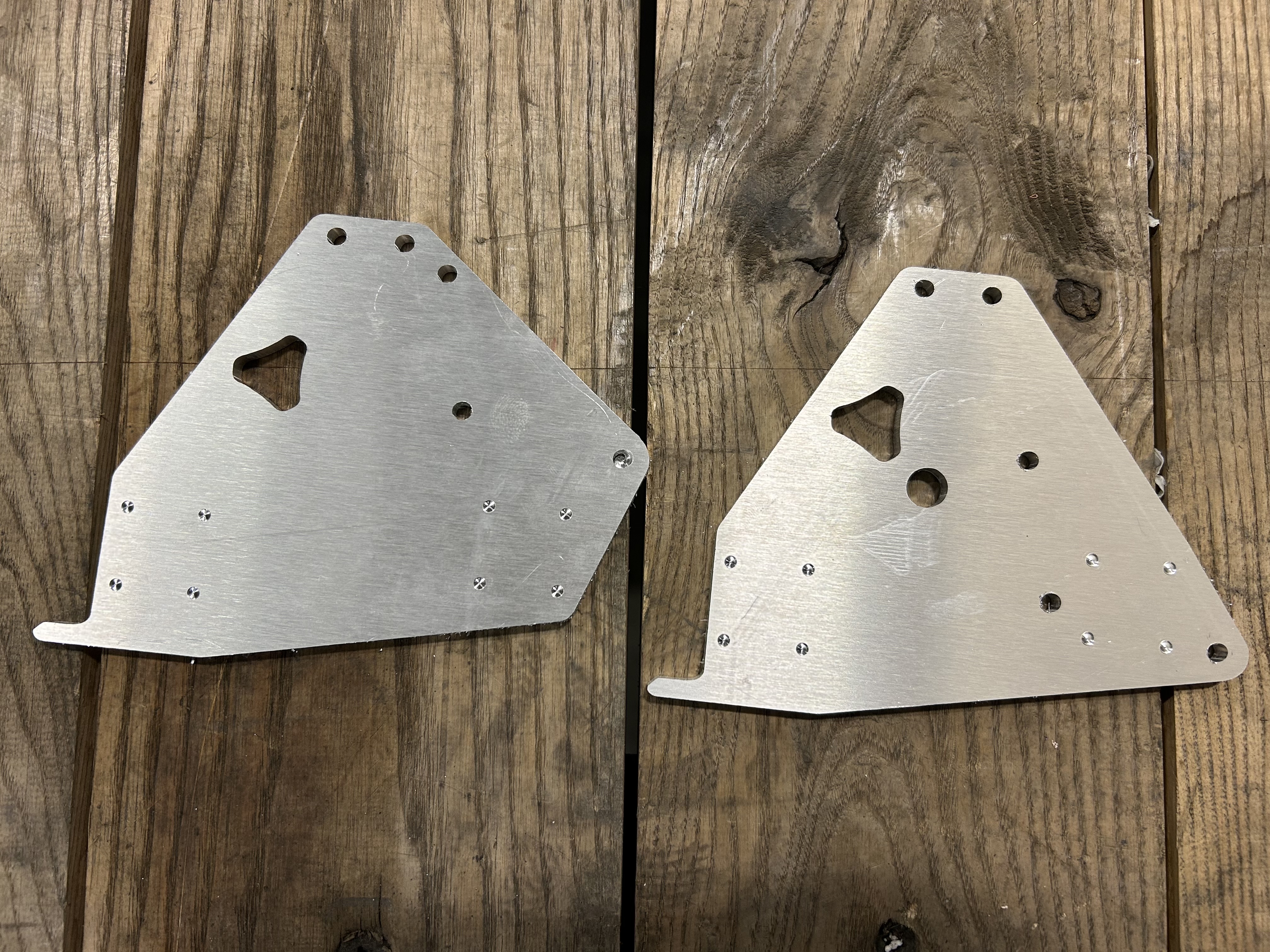

Thanks for your aluminum milling vid Doug! I was able to get these cut today using the speeds and feeds suggested in your video. Almost have all the printed parts done as well so it’ll be time to cannibalize the ol’ V3 before too long.
That is so cool that you were able to do that! I’m still so thoroughly impressed and pleased that both the LowRider 3 and LowRider 4 can do these kind of aluminum cuts. I just cut some more 1/4” thick aluminum today using my small RC3 LowRider 4 build.

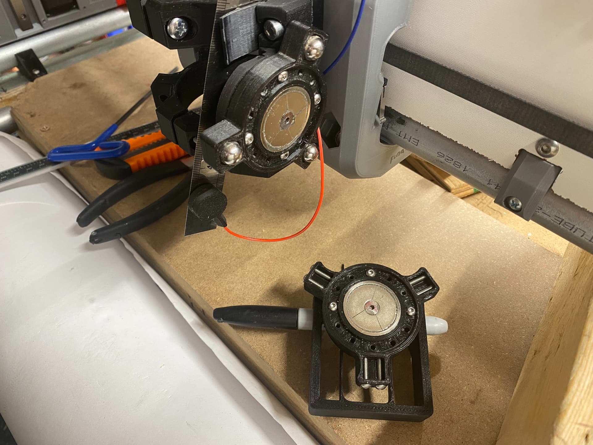

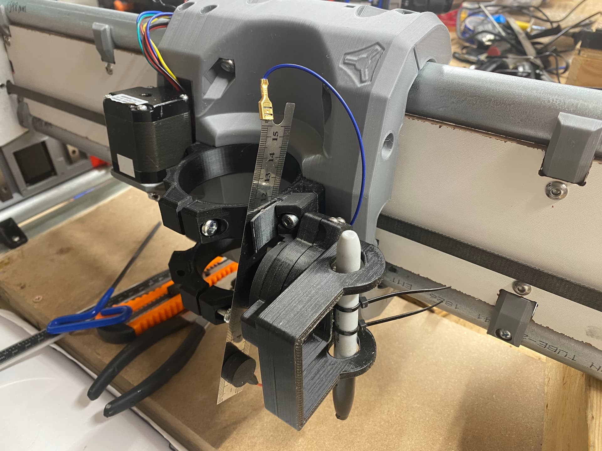

OK, @azab2c —
I got a new “Main Mount” designed, printed, and installed on my LowRider v4, that allows my Kinematic Accessory Tool holder from before, to be attached and used with LR4!
The following is copied and pasted from the Description:
This allows use of my earlier kinematic accessory tool mount on the awesome new LowRider v4 CNC.
Here’s an old-yet-helpful video I made about the earlier version (which was for LowRider v3):
This whole deal is an adaptation of a Maxwell Kinematic coupling. You can read about that here: Kinematic coupling - Wikipedia
Original motivation was a nudge from Jamie K on the V1 Engineering forum.
Speaking of which, Jamie has now remixed this in a way that requires no acorn nuts, no screws for troughs, only one magnet on one side, no need for drilling any magnets for additional countersinking, and no need for prying any magnets out for flipping them. Check out his remix here. His remix avoids acorn nuts and avoids troughs made from screws, all by having both “mounds” and “valleys” made from 3D printed plastic. Here’s a photo of Jamie’s remix:
What’s new?
The previous version was designed for LowRider v3. This new “Main Mount” enables use on LR4. Since the only part that needed modified was the “Part A, Main Mount,” only the new version of that part is provided here. For the other parts, you can download and use those from either…
… Jamie’s excellent remix that requires less hardware:
…or my earlier listing:
Also, this is backwards compatible, so if you already made a set for your LR3, you can use all of it except the main mount, on an LR4.
Caveat:
- Depending on the size and shape of whatever tool you attach, you should double check your range of X axis travel, as your tool’s shape may result in a reduction of X axis travel, in order to avoid a collision at the X max side.
Notes:
- I designed a narrow slot in this new “Main Mount” that is intended to allow a Tiny Touch Plate (from Ryan’s store) to be stored in the holder clip that he designed on the upper tool mount. If this prints well, and works, great. If not, then my own touch plate (which is wider than Ryan’s) does indeed store well in the upper mount clip, as it then “leans” its edge against the lower tool mount, out in front of it.
- I changed the previous targeted angle of the mounted “Fixed Base” part from this:
… to this new angle for LR4:
…which, when attached to the main mount, looks something like this:
…where the LR4 core would be just to the right of this side view. The reason for this change was to minimize the offset distance away from the gantry, in order to help strengthen the mount’s rigidity.
Speaking of which, this mount does seem more rigid than the previous version, owing in part (I think) to the fact that it’s attached at three points instead of two in the previous version. The three points of attachment to the existing LR4 core’s tool mounts are revealed in the simple directions for…

- Magnetically click a “Mobile Base” toolholder onto the “Fixed Base.”
- Done!

Doesn’t this cause a problem for all of the accessories? Especially for Jamie’s version?
Won’t the Laser mounts, pencil holders, etc all need to be redesigned so they aren’t turned away from the spoilboard?
Forgive me if I’m missing something, I haven’t actually used any of them, just the first thing I thought while reading this.
oh… is it because of the mount nuts can be used to attach differently? Is your offset aligned with the nut hole increment??
I don’t think so.
There is a full clock face of screw holes, so the intermediate part, the Mobile Base, could be rotated, without the tool holder itself being rotated.
Some things may need redesigned, but I think most will be OK.
yes. This!
The “cover” image of the listing, shows my previous pen holder attached for use. All I had to do was change which of the screw holes were used for attaching it.
yep, I see. Your holes still align on the vertical…so should be fine…

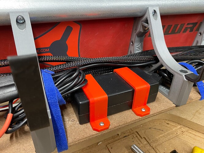

LowRider v4 CNC - Tie Downs to secure 24v Power Supply (AC-DC) to lower strut plate of gantry
This is the 24v power supply I purchased from Ryan at v1e.com …
Print as oriented.
No supported needed.
I pre-drilled and used M3 screws, but only because I did not have the right size of small, self-tapping wood screw.
