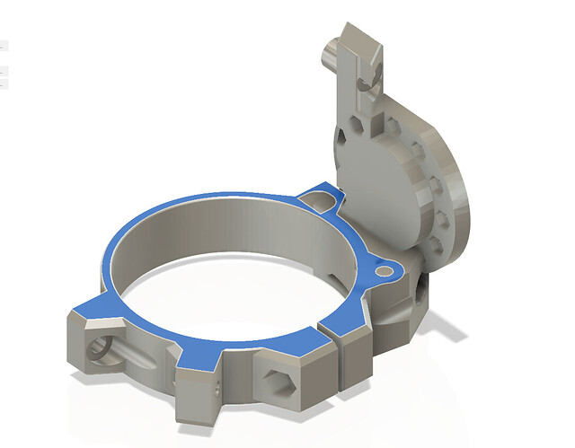

OK, as requested by @azab2c (and perhaps others, I cannot recall for sure) —
I got a new “Main Mount” designed, printed, and installed on my LowRider v4, that allows my Kinematic Accessory Tool holder from before, to be attached and used with LR4!
The following is copied and pasted from the Description:
This allows use of my earlier kinematic accessory tool mount on the awesome new LowRider v4 CNC.

The previous version was designed for LowRider v3. This new “Main Mount” enables use on LR4. Since the only part that needed modified was the “Part A, Main Mount,” only the new version of that part is provided here. For the other parts, you can download and use those from either…
… Jamie’s excellent remix that requires less hardware:
…or my earlier listing:
Also, this is backwards compatible, so if you already made a set for your LR3, you can use all of it except the main mount, on an LR4.

  • Two versions this new “Main Mount” are now offered here in this listing:
    • On one, I designed a narrow slot that is intended to allow a Tiny Touch Plate (from Ryan’s store) to be stored in the holder clip that he designed on the upper tool mount. If this prints well, and works, great. If not, then my own touch plate (which is wider than Ryan’s) does indeed store well in the upper mount clip, as it then “leans” its edge against the lower tool mount, out in front of it.
    • That said, a version without that slot is also offered, and is probably easier to print. This second version is courtesy of fellow V1 maker Aza ( @AzaB2C — on V1 forum here, and on Printables here ). Kudos and thanks, Aza!
  • I changed the previous targeted angle of the mounted “Fixed Base” part from this:
… to this new angle for LR4:
…which, when attached to the main mount, looks something like this:
…where the LR4 core would be just to the right of this side view. The reason for this change was to minimize the offset distance away from the gantry, in order to help strengthen the mount’s rigidity.
Speaking of which, this mount does seem more rigid than the previous version, owing in part (I think) to the fact that it’s attached at three points instead of two in the previous version. The three points of attachment to the existing LR4 core’s tool mounts are revealed in the simple directions for…
Assembly and Installation
  • Print all parts and install all magnets / washers as desired. See links below.
  • Using M3 x 16mm screws and M3 nuts, attach your desired tool holder(s) to one or more “Mobile Base” part(s). There are capture slots for the nuts.
  • Using M3 x 16mm screws and M3 nuts, attach the “Fixed Base” part to the “Main Mount.” There are capture slots for the nuts.
  • To install the combined assembly of Fixed Base and Main Mount to the LR4 core:
    • On the top and bottom tool mounts, on the right side of each, remove the two M5 x 30 mm screws,
    • Place the “Main Mount” part in position. (Mine snapped in with an audible click.)
    • Replace the two original screws with M5 x 45 mm screws. (That makes two of the three points of attachment.)
    • Install an M5 x 30 mm screw vertically down through the spare auxiliary mount hole on right side of the bottom tool mount. Use an M5 nut on the underside. There is no capture slot for this. (That makes the third point of attachment.)
  • Magnetically click a “Mobile Base” toolholder onto the “Fixed Base.”
  • Done!

Made small edit to close the probe slot so I can avoid needing support, and help add a bit more material to that area. Thinking my V1E probe is small enough to fit in the top router mount so this bottom section can be blocked off.

Awesome, thank you! If you get a chance to post that as a remix that would be great. Or I could offer it. I seriously considered not having the slot. The normal position of the Tiny Touch Plate and the space that this mod seems to need to occupy, really do collide a bit, and supporting the touch plate with the slot made it a rather challenging print.
I ran the model through the “solid checker” in my modeling program, which can miss things, and if I remember right, when I first opened it in OrcaSlicer it said not manifold, but OrcaSlicer has a Windows only feature to repair, and I did, and it seemed fine. So, I’m not sure what’s going on here with Cura.
