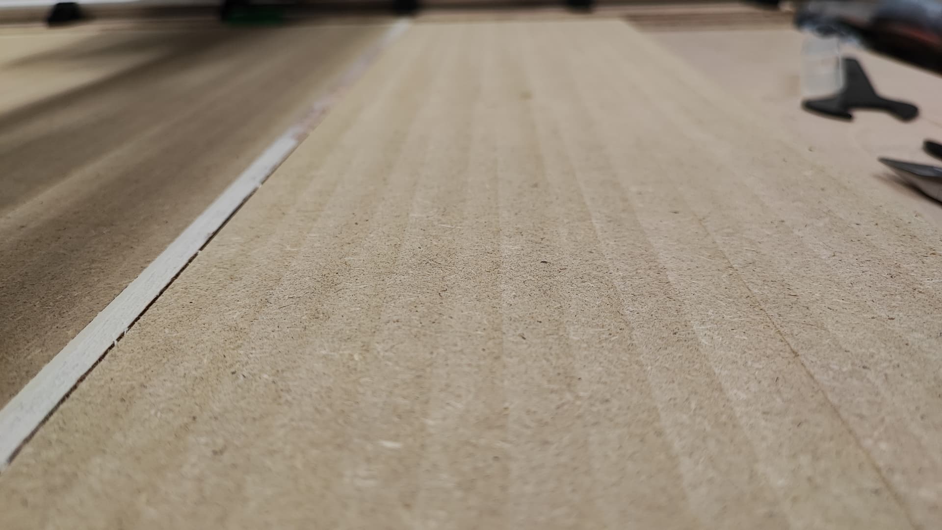

I printed some shims, 0.4 and 0.3mm. 0.4 makes the grooves nearly non-existent.
Before on the left, now on the right. Can live with the very small groves, I guess.
Edit after planing the whole board: need to shim a bit more. :sweat_smile:
I just checked mine. A couple layers of blue masking tape, 0.45mm. I have it slightly on the non stepper side and I was pretty perfect with the sweep of my printed tool.
It looks definitely better now on 80% of the surface (is it normal that you still see the “lines” even though you can’t barely feel anything?):
Funnily enough, at the very left side something must be a bit crooked because you can see the “waves” a lot better and there is a little bump between them when touching it. Just a tiny one, but still. Very weird.

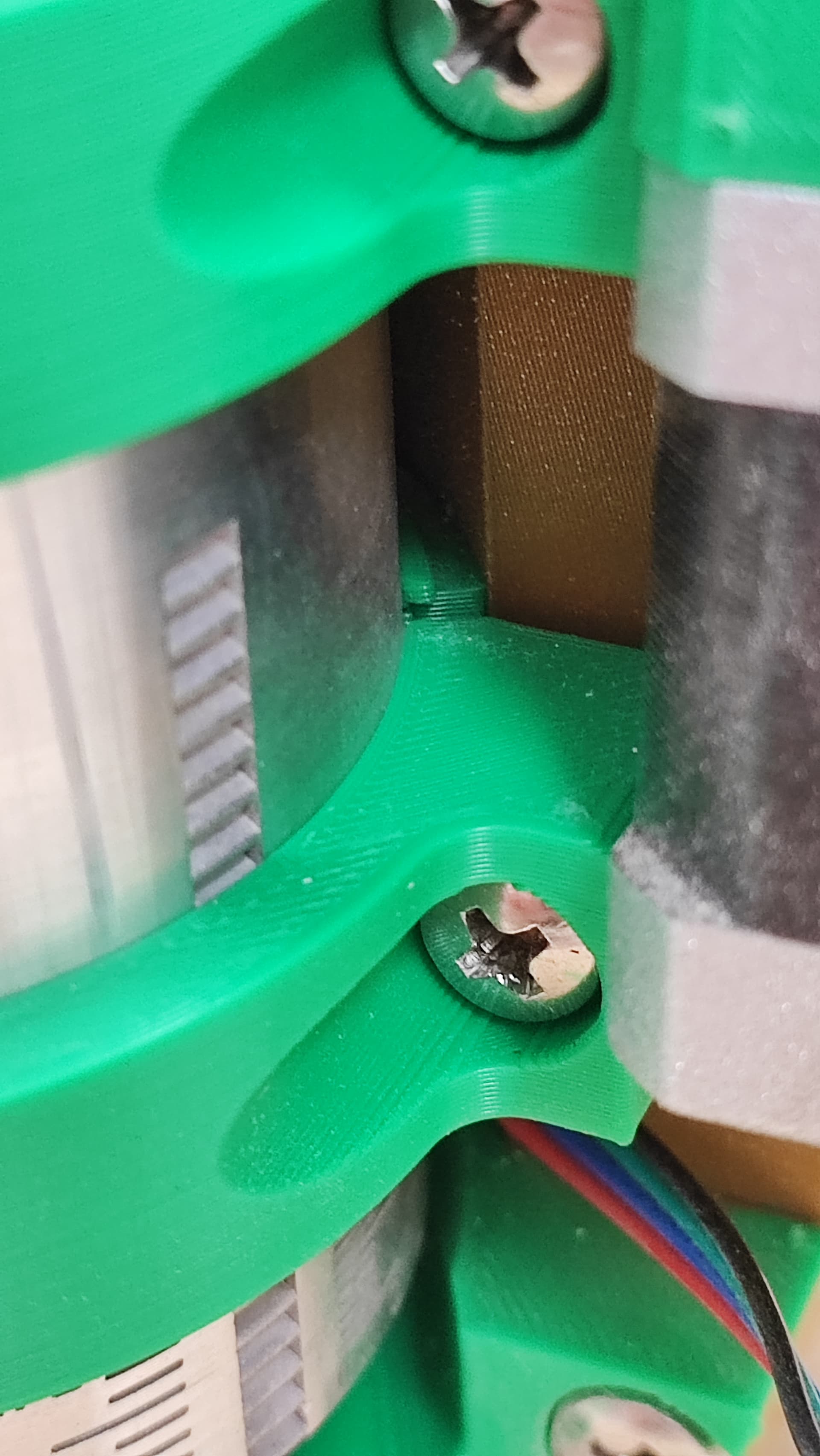

Any chance the top core bearings can be too loose?
I am still searching for the reason the lower bearings either don’t make contact or, as it is now, are rubbing against the braces. I must have done some crucial thing wrong, but I just don’t know what…
Edit: I found the crucial thing: I had seated the core bolts too lightly (same problem I had with the Primo), especially the other two at the bottom of the core, making it impossible to tighten it without the core touching the braces. The bolts are now looking out of the nut by around 4mm, before bolt and nut were flush. After having done that, tightening the two bolts that should actually tighten the core worked as intended. All bearings are touching the rail, none are brushing the braces. :tada: Big oof, hard fight.

I was also having troubles with my core assembly and found that I hadn’t really seated the bearings firmly against the core surface. after that, I was able to get the core clamps to tighten enough to get the bearings all touching.
