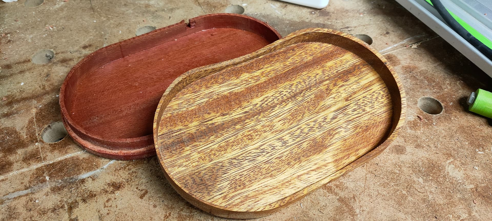

Yelllow (Satinwood - hardest wood I’ve ever machine and smells soooo good):
Purple (Purple Heart):
All the colours (Purple Heart (Africa), Pear (Gerrmany), Satinwood (East India), Red Heart(Mexico)):
Test fit (the holes were nearly a mm too small despite a finishing pass first. The CNC and I gotta talk… board is Cherry (Germany)):
This purple Heart is gorgeous!
Had some major flex when planing the board with a 6mm 2-flute, 24k RPM, 6mm DOC, 75% stepover and 3000mm/min… Like, wow. I found the LowRider’s limits. Especially the red heart and the satinwood really derailed it.
Slowed it down a tad, cut the holes:
Still needs the brim, holes for magnets and lid.

Actually not. At 3k it made some nice chips, but it shows the limits of the LR flex-wise. :stuck_out_tongue: I slowed it down later to 1500mm/min - with 24k it just produces sawdust, down to 12k it’s working fine with 3mm DOC.
Where were you noticing the issue? If someone to be working on a new machine, seeing where the flex showed up for you could be helpful.
Z, X, Y?
You can see the core on Y (and a little bit X) move 1-2mm, the whole gantry twists with those forces. The core is tight. It’s nothing you can’t see. :smiley:
