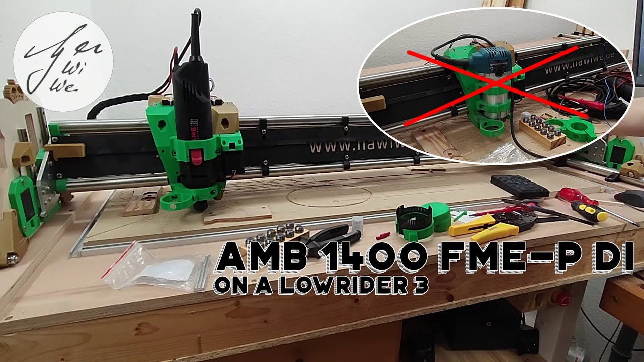

Model for the mount now published on Printables: Printables
Not super interesting, but since you are all big nerds it might interest you. :stuck_out_tongue:
Interesting, I didn’t expect it to be encased.
I do not understand what you mean, sorry. :stuck_out_tongue:
I was expecting a spindle to look more metal and less plastic
Where did you get the cable chain?
Oh, that. It’s kind of a hybrid thingy somehow. You can’t use that version with the digital input outside of a CNC and all the others look exactly the same and don’t have any other hardware, so they are only build for that. So they either directly replace a Makita (but being more powerful) or in my case they replace the Makita with the advantages of a digitally controlled spindle but without the need of having a frequency inverter.
It’s printed. I really like it, but taking the tiny bits out gets a tad annoying. :smiley: But you only do it so often…
You can find it here: AR cable chain link opened by arek_r1 - Thingiverse There are also different sizes, the one on the side is a bit bigger, the one on the X is too small now for the touchplate cable, I attached it on the outside now. :stuck_out_tongue:
Awesome. Can’t wait to see what you build with it… As well as how fast you will go :rofl:
die Autoban Geschwindigkeiten von CNC (I do not think I said that right… Only got to German II :flushed:)
It was pretty close. :slight_smile:
